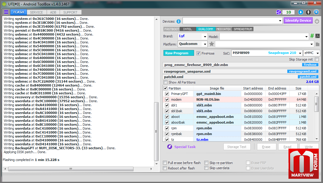

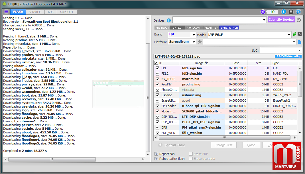

Lyf 21S Flshing With Ufi Andriod Tool

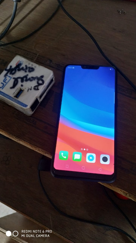

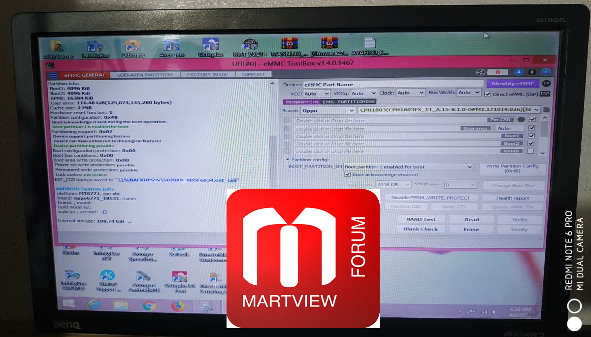

oppo china version a7x (PBCM00) userdata reset done
Connection status: EHCI:HUB:HUB:USB 2.00 High-Speed
Interface: UFI High-Speed
Serial number: 0011-8840-4224
Boot version: 1.04, FW version: 1.12 (Jun 7 2018 00:06:47)
Insertion test... Done.
Init bus...
VCC: 3.3 V, VCCQ: 2.8 V
Bus: 1 bit (SDR 52MHz)
Access mode: sector mode
Manufacturer ID: 0x13 (Micron)
Product name: S0J9K9 (0x53304a394b39), rev: 0x10, serial number: 0x0771704D
Manufacturing date: Sep 2018
CID: 13014E53 304A394B 39100771 704D9500
CSD: D05F0132 8F5913FF FFFFFFEF 964000A8
EXT_CSD revision: 1.8 (MMC v5.1)
Partition info:
Boot1: 4096 KiB
Boot2: 4096 KiB
RPMB: 16384 KiB
User area: 116.48 GiB(125,074,145,280 bytes)
Cache size: 2 MiB
Hardware reset function: 1
Partition configuration: 0x48
Boot acknowledge is sent during the boot operation
Boot partition 1 is enabled for boot
Partitioning support: 0x07
Device support partitioning feature
Device can have enhanced technological features
Device partitioning possible
Boot configuration protection: 0x00
Boot bus conditions: 0x02
Bus width: x8 (sdr/ddr), boot mode: sdr(default), reset bus width to x1 sdr(default)
Boot area write protection: 0x00
Power-on write protection: possible
Permanent write protection: possible
Lock status: not locked
EXT_CSD backup saved to "\\%BACKUPS%\S0J9K9_0771704D.ext_csd"
ANDROID System Info:
platform: MT6771, cpu abi: arm64-v8a
manufacturer: OPPO
board: oppo6771_18011, name: PBCM00
brand: OPPO, model: PBCM00 (OPPO A7x)
build model list: PBBM00 (OPPO A7x)
build id: O11019, version: 8.1.0 Oreo (PBCM00_11_A.08_181101)
build description: full_oppo6771_18011-user 8.1.0 O11019 1541057913 release-keys
crypto state: encrypted?
Init bus...
VCC: 3.3 V, VCCQ: 1.8 V
Bus: 1 bit (SDR 4MHz)
Partition info:
Boot1: 4096 KiB
Boot2: 4096 KiB
RPMB: 16384 KiB
Factory Reset...
Creating filesystem with parameters:
Block size: 4096
Blocks per group: 32768
Inodes per group: 6912
Inode size: 256
Journal blocks: 1728
Label:
Blocks: 110592
Block groups: 4
Reserved block group size: 31
Created filesystem with 13/27648 inodes and 3568/110592 blocks
Writing cache... Done.
Block size: 4096
Inodes per group: 8192
Inode size: 256
Journal blocks: 32768
Label:
Blocks: 28880123
Block groups: 882
Reserved block group size: 1024
Created filesystem with 11/7225344 inodes and 501599/28880123 blocks
Writing userdata... Done.
Done.
