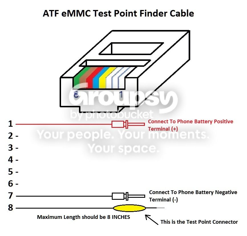

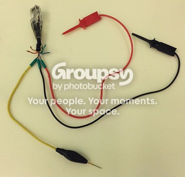

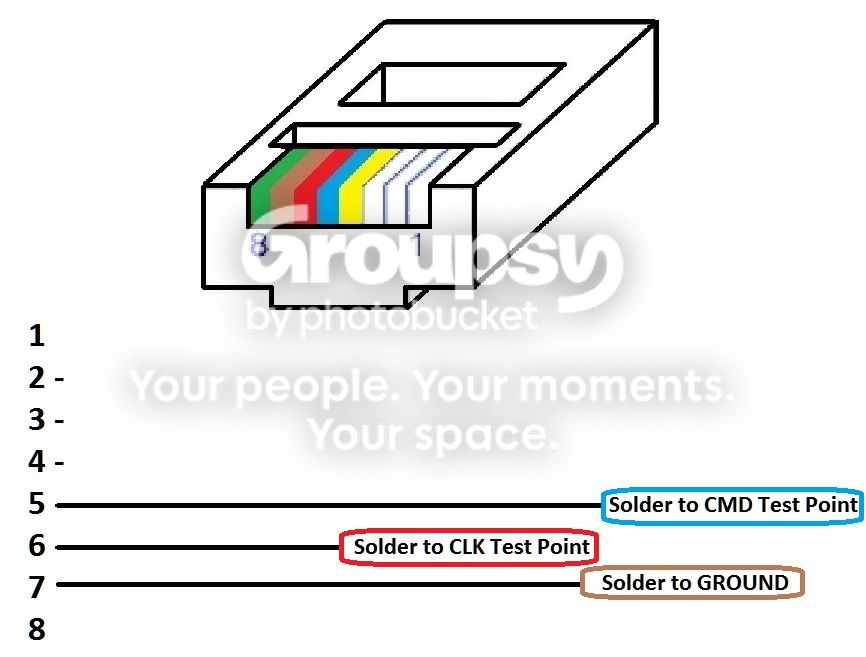

STEP 1: How to make TP Cable for eMMC PIN Finder
Very Simple TP Cable Schematics
(Supports Qualcomm, Exynos, Marvell, Broadcom, and Spreadtrum* based Phones)
* ATF Nitro and Lightning Boxes need additional Adapter for Spreadtrum Based Phones...
Sample of Home Made Cable
TP Cable for ATF Nitro / Lightning for Spreadtrum Based Phones
Sample of Spreadtrum TP Finder Cable for ATF Nitro and Lightning

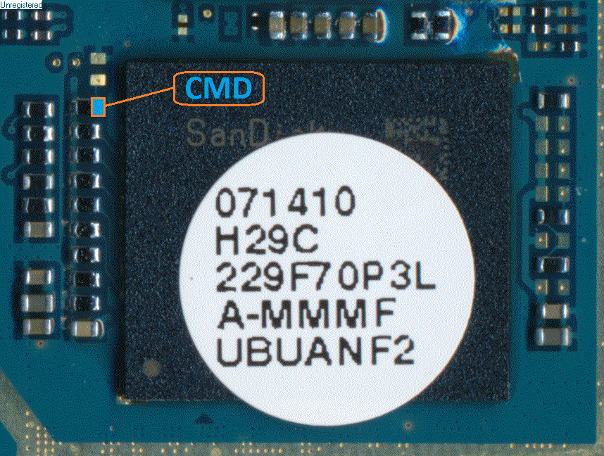

STEP 2: How to find CLK and CMD
Please Take Note of the Following Items before Attempting to Find CLK and CMD:
  1. Make sure you connect Positive (+) and Negative (-) Terminals Properly and Correctly.
  2. Make sure POWER BUTTON is ALWAYS PRESSED
  3. DO NOT Connect USB Cable to Phone
  4. Allow at least 2 Tries per possible Location on the PCB
  5. DO NOT Exert Too Much Force on the Resistors as they may COME OFF!!!
  6. Not all Phones have exposed CLK or CMD Locations on the PCB.
  7. Not all Phones are supported with this NEW TP FINDER Method. ATF Team will continue to improve it via UPDATES.

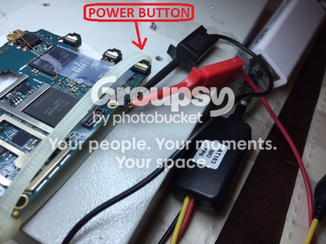

STEP 1: Connect Power Positive (+) and Negative (-) to the Phone's Battery Terminal
STEP 2: Make Sure Power Button is Always Pressed. Use Rubber Band or Tie Cables.

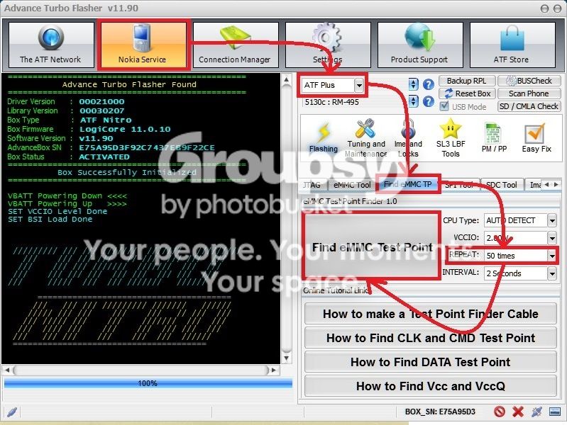

STEP 3: Setup ATF Software settings such as REPEAT and INTERVAL for your convenience
REPEAT <--- Number of Times TP Finder will Loop Itself Automatically
INTERVAL <--- Delay in Seconds before the next TP Finder Operation will Start

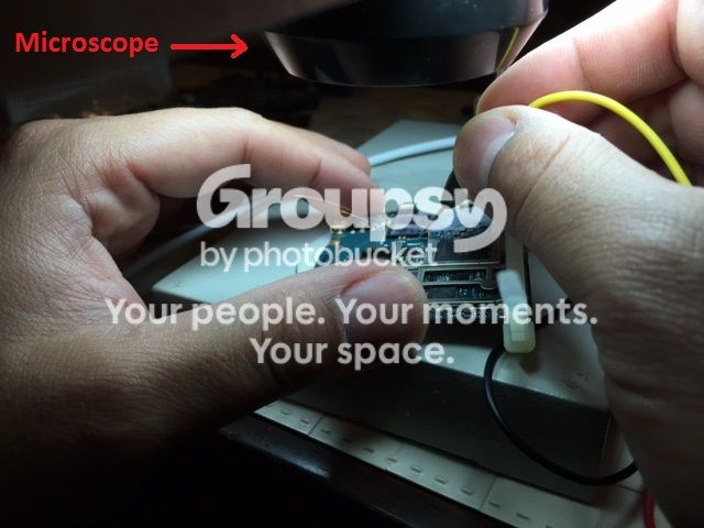

STEP 4: Start Connecting Test Point PIN to Resistors/TP Pads on the Phone's PCB around the eMMC Area.
Wait for Message "Please Check Another Location..." before trying other TP Locations
On ATF BIG Chrome Box, change TP Location when GREEN LED will Power OFF
On ATF Nitro/Lightning Box, change TP Location when BLUE LED will Power OFF
In this Example, tried all the Locations that were marked with RED
DO NOT TRY TO TP a CAPACITOR, it is NEVER CORRECT for CLK and CMD
Capacitors are BROWN in COLOR
Resistors are BLACK in COLOR
ONLY TRY TO TP Resistors and Test Point Pads around eMMC Area

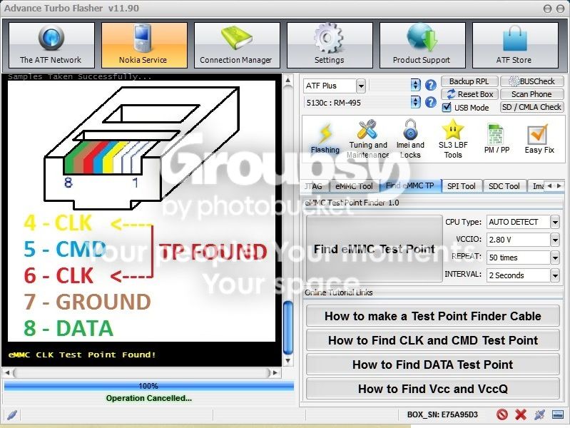

When a correct Test Point is Found, you will see similar Message Below.
The message also shows you the PINOUT of ATF RJ-45 Socket for the proper connection of the Test Point Found.

STEP 3: How to find VccQ
Please Take Note of the Following Items before Attempting to Find VccQ:
1. You must FIND CMD Pinout First using STEP 2 Above
When you Find the CMD Pinout, the VccQ is ALWAYS on the other side of the CMD Resistor Test Point.

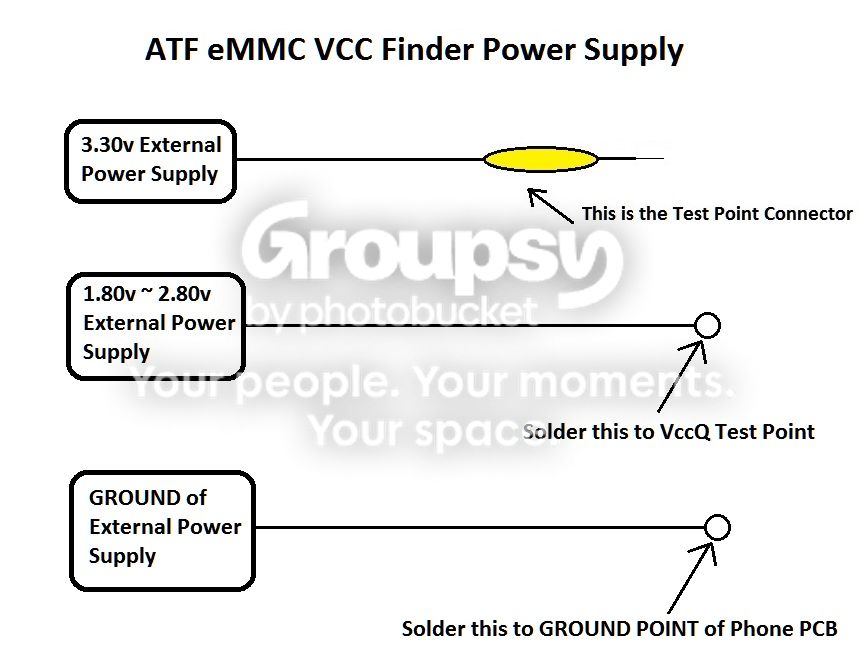

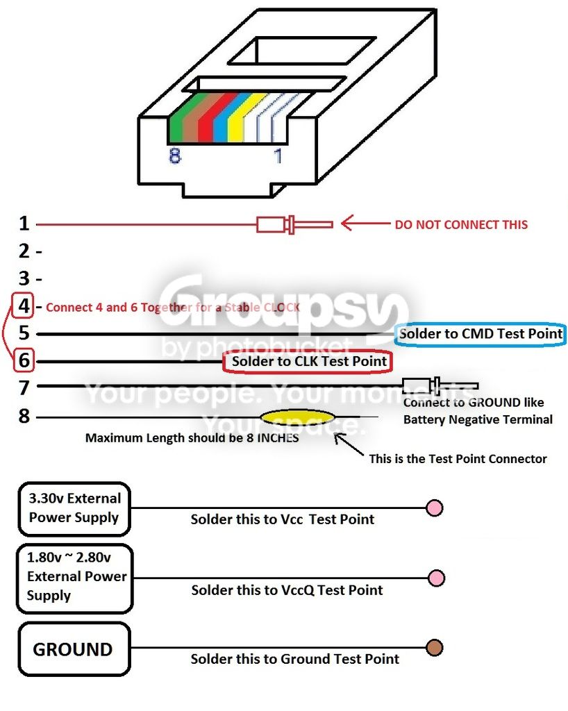

DO NOT USE TP CABLE FROM STEP 1 for finding VCC.
Finding VCC Requires another TP Cable which you can make using your current
External Power Adapter for eMMC.
You need to Prepare your External Power Adapter with a TEST POINT PIN on 3.30v Like This:
1. Solder CLK Test Point Found from STEP 2 into the Phone PCB
  1. Solder CMD Test Point Found from STEP 2 into the Phone PCB
  2. Solder VccQ External Power 1.80v~2.80v from STEP 3 into the Phone PCB
  3. Solder GROUND Connection from ATF RJ-45 to the Phone PCB.
  4. Solder GROUND Connection from External Power Adapter to the Phone PCB.

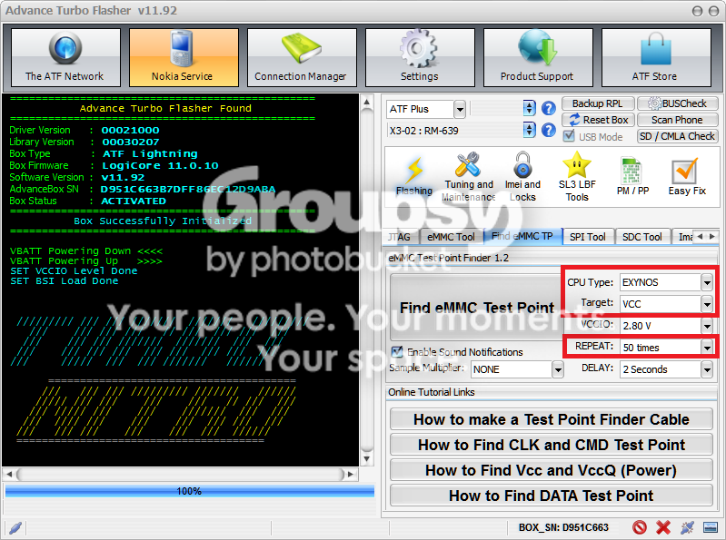

On ATF Software, Make the necessary Settings for eMMC Finder Loop:
In this example, I tried all the Locations that were marked with RED
DO NOT TRY TO TP a RESISTOR, it is NEVER CORRECT for VCC
ONLY TRY TO TP Capacitors
When you have connected the testpoint cable to the correct Vcc Test Point, the ATF Software will announce to you
that the VCC Pinout has been located.

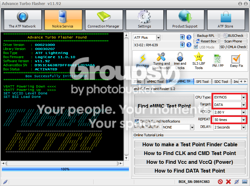

Now Setup ATF eMMC Pin Finder Module for Finding DATA Test Point:
DO NOT TRY TO TP a CAPACITOR, it is NEVER CORRECT for DATA

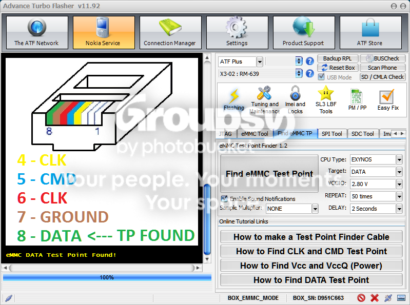

When the Correct DATA Test Point is Found, ATF Software will show a similar message:
Congratulations, you now have ALL eMMC Test Point Programming PINOUTS!!!
