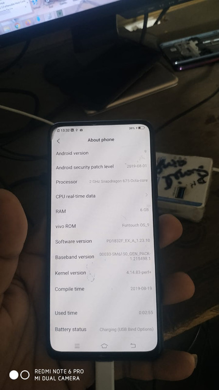

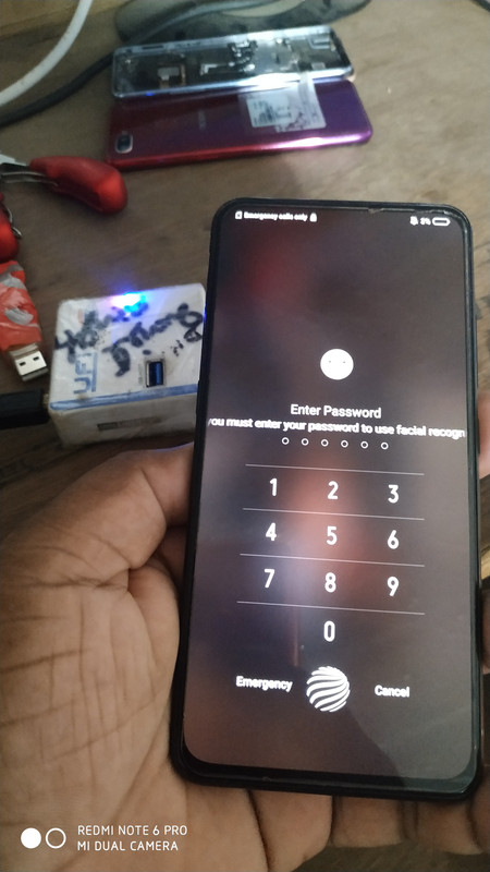

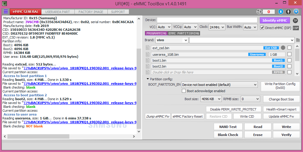

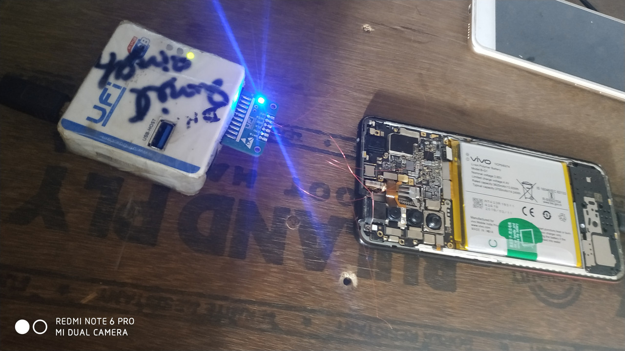

VIVO V15 PRO ( VIVO-1818 ) PD1832F_EX_A_1.23.10___ ANDROID Version : 9 Pie __ RAM - 6GB __Remove Userlocks+Frp
Lock
Done Without Any Risk Of Stuck On Logo All Job Successfully Done Ufi-Box Dr.Research-Center-Team

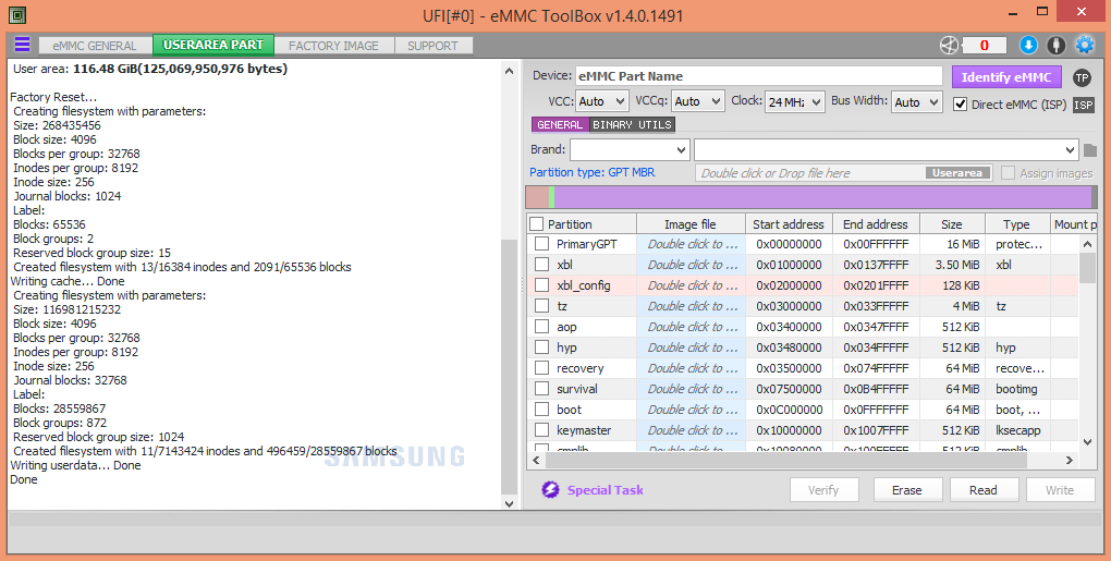

IDENTFY EMMC ERROR
:Y::Y: IDENTFY EMMC INFORMATION:G::G:
Factory Reset Done
Clear FRP Lock Done (Google Account)
DUMP

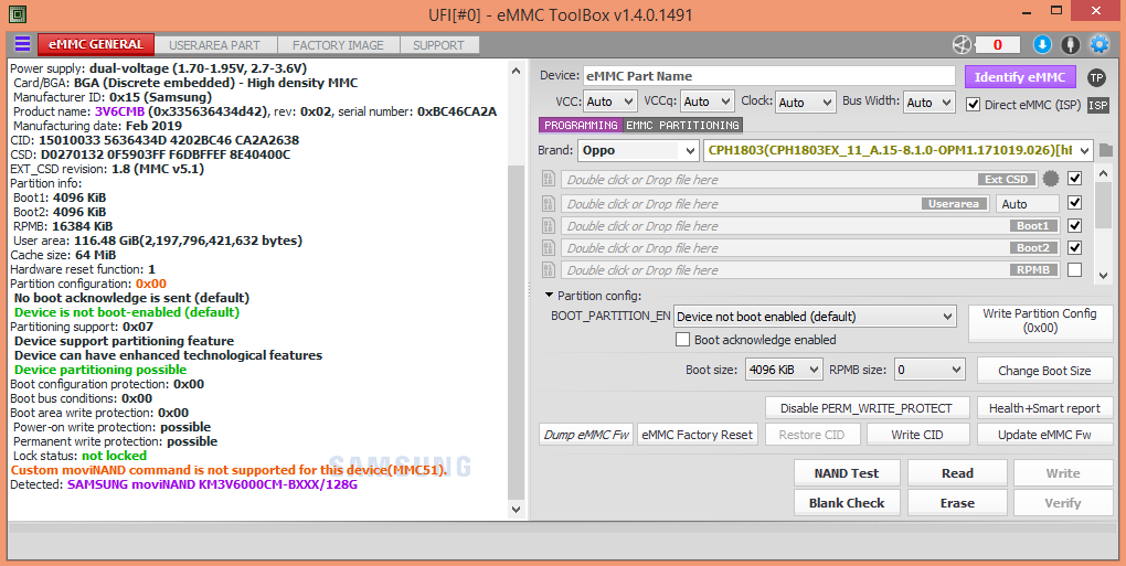

GSMserver
Sep 10, 2018
13
gsmserver_support
Hello!
User reported that same chip is detected in previous software version , but is not detected on latest Screenshot.
What it could be?

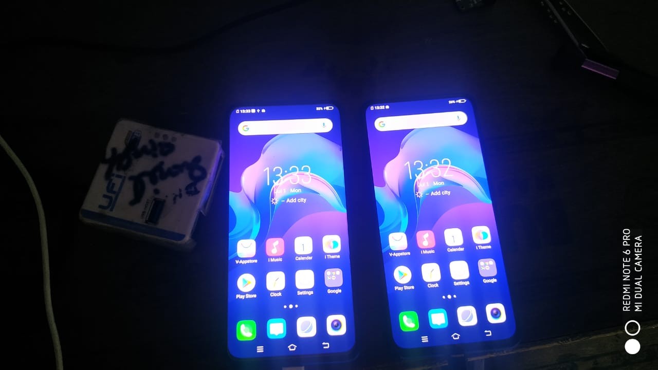

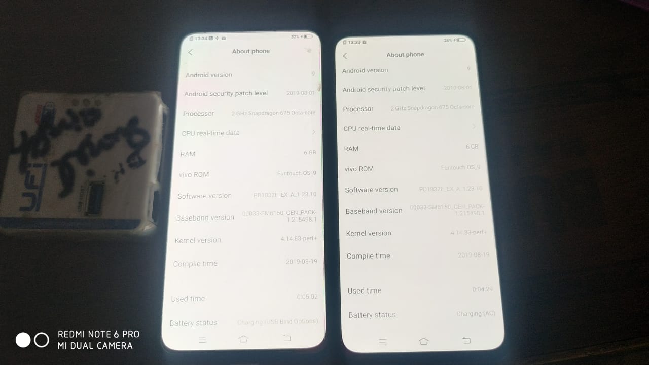

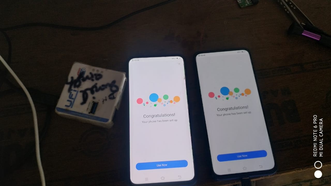

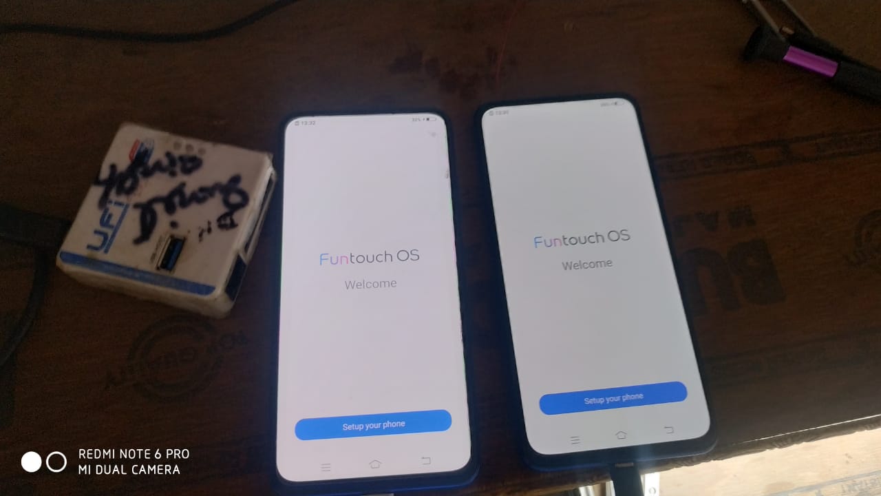

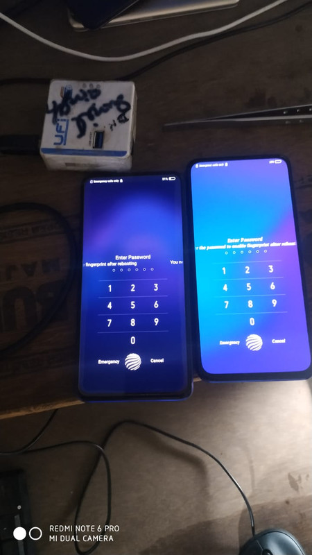

Lock Done Without Any Risk Of Stuck On Logo All Job Successfully Done Ufi-Box Dr.Research-Center-Team
2 piss Userlocks+Frp
1 piss Dead
Userlocks+Frp

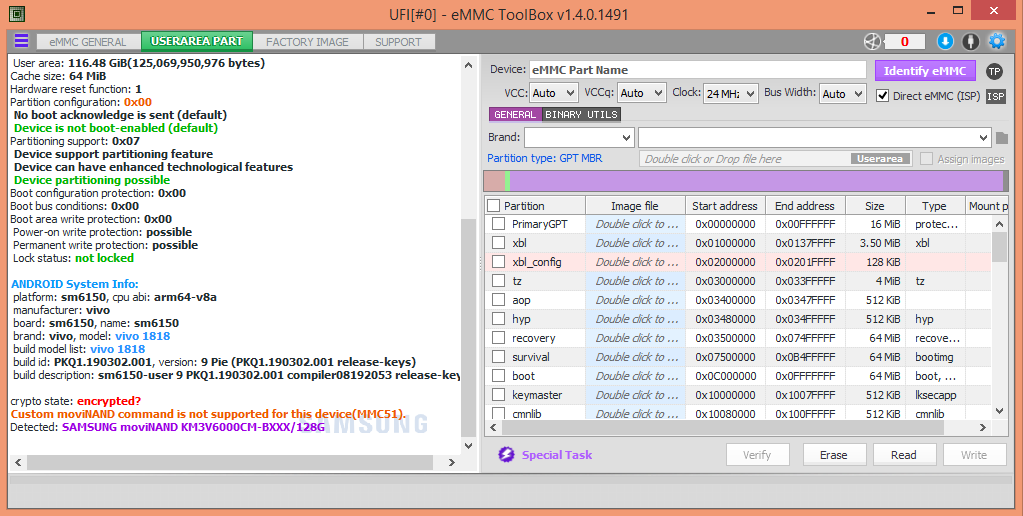

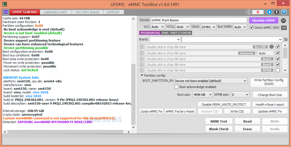

Connection status: XHCI:HUB3:USB 2.00 High-Speed
Interface: UFI High-Speed
Serial number: 0011-8840-0627
Boot version: 1.04, FW version: 1.13 (Aug 19 2019 23:46:09)
Insertion test... Done
Init bus...
VCC: 3.3 V, VCCQ: 1.8 V
Bus: 1 bit (SDR 24MHz)
Access mode: sector mode
Product name: 3V6CMB (0x335636434d42), rev: 0x02, serial number: 0xBC46CA2A
Manufacturing date: Feb 2019
CID: 15010033 5636434D 4202BC46 CA2A2638
CSD: D0270132 0F5903FF F6DBFFEF 8E40400C
EXT_CSD revision: 1.8 (MMC v5.1)
Partition info:
Boot1: 4096 KiB
Boot2: 4096 KiB
RPMB: 16384 KiB
User area: 116.48 GiB(125,069,950,976 bytes)
Cache size: 64 MiB
Hardware reset function: 1
Partition configuration: 0x00
No boot acknowledge is sent (default)
Device is not boot-enabled (default)
Partitioning support: 0x07
Device support partitioning feature
Device can have enhanced technological features
Device partitioning possible
Boot configuration protection: 0x00
Boot bus conditions: 0x00
Boot area write protection: 0x00
Power-on write protection: possible
Permanent write protection: possible
Lock status: not locked
ANDROID System Info:
platform: sm6150, cpu abi: arm64-v8a
manufacturer: vivo
board: sm6150, name: sm6150
brand: vivo, model: vivo 1818
build model list: vivo 1818
build id: PKQ1.190302.001, version: 9 Pie (PKQ1.190302.001 release-keys)
build description: sm6150-user 9 PKQ1.190302.001 compiler08192053 release-keys
Internal storage: 108.95 GiB
crypto state: unencrypted
Custom moviNAND command is not supported for this device(MMC51).
Detected: SAMSUNG moviNAND KM3V6000CM-BXXX/128G

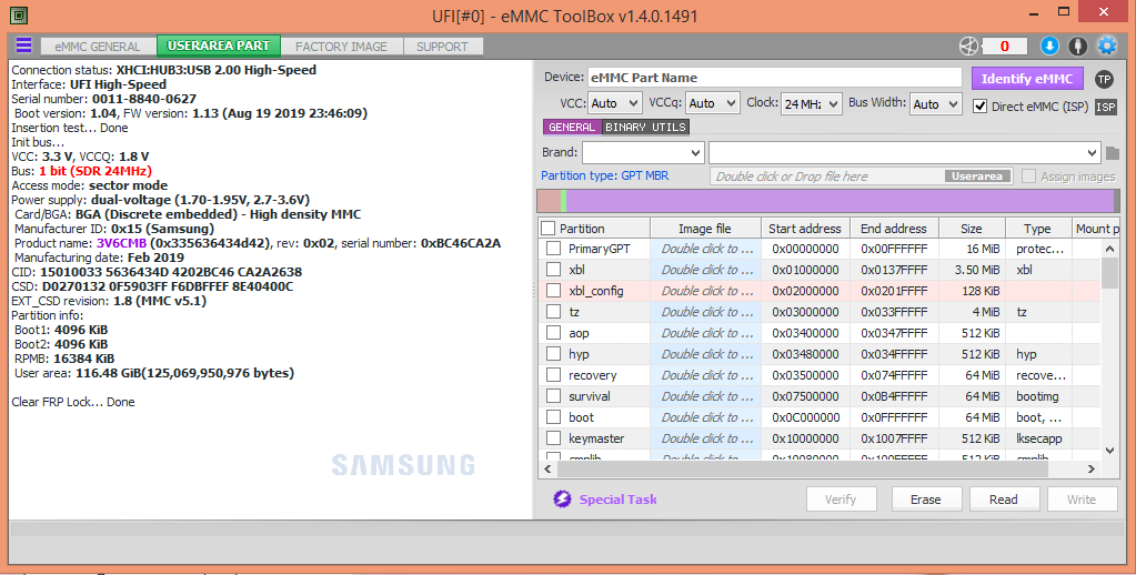

Init bus...
Partition info:
Boot1: 4096 KiB
Boot2: 4096 KiB
RPMB: 16384 KiB
Factory Reset...
Creating filesystem with parameters:
Block size: 4096
Blocks per group: 32768
Inodes per group: 8192
Inode size: 256
Journal blocks: 1024
Label:
Blocks: 65536
Block groups: 2
Reserved block group size: 15
Created filesystem with 13/16384 inodes and 2091/65536 blocks
Writing cache... Done
Block size: 4096
Inode size: 256
Journal blocks: 32768
Label:
Blocks: 28559867
Block groups: 872
Reserved block group size: 1024
Created filesystem with 11/7143424 inodes and 496459/28559867 blocks
Writing userdata... Done
Done
