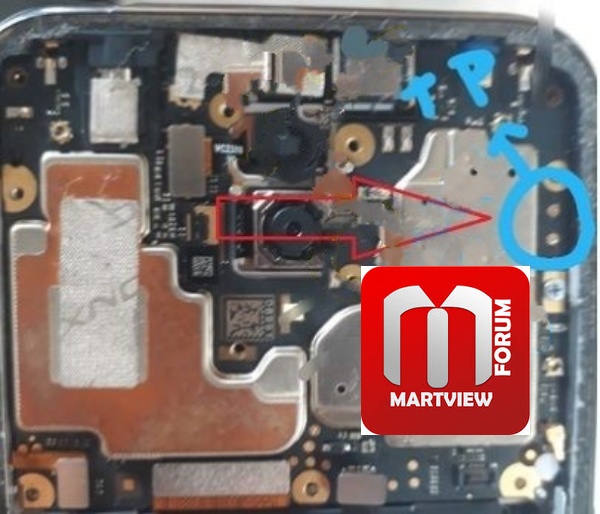

Nokia 4.2 Run on Android 9.0 & it is Powered by QCOM Snapdragon 439 Processor. it is a Dual SIM (GSM) Smartphone that Support Nano-SIM Cards. Connectivity options include, Bluetooth,, USB OTG, FM, 3G & 4G. The device Come with 2/3GB of RAM and 16/32GB of Storage can be expandable via SD card.
  • Install QD Loader Driver on PC
  • Remove back Cover of Phone
  • Find out The Pinout as Show In Image
  • Connect Phone to PC with usb Cable
  • take a Coper Wire and Short that Pinout
