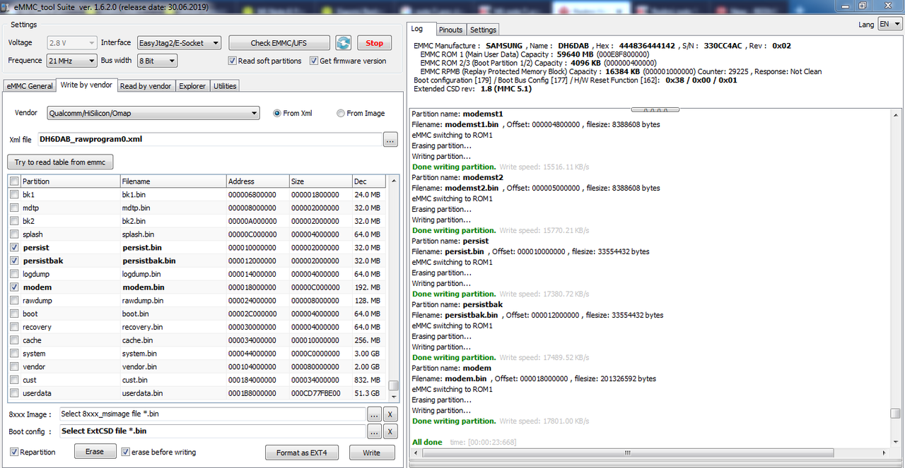

MI Note 6 Pro Dead Fixed with Easy-Jtag
mdShareef
Sep 15, 2019
2
1
MI Note 6 Pro Dead after flashing wrong file
First Flashed with Qc Fire But still same

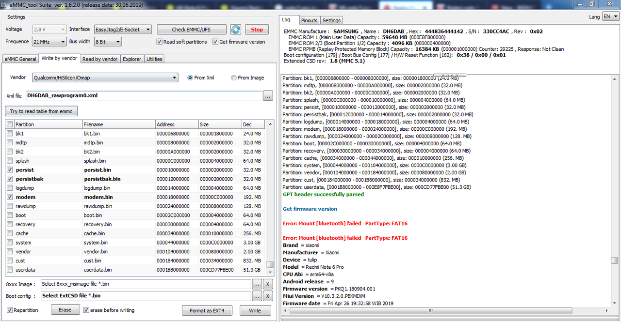

Removed EMCP and Pogrammed with EasyJtag Job Done
READ INFO
Writing Backuped Security
READ INFO
Please share dump
