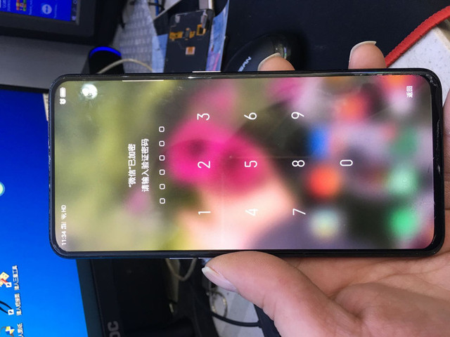

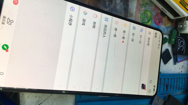

EMT-OPPO RENO (PCAM00, 9.0) Reset Privacy lock without losing data (Disable Privacy lock)
Case: OPPO RENO (PCAM00, 9.0) Privacy Lock (APP Lock)
Demand: Reset Privacy Lock without losing data
Operation process:
1.Enable USB Debugging, connect USB Cable (install drivers)
2.Press "Disable Privacy Lock (ADB)"
3.Waiting for the operation to complete
