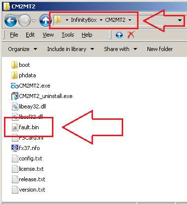

Hello,
1. Read NOTE - Infinity-Box - Downloads & Support
2. Uninstall/disable Eltima/Flexihub and other usb sharing tools and do not use it at the same time with Infinity software.
3. Update dongle with Infinity DongleManager.exe
4. Delete fault.bin file (if you have it in CM2 folder)
5. Run Infinity exe
