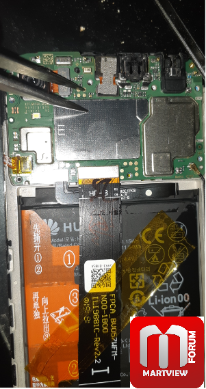

TEST POINT

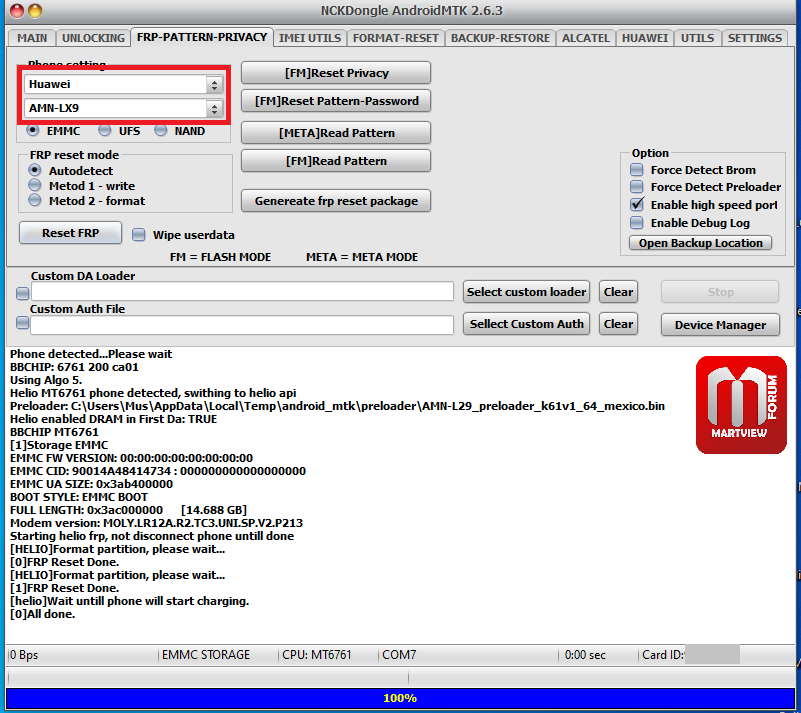

 Exe version: NCKDongle AndroidMTK 2.6.3
Selected model: Huawei  AMN-LX9
[auto]Action: Reset FRP
Reinsert phone battery.
Battery must be charged.
Detected : MediaTek USB Port (COM7)
Boot mode: Brom
Phone detected...Please wait
BBCHIP: 6761 200 ca01
Using Algo 5.
Helio MT6761 phone detected, swithing to helio api
Preloader: C:\Users\Mus\AppData\Local\Temp\android_mtk\preloader\AMN-L29_preloader_k61v1_64_mexico.bin
Helio enabled DRAM in First Da: TRUE
BBCHIP MT6761
[1]Storage EMMC
EMMC FW VERSION: 00:00:00:00:00:00:00:00
EMMC CID: 90014A48414734 : 000000000000000000
EMMC UA SIZE: 0x3ab400000
BOOT STYLE: EMMC BOOT
FULL LENGTH: 0x3ac000000      [14.688 GB]
Modem version: MOLY.LR12A.R2.TC3.UNI.SP.V2.P213
Starting helio frp, not disconnect phone untill done
[HELIO]Format partition, please wait...
[0]FRP Reset Done.
[1]FRP Reset Done.
[helio]Wait untill phone will start charging.
[0]All done.
