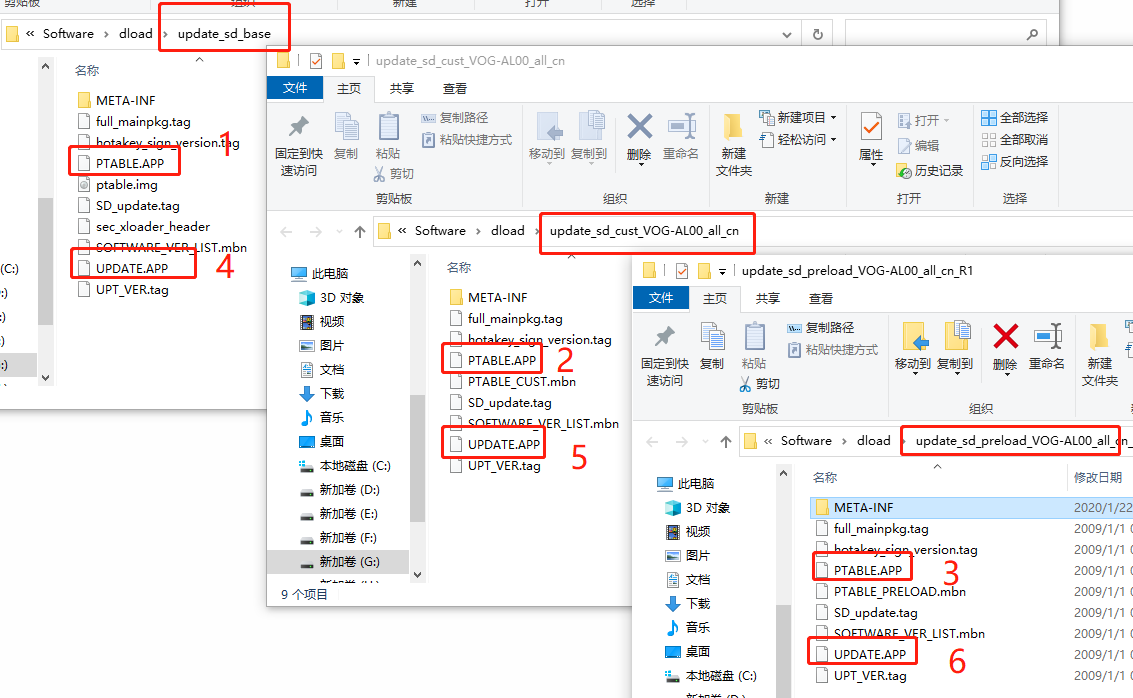

when we download one huawei flash file
like emui 9.1 emui 10.0
we can get 6 *.app file
like this
and we are flash it need like the pics,
ptable.app first
then update.app

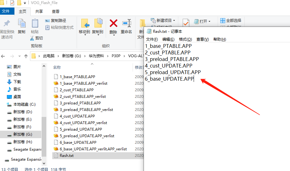

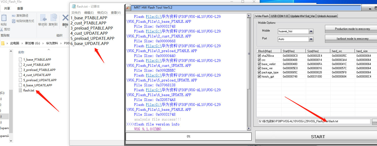

now we can make one txt file
put all the file name inside and use mrt hw flash tool you can select it
make flash it in the one time

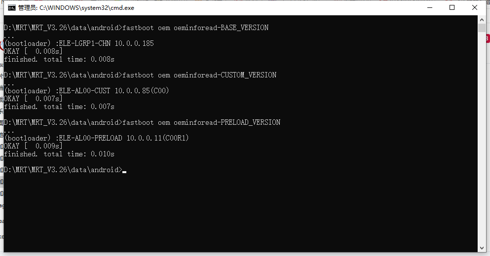

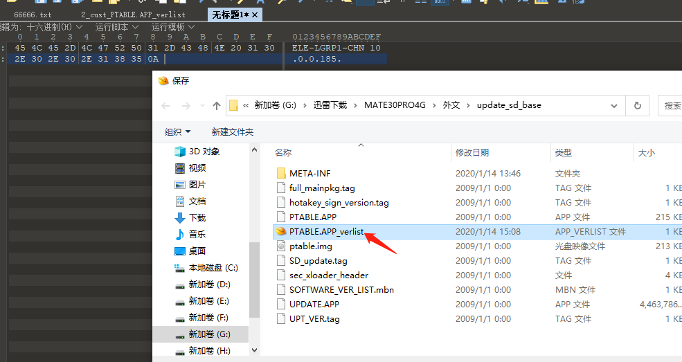

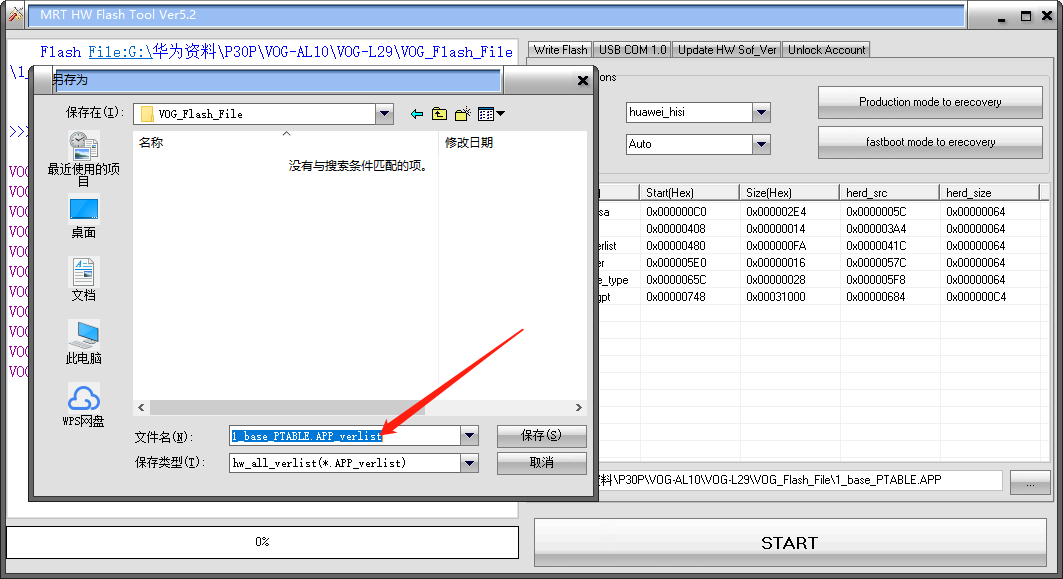

take one save mobile version flsah file

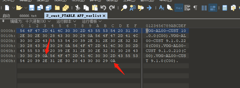

and take it verlist save to same file with what i want to right

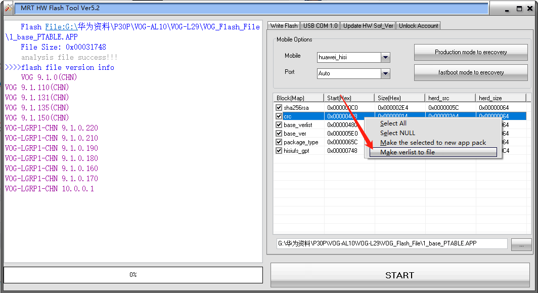

ex,i take emui10.0.0185 flash file,use mrt take the base_patble,cust_ptable,preloader patble,base update,cust_update,preload_update....
save to same file name.like base_patble.app save same Folder base_patble.app_verlist
then you can flash it!!!
even downgrade!!!

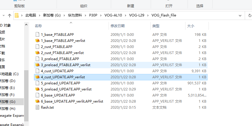

the flash txt file we are still same before
like this,when flashing mobile,auto replace the flsah file verlist form we are creat!!!
also you can take L29 verlist put in the AL00 and make Transformation
ex,take vog-L29 verlist and put in the VOG-AL00
flash it!!!
