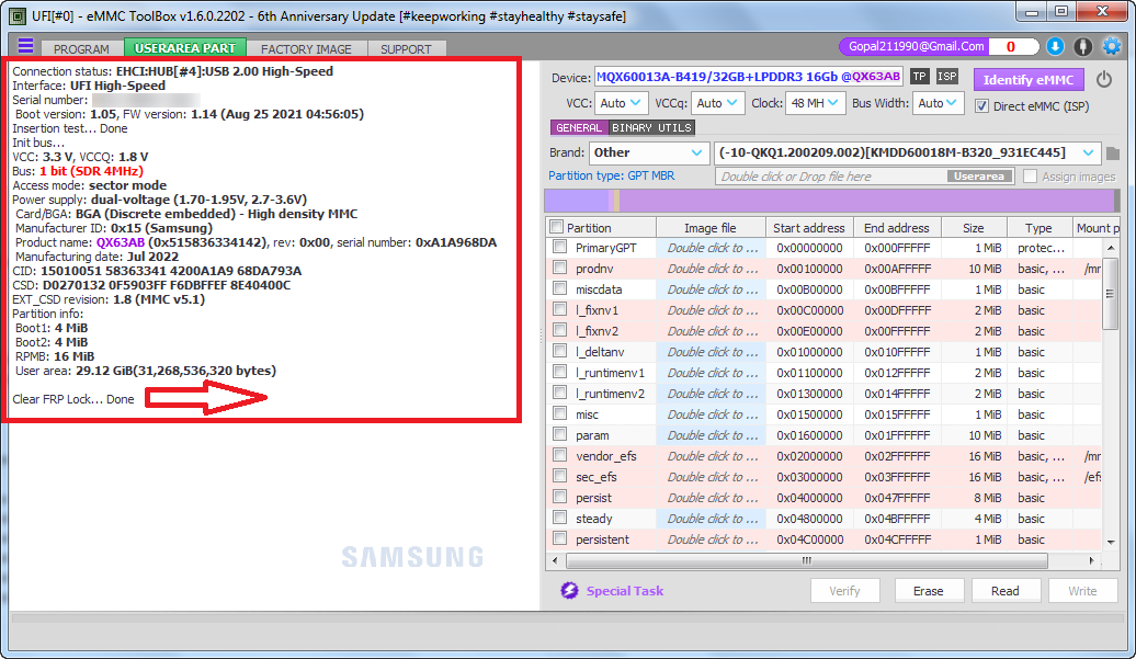

today in my shop come Samsung Galaxy A03 Core ( SM-A032F/DS ) with PL Lock than i do hard reset but hang on frp lock than i do try other tools in for remove frp lock but mobile dead & auto come spd port in device manager than do try many action than finally FRP Lock Done , Boot Repair Done & Again Alive One An Only By UFI Box

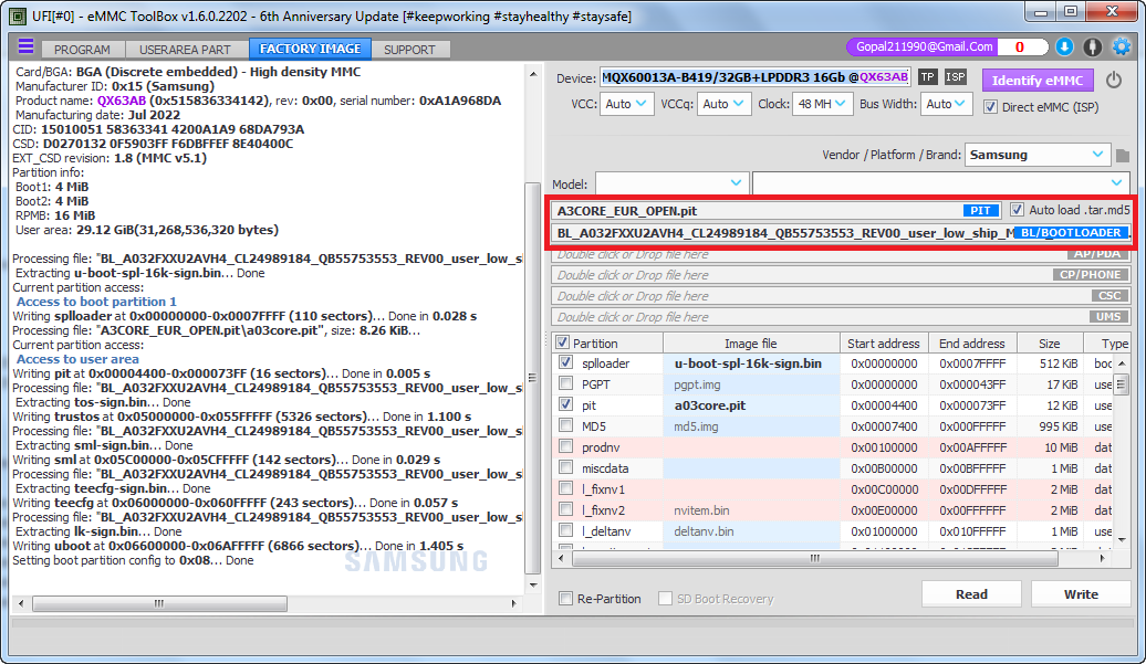

Boot Repair Done By UFI Box ( Just Write Pit File & BL Only For Boot Repair )

FRP Remove Successfully By UFI Box:
