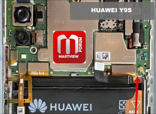

• Repair Boot Huawei P30 Lite (MAR-LXA1) By Chimera Tool + EFT Pro without Box Jtag •
16927
• The phone was dead as a result of Downgrade work to remove FRP
• As is well known, the phone carries a hisi710 processor and such problems are solved only by jtag box
• But with the recent update to the chimera team, you can solve the problem without Box Jtag
  • No fastboot mode
  • No Upgrade Mode
  • No USB COM 1.0
• The phone responds only with a test point (USB COM 1.0 )
:> Test Point <:

i need test point STK-L22DV (Huawei Y9 prime S)
