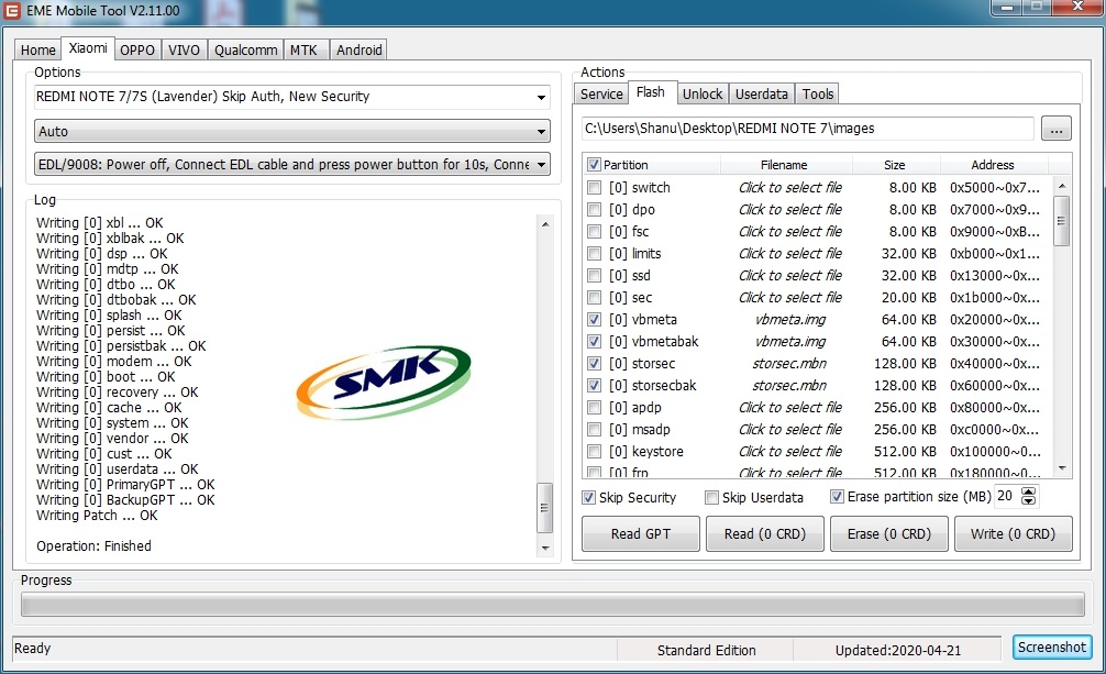

Redmi Note 7 [M1901F7G] (Lavender, MIUI11.0.4.0, 9.0)
Demand
: Reset Mi Account
User Problem : I had Resetted Mi Account by flashing (Mi account + FRP Files) but when i connected to WiFi it gets relocked again and ask for previous mi account
>> First of all, Read info
Operation process: Read info (No Credits Required)
1.Go to Service Tab, Press "Read Information"
3.Enter Qualcomm EDL/9008 mode connect USB Cable (install drivers)
4.Waiting for the operation to complete
>> After reading info, write Mi Account + FRP reset file
Operation process: Reset Mi Account (No Credits Required)
1.Go to Flash Tab, Select Modified Firmware Folder Press "Write"
>> Now Unlock Handset's Bootloader
Operation process: Bootloader Unlock (No Credits Required)
1.Go to Flash Tab, Select BL_Unlock Firmware Folder Press "Write"
>> After Unlocking Bootloader Handset's Screen will become BLACK (No need to panic) Now write Unlocked Firmware
Operation process: Flashing Anti-Relock Firmware (No Credits Required)
1.Go to Flash Tab, Select Modified Unlocked Firmware Folder Press "Write"
Required Firmwares, You'll find on EMT GDRIVE SUPPORT >> EMT - Google Drive
Best Regards
Smk :)

Hello, there is "The system has been destroyed" on the screen after flashing.
I skipped Unlocking Bootloader, because I dont have the file.
Can this be the problem?
write only these file"the system has been destroyed" prob solved tested by me.
Operation: Write Partition
Selected Model: LAVENDER
Platform: QUALCOMM
Waiting to Emergency mode device connect: OK
Port: COM46
Connect to device ... OK
Sending loader ... OK
Connecting to Sahara ... OK
Reading configuration ... EMMC/512
Writing partition ...
Checking payment interface ...
Connecting to server ... OK
Checking need payment ... NO
Writing [0] boot ... OK
Writing [0] recovery ... OK
Writing [0] cache ... OK
Operation: Finished
