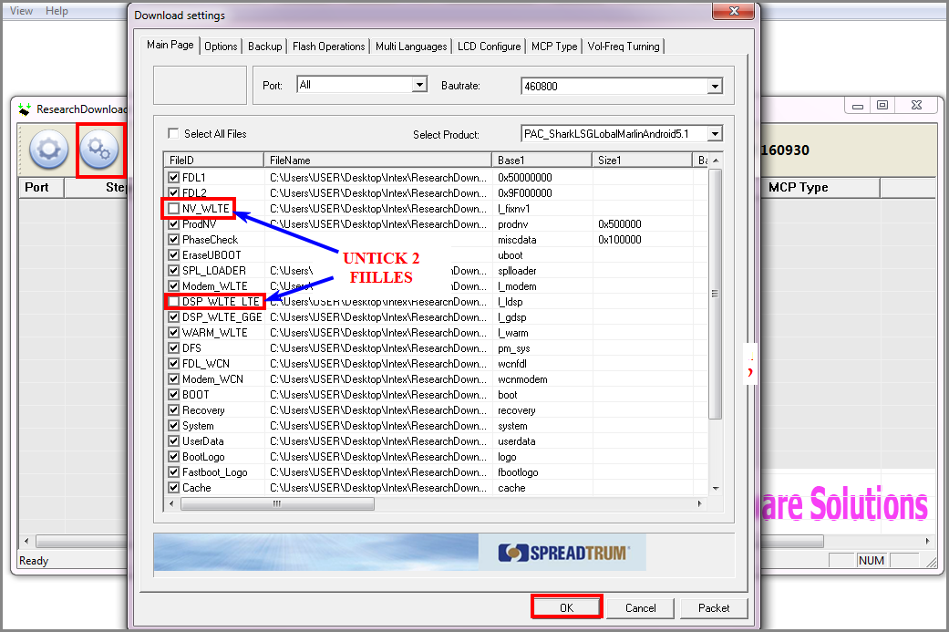

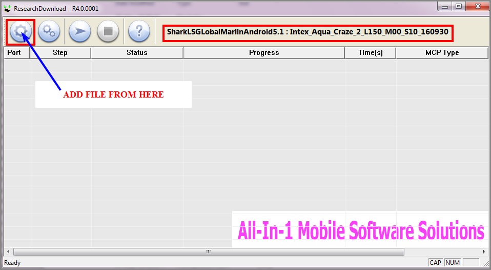

Open ResearchDownload_R4.0.0001 & Add File
Then Go To Download Settings Untick 2 Files Then Ok

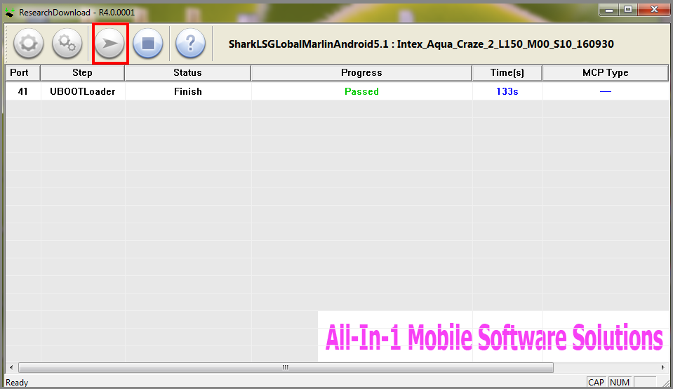

Then Flash
Now Touch Working (Intex-Aqua-Jewel-2) 100%
