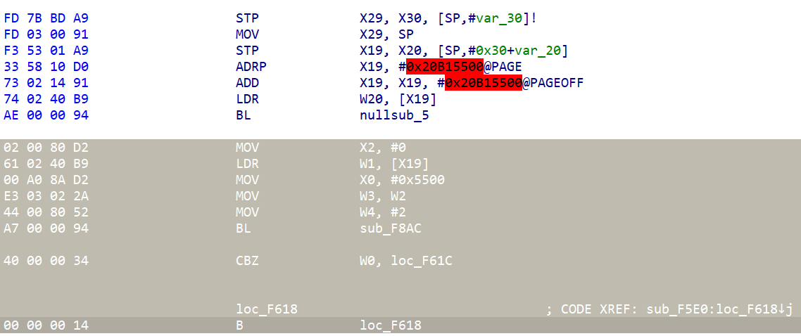

Step 1: overwrite stack to execute FDL1 without verfication
Use custom_exec_no_verify_3f88.bin to replace the stack if the device entered download mode by holding a specified button during startup (usually volume down).
Use custom_exec_no_verify_3f28.bin to replace the stack if the device entered download mode after all efforts to boot failed (for example, if the splloader was deleted and no key was hit).
Make custom_exec.bin in accordance with BootROM for more Socs affected by CVE-2022-38694.

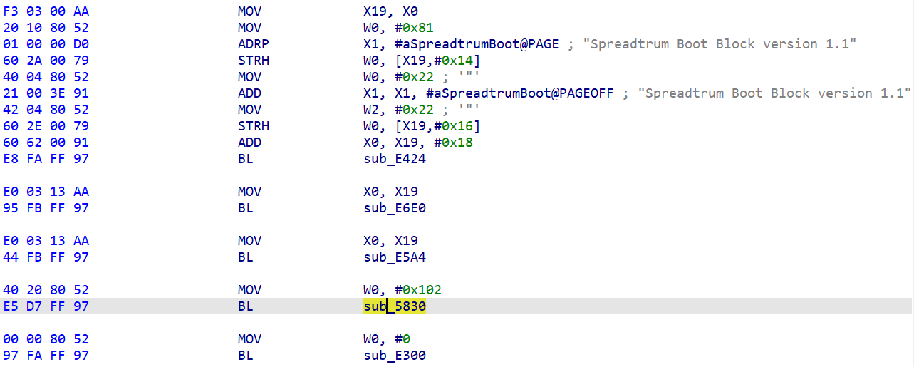

Step 2: Modify FDL1
Patch 1: NOP(1F 20 03 D5) verfication in data_exec.
Patch 2: change download mode (0x102)(40 20 80 52) to boot mode(0x104)(80 20 80 52).
  • Apply patch 1 to original FDL1, save as fdl1-dl.bin.
  • Apply patch 1 and patch 2 to original FDL1, save as fdl1-boot.bin.

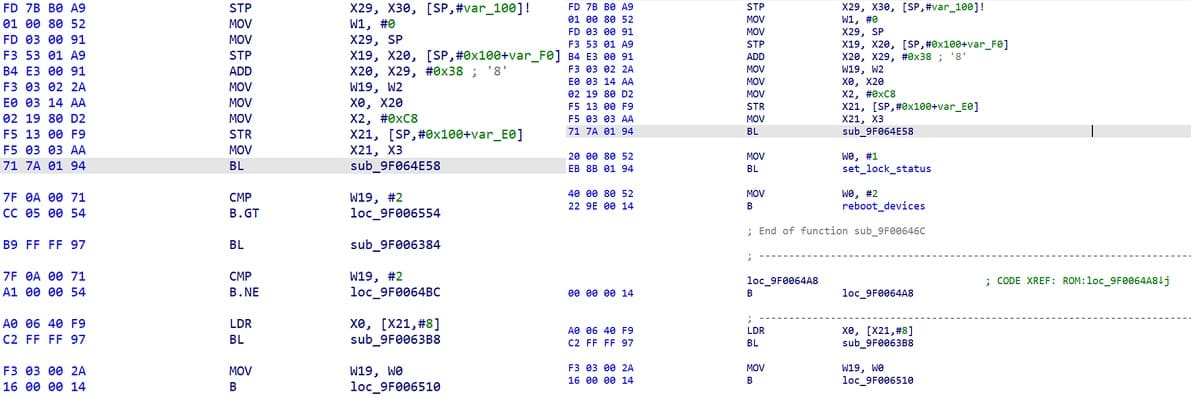

Patch 1: patch do_cboot.
search for VerifiedBoot-UNLOCK to find set_lock_status.

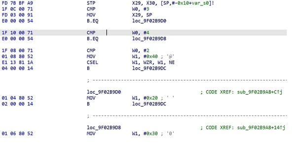

search for 0x32121BAC or 0x1BAC (T7510 specific address ?), and reboot_devices starts with CMP W0,#3 CMP W0,#4 CMP W0,#2.
search for enter boot mode to find do_cboot, patch it to call set_lock_status and reboot_devices.

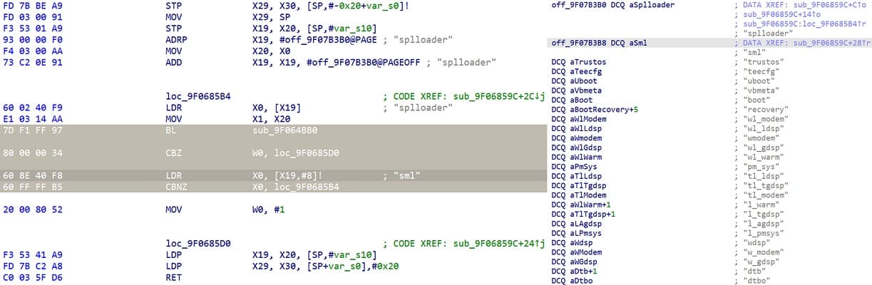

Part 4: get trustos images list and load address from splloader
get splloader by read_part
The list and address are easy to get, since _start calls reset, reset calls nand_boot, nand_boot will load images from emmc/ufs to memory and boot.
devicemodelandroidsmlteecfgtos
tyyh2020ud710_20c1090x94000000no need0x94040000
tyyh2021ud710_7h10100x940000000x940200000x94040000
Hisense A7ud710_2h10100x940000000x940200000x94040000
