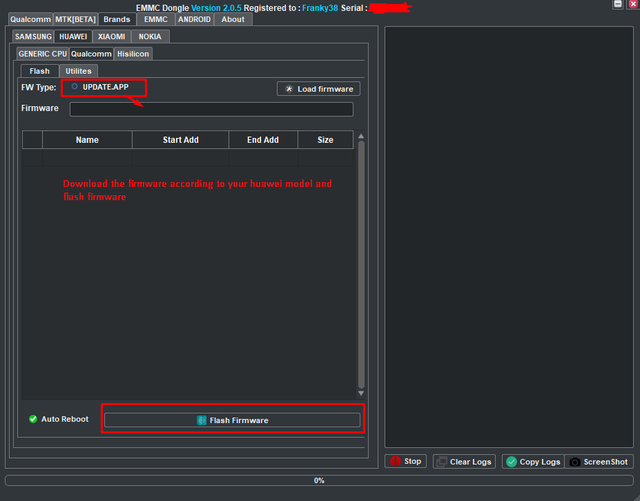

Good, the first thing to answer or help you have to speak in English, emmc dongle has an option to convert update.app to xml, I don't know if you will know.
Reactions: xaviko25
Franky38
Jul 28, 2018
1,886
2,191
Another way to do it is to flash the update.app, either way would be useful to revive or return to normal.

Thank you for responding, if I have also done so, but it starts the same I don't know what else to do
Thanks for answering, if you'll excuse me for writing in Spanish.
if I have already passed it to xml but the result is the same
