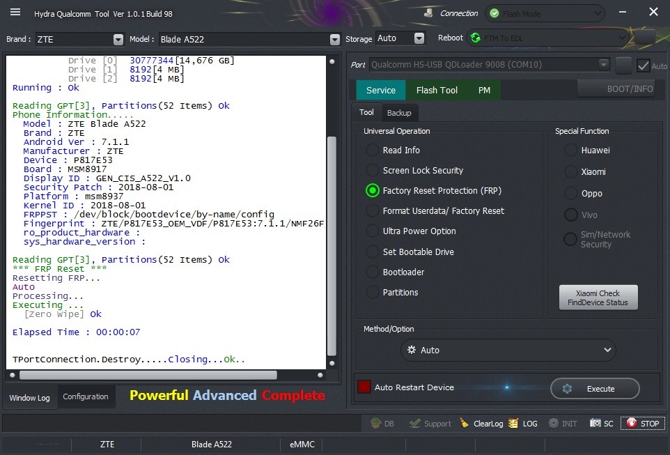

ZTE Blade A522 FRP Reset Success by Hydra Tool
Remove Google Account by edl mode with just 1 click
PreOperation Configuration
Brand : ZTE Model : Blade A522 Storage : Auto
Loader: Blade-A522.mbn
Port : Auto
Connection : Flash Mode
Searching EDL Port..[COM10]
TPortConnection.Create...(COM10)..Opening...Ok
Getting device info.......
Serial No.: 0x881B273F
MSM ID : 0x000560E1, MSM8917-Qualcomm Snapdragon 425
PBL Ver : 00000000
PK HASH : 9764995D53559360DC5789643D7424AC
E3BF6208DA9433656B7C9DD103F0FE65
Firehose Loader[Blade-A522.mbn]
Initializing SaharaBoot... Ok
Sending ...................Ok
Connecting to Firehose...
Ping... Ok
Configuration......
Identifying Chip....Ok
Chip Configuration :
MemoryName : eMMC
MaxXMLSizeInBytes : 4096
TargetName : 8917
Version : 1
* STORAGE DEVICE INFO *
Memory Type : eMMC
Block Size in Bytes : 512
Page Size : 512
Manufacturer ID : 69
Serial Number : 142043452
Firmware Version : 2314905408196718642
Product Name : DF4016
Physical Partitions : 3
Total Logical Blocks:
Drive [0] 30777344[14,676 GB]
Drive [1] 8192[4 MB]
Drive [2] 8192[4 MB]
Running : Ok
Reading GPT[3], Partitions(52 Items) Ok
Phone Information.....
Model : ZTE Blade A522
Brand : ZTE
Android Ver : 7.1.1
Manufacturer : ZTE
Device : P817E53
Board : MSM8917
Display ID : GEN_CIS_A522_V1.0
Security Patch : 2018-08-01
Platform : msm8937
Kernel ID : 2018-08-01
Fingerprint : ZTE/P817E53_OEM_VDF/P817E53:7.1.1/NMF26F/20181026.133929:user/release-keys
ro_product_hardware :
sys_hardware_version :
* FRP Reset *
Resetting FRP...
Auto
Processing...
Executing ...
[Zero Wipe] Ok
Elapsed Time : 00:00:07
