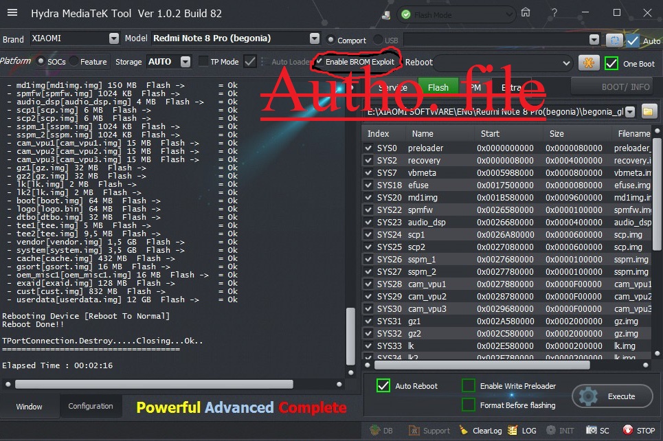

Hydra Xiomi Note 8 Pro (begonia) successfully Flashed by Hydra Tool
546
Brand : XIAOMI Model : Redmi Note 8 Pro (begonia) Connection : Flash Mode
How To Boot : Power off phone
* BROM Mode : Press VOL + or Press VOL -+
Connection
-Please wait...
-Found...[COM3]
TPortConnection.Create...(COM3)..Opening...Ok
Handshaking...Ok
Identifying Hardware ID.....
BROM CPUID : 0813MT6785[6785]
getMTKPayloadExploit : 0813
#Executing Exploit..
#SUCCESS..
Handshaking...Ok
FUSEID : 00000000
SECURE VERSION : 05
BL VERSION : FE
BR Secured : E0
Preparing Download Agent..
DA : 6785.bin
Ver : MTK_AllInOne_DA_v3.3001.2020-11-03.22:07_536568
Init : Loader [1]
Sending : Accepted
Identifying Protocol...
Protocol : New
Synchronization...SYNC
Mode : brom
Preloader Initialization...
Parsing preloader_begonia.bin
Init : Accepted
Execute Secondary Loader
Init : Loader [2]
Executing : SYNC
UNIQUE ID : 5F2E7C133CF4EB9FB67456CCB0DDE01C
IRAM Size : 0x0000000180000000 -6 GB
UFS LU0 Size: 0x0000000000400000 -4 MB
UFS LU1 Size: 0x0000000000400000 -4 MB
UFS LU2 Size: 0x0000000EE5800000 -59,586 GB
UFS CID : *OH9HQ53AECMMDAR
UFS UNIQID : 0d80f85332a0000000000000
DA Speed : high-speed
Reading GPT-UFS [0x00008000] 130 Items
Reading System Info
Vendor : Xiaomi
SDK : 29
Release : 10
ABI : arm64-v8a
Locale : en-GB
Description : begonia-user 10 QP1A.190711.020 V12.0.3.0.QGGMIXM release-keys
Miui Ver : V12
Mod_device : begonia_global
Display ID : QP1A.190711.020
Security Patch : 2020-08-01
StorageType : mtp
Autobackup Partitions
-> Renaming Preloader....
-frp[0x05888000]1024 KB ->frp.bin...Ok
-nvdata[0x08188000]64 MB ->nvdata.bin...Ok
-persist[0x0E188000]70,469 MB ->persist.bin...Ok
-nvram[0x17580000]64 MB ->nvram.bin...Ok
Done!!!
C:\Hydra Tool\\Backup\Auto\__0813--10_QP1A.190711.020_220221172629
- preloader[preloader_begonia.bin] 512 KB Skipped
- recovery[recovery.img] 64 MB Flash -> = Ok
- vbmeta[vbmeta.img] 8 MB Flash -> = Ok
- efuse[efuse.img] 512 KB Flash -> = Ok
- md1img[md1img.img] 150 MB Flash -> = Ok
- spmfw[spmfw.img] 1024 KB Flash -> = Ok
- audio_dsp[audio_dsp.img] 4 MB Flash -> = Ok
- scp1[scp.img] 6 MB Flash -> = Ok
- scp2[scp.img] 6 MB Flash -> = Ok
- sspm_1[sspm.img] 1024 KB Flash -> = Ok
- sspm_2[sspm.img] 1024 KB Flash -> = Ok
- cam_vpu1[cam_vpu1.img] 15 MB Flash -> = Ok
- cam_vpu2[cam_vpu2.img] 15 MB Flash -> = Ok
- cam_vpu3[cam_vpu3.img] 15 MB Flash -> = Ok
- gz1[gz.img] 32 MB Flash -> = Ok
- gz2[gz.img] 32 MB Flash -> = Ok
- lk[lk.img] 2 MB Flash -> = Ok
- lk2[lk.img] 2 MB Flash -> = Ok
- boot[boot.img] 64 MB Flash -> = Ok
- logo[logo.bin] 64 MB Flash -> = Ok
- dtbo[dtbo.img] 32 MB Flash -> = Ok
- tee1[tee.img] 5 MB Flash -> = Ok
- tee2[tee.img] 9,5 MB Flash -> = Ok
- vendor[vendor.img] 1,5 GB Flash -> = Ok
- system[system.img] 3,5 GB Flash -> = Ok
- cache[cache.img] 432 MB Flash -> = Ok
- gsort[gsort.img] 16 MB Flash -> = Ok
- oem_misc1[oem_misc1.img] 16 MB Flash -> = Ok
- exaid[exaid.img] 128 MB Flash -> = Ok
- cust[cust.img] 832 MB Flash -> = Ok
- userdata[userdata.img] 12 GB Flash -> = Ok
Reboot Done!!
Elapsed Time : 00:02:16
