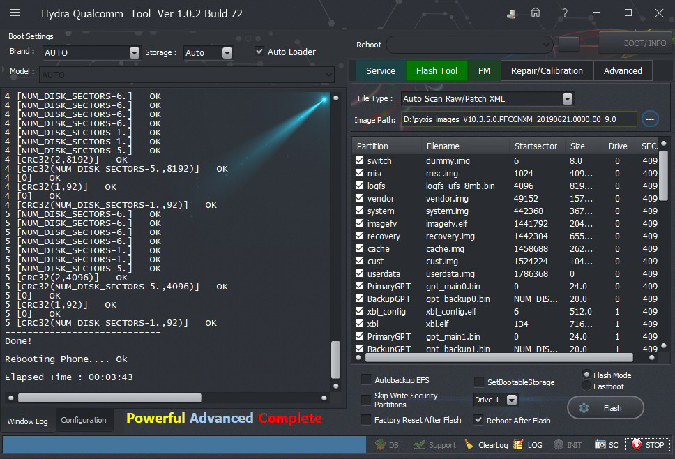

Hydra Xiomi Mi CC 9 Successfully Flashed by Hydra Tool
546
FriendlyName :Qualcomm HS-USB QDLoader 9008 (COM15)
SymbolicName :\??\USB#VID_05C6&PID_9008#5&1b75157d&0&1#{a5dcbf10-6530-11d2-901f-00c04fb951ed}
Getting device info......
Serial No.: 0x43FC9B6B
MSM ID : 0x000DB0E1, SDM710-Qualcomm Snapdragon 710
PBL Ver : 00000000
PK HASH : C924A35F39CE1CDD1B8D5A9F3B8E3C51
317930431D7A9DD5A55028CF6965FE65
Firehose Loader[prog_emmc_firehose_sdm670_ddr.elf]
SaharaBoot... Ok
Sending .....................................Ok
Connecting to Firehose...
Ping..................... Ok
Configuration.
Signature Request -> bob[CQdPYhRvRw7lZzVF7Vg8dARetTN]
- Hydra Is Online
Identifying Chip........UFS
Ok
Chip Configuration :
MemoryName : UFS
MaxXMLSizeInBytes : 4096
TargetName :
Version : 1
DateTime : Aug 24 2018 - 20:05:37
*** STORAGE DEVICE INFO ***
Memory Type : UFS
Block Size in Bytes : 4096
Page Size : 4096
Manufacturer ID : 462
Serial Number : 1297306958
Firmware Version : 600
Product Name : KM8B8001JM-BC01
Physical Partitions : 6
Total Logical Blocks:
Drive [0] 62162944[237.133 GB]
Drive [1] 2048[8 MB]
Drive [2] 2048[8 MB]
Drive [3] 8192[32 MB]
Drive [4] 262144[1024 MB]
Drive [5] 40960[160 MB]
Protocol : Universal
Running : Ok
Phone Information......
Brand : Xiaomi
Vendor : Xiaomi
Model : MI CC 9
SDK : 28
Release : 9
ABI : arm64-v8a
Locale : zh-CN
Description : pyxis-user 9 PKQ1.181121.001 V10.3.5.0.PFCCNXM release-keys
Miui Ver : V10
Device : pyxis
Display ID : PKQ1.181121.001
Security Patch : 2019-05-01
Fingerprint : Xiaomi/pyxis/pyxis:9/PKQ1.181121.001/V10.3.5.0.PFCCNXM:user/release-keys
- switch(0)[dummy.img] Ok
- misc(0)[misc.img] Ok
- logfs(0)[logfs_ufs_8mb.bin] Ok
- vendor(0)[vendor.img] Ok
- system(0)[system.img] Ok
- imagefv(0)[imagefv.elf] Ok
- cache(0)[cache.img] Ok
- cust(0)[cust.img] Ok
- xbl_config(1)[xbl_config.elf] Ok
- xbl(1)[xbl.elf] Ok
- PrimaryGPT(1)[gpt_main1.bin] Ok
- xbl_configbak(2)[xbl_config.elf] Ok
- xblbak(2)[xbl.elf] Ok
- PrimaryGPT(2)[gpt_main2.bin] Ok
- PrimaryGPT(3)[gpt_main3.bin] Ok
- qupfw(4)[qupv3fw.elf] Ok
- qupfwbak(4)[qupv3fw.elf] Ok
- vbmeta(4)[vbmeta.img] Ok
- storsec(4)[storsec.mbn] Ok
- storsecbak(4)[storsec.mbn] Ok
- devcfg(4)[devcfg.mbn] Ok
- devcfgbak(4)[devcfg.mbn] Ok
- aop(4)[aop.mbn] Ok
- aopbak(4)[aop.mbn] Ok
- cmnlib(4)[cmnlib.mbn] Ok
- cmnlibbak(4)[cmnlib.mbn] Ok
- cmnlib64(4)[cmnlib64.mbn] Ok
- cmnlib64bak(4)[cmnlib64.mbn] Ok
- keymaster(4)[keymaster64.mbn] Ok
- keymasterbak(4)[keymaster64.mbn] Ok
- bluetooth(4)[BTFM.bin] Ok
- abl(4)[abl.elf] Ok
- ablbak(4)[abl.elf] Ok
- tz(4)[tz.mbn] Ok
- tzbak(4)[tz.mbn] Ok
- hyp(4)[hyp.mbn] Ok
- hypbak(4)[hyp.mbn] Ok
- dtbo(4)[dtbo.img] Ok
- logo(4)[logo.img] Ok
- dsp(4)[dspso.bin] Ok
- boot(4)[boot.img] Ok
- modem(4)[NON-HLOS.bin] Ok
- PrimaryGPT(4)[gpt_main4.bin] Ok
- persist(5)[persist.img] Ok
- PrimaryGPT(5)[gpt_main5.bin] Ok
0 [NUM_DISK_SECTORS-6.] OK
0 [NUM_DISK_SECTORS-1.] OK
0 [NUM_DISK_SECTORS-5.] OK
0 [CRC32(2,4096)] OK
0 [CRC32(NUM_DISK_SECTORS-5.,4096)] OK
0 [0] OK
0 [CRC32(1,92)] OK
0 [0] OK
1 [NUM_DISK_SECTORS-6.] OK
1 [NUM_DISK_SECTORS-1.] OK
1 [NUM_DISK_SECTORS-5.] OK
1 [CRC32(2,4096)] OK
1 [CRC32(NUM_DISK_SECTORS-5.,4096)] OK
1 [0] OK
1 [CRC32(1,92)] OK
1 [0] OK
1 [CRC32(NUM_DISK_SECTORS-1.,92)] OK
2 [NUM_DISK_SECTORS-6.] OK
2 [NUM_DISK_SECTORS-1.] OK
2 [NUM_DISK_SECTORS-5.] OK
2 [CRC32(2,4096)] OK
2 [CRC32(NUM_DISK_SECTORS-5.,4096)] OK
2 [0] OK
2 [CRC32(1,92)] OK
2 [0] OK
2 [CRC32(NUM_DISK_SECTORS-1.,92)] OK
3 [NUM_DISK_SECTORS-6.] OK
3 [NUM_DISK_SECTORS-1.] OK
3 [NUM_DISK_SECTORS-5.] OK
3 [CRC32(2,4096)] OK
3 [CRC32(NUM_DISK_SECTORS-5.,4096)] OK
3 [0] OK
3 [CRC32(1,92)] OK
3 [0] OK
3 [CRC32(NUM_DISK_SECTORS-1.,92)] OK
4 [NUM_DISK_SECTORS-6.] OK
4 [NUM_DISK_SECTORS-1.] OK
4 [NUM_DISK_SECTORS-5.] OK
4 [CRC32(2,8192)] OK
4 [CRC32(NUM_DISK_SECTORS-5.,8192)] OK
4 [0] OK
4 [CRC32(1,92)] OK
4 [0] OK
4 [CRC32(NUM_DISK_SECTORS-1.,92)] OK
5 [NUM_DISK_SECTORS-6.] OK
5 [NUM_DISK_SECTORS-1.] OK
5 [NUM_DISK_SECTORS-5.] OK
5 [CRC32(2,4096)] OK
5 [CRC32(NUM_DISK_SECTORS-5.,4096)] OK
5 [0] OK
5 [CRC32(1,92)] OK
5 [0] OK
5 [CRC32(NUM_DISK_SECTORS-1.,92)] OK
Done!
Rebooting Phone.... Ok
Elapsed Time : 00:03:43
