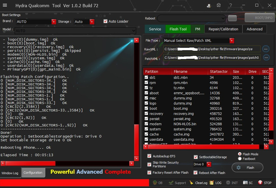

Hydra Xiomi Mi 3W successfully flashed by Hydra Tool
546
FriendlyName :Qualcomm HS-USB QDLoader 9008 (COM10)
SymbolicName :\??\USB#VID_05C6&PID_9008#5&376aba2d&0&8#{a5dcbf10-6530-11d2-901f-00c04fb951ed}
Getting device info.....
Serial No.: 0x0AA260E9
MSM ID : 0x007B90E1, MSM8674_AB-
PBL Ver : 00000000
PK HASH : CC3153A80293939B90D02D3BF8B23E02
92E452FEF662C74998421ADAD42A380F
Firehose Loader[8974.mbn]
SaharaBoot... Ok
Sending ....Ok
Connecting to Firehose...
Ping. Ok
Configuration........
Identifying Chip..........eMMC
Ok
Chip Configuration :
MemoryName : eMMC
MaxPayloadSizeToTargetInBytes : 131072
MaxPayloadSizeToTargetInBytesSupported : 131072
MaxXMLSizeInBytes : 4096
TargetName : 8974
Version : 1
Protocol : Universal
Running : Ok
Phone Information.....
Brand : Xiaomi
Vendor : Xiaomi
Model : MI 3W
SDK : 23
Release : 6.0.1
ABI : armeabi-v7a
Locale : en-GB
Description : cancro-user 6.0.1 MMB29M V8.1.4.0.MXDMIDI release-keys
Miui Ver : V8
Device : cancro
Mod_device : cancro_global
Board : MSM8974
Display ID : MMB29M
Security Patch : 2016-11-01
Platform : msm8974
Fingerprint : Xiaomi/cancro/cancro:6.0.1/MMB29M/V8.1.4.0.MXDMIDI:user/release-keys
Reading GPT[1]
Drive [0] 28 Items
Backup Security partitions...
Reading Security Items....
> modemst1
> modemst2
> fsg
C:\Users\Ghost\hydra tool\HydraTool_Fullpackage_01-25-2021\Backup\Security_Backup\MI 3W_MSM8974_6.0.1_Security_020521183756.sec
Backup Security Success....
- sbl1(0)[sbl1.mbn] Ok
- rpm(0)[rpm.mbn] Ok
- tz(0)[tz.mbn] Ok
- misc(0)[dummy.img] Ok
- logo(0)[dummy.img] Ok
- boot(0)[boot.img] Ok
- modem(0)[NON-HLOS.bin] Ok
- system(0)[system.img] Ok
- cache(0)[cache.img] Ok
0 [NUM_DISK_SECTORS-34.] OK
0 [NUM_DISK_SECTORS-1.] OK
0 [NUM_DISK_SECTORS-33.] OK
0 [CRC32(2,3584)] OK
0 [CRC32(NUM_DISK_SECTORS-33.,3584)] OK
0 [0] OK
0 [CRC32(1,92)] OK
0 [0] OK
Done!
Rebooting Phone.... Ok
Elapsed Time : 00:05:13
