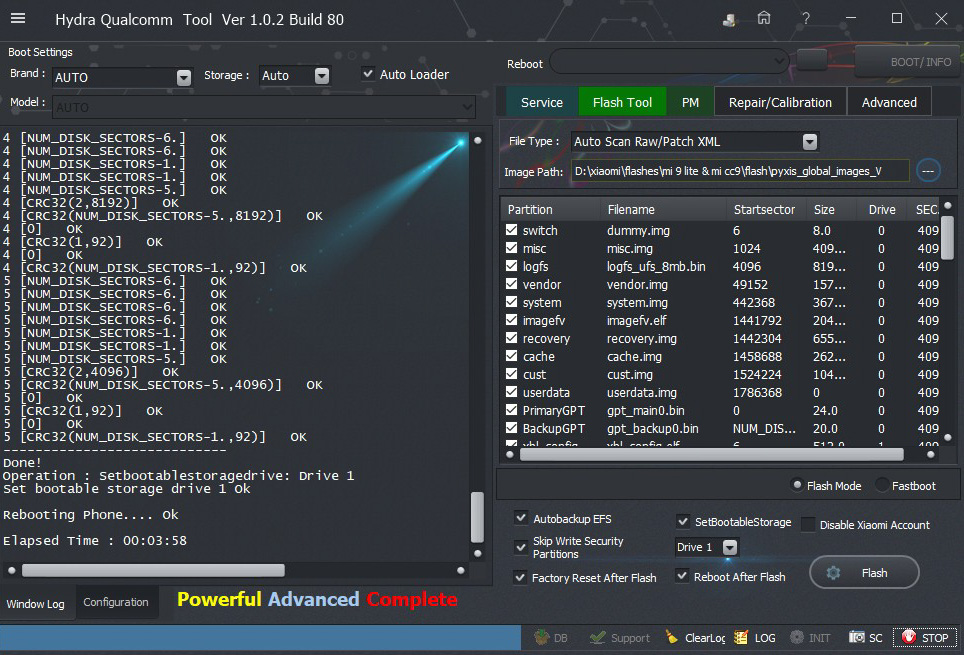

Xioami Redmi Mi 9 Lite successfully flashed by Hydra Tool
1. Run Hydra Qualcomm Tool
2. Go to "Flash Tool"
3. Click "Image Path" and choose correct Flash File
4. Click on "Flash" button.
5. Connect Device with Computer using USB Data Cable
6. Wait until the flashing process is completed.
7. Done
7. Done

Done!
Operation : Setbootablestoragedrive: Drive 1
Set bootable storage drive 1 Ok
Rebooting Phone.... Ok
Elapsed Time : 00:03:58
