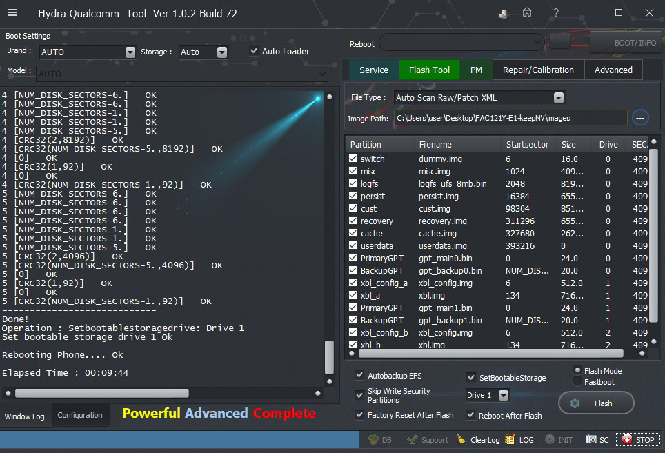

Hydra Xioami Redmi Mi 8 Successfully Flashed by Hydra Tool
546
FriendlyName :Qualcomm HS-USB QDLoader 9008 (COM145)

Getting device info......
Serial No.: 0xEE7ECC54
MSM ID : 0x0008B0E1, SDM845-Qualcomm Snapdragon 845
PBL Ver : 00000000
PK HASH : C924A35F39CE1CDD1B8D5A9F3B8E3C51
317930431D7A9DD5A55028CF6965FE65
Firehose Loader[prog_ufs_firehose_sdm845_ddr_10.elf]
SaharaBoot... Ok
Sending .....................................Ok
Connecting to Firehose...

Reading GPT[6]
Drive [0] 32 Items
Drive [1] 32 Items
Drive [2] 32 Items
Drive [3] 32 Items
Drive [4] 64 Items
Drive [5] 32 Items
Backup Security partitions...
Reading Security Items....
> modemst1
> modemst2
> fsg
C:\Users\user\Desktop\Новая папка (5)\Backup\Security_Backup\MI 8__8.1.0_Security_022521091916.sec
Backup Security Success....

Done!
Operation : Setbootablestoragedrive: Drive 1
Set bootable storage drive 1 Ok
Rebooting Phone.... Ok
Elapsed Time : 00:09:44
