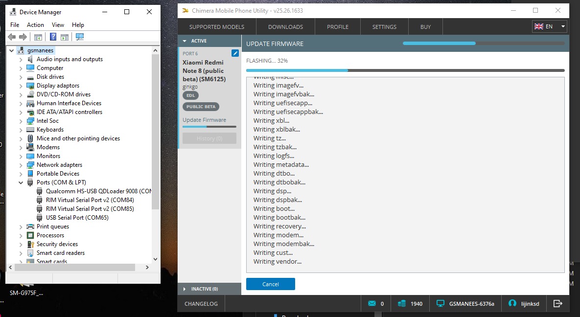

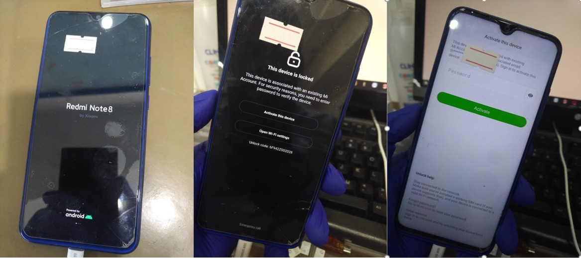

Device condition: dead / no power
Solution
Flashed with ginkgo_global_images_V11.0.9.0.PCOMIXM_20200601.00 00.00_9.0_global.zip

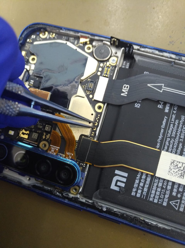

Short Test point :
Chimera Mobile Phone Utility version: 25.26.1633 @ 2020-07-07
Printing phone history
Update Firmware
07-07-2020
12:17:12
PM
Flash firmware
Flashing from local file: C:/Users/anees/Downloads/Compressed/ginkgo_global_images_V11.0.9.0.PCOMIXM_20200601.0000.00_9.0_global_2903c58fee/ginkgo_global_images_V11.0.9.0.PCOMIXM_20200601.0000.00_9.0_global.zip
Extracting firmware
Processing XML files
Preparing Qualcomm programmer
Gathering device info
Downloading Qualcomm programmer
Connecting to Qualcomm programmer
Reading GPTs
Flashing...
Writing qupfw...
Writing qupfwbak...
Writing vbmeta...
Writing vbmetabak...
Writing xbl_config...
Writing xbl_configbak...
Writing devcfg...
Writing devcfgbak...
Writing storsec...
Writing rpm...
Writing rpmbak...
Writing hyp...
Writing hypbak...
Writing keymaster...
Writing keymasterbak...
Writing cmnlib...
Writing cmnlib64...
Writing cmnlibbak...
Writing cmnlib64bak...
Writing abl...
Writing ablbak...
Writing bluetooth...
Writing bluetoothbak...
Writing misc...
Writing imagefv...
Writing imagefvbak...
Writing uefisecapp...
Writing uefisecappbak...
Writing xbl...
Writing xblbak...
Writing tz...
Writing tzbak...
Writing logfs...
Writing metadata...
Writing dtbo...
Writing dtbobak...
Writing dsp...
Writing dspbak...
Writing boot...
Writing bootbak...
Writing recovery...
Writing modem...
Writing modembak...
Writing cust...
Writing vendor...
Writing system...
Writing userdata...
Writing PrimaryGPT...
Writing BackupGPT...

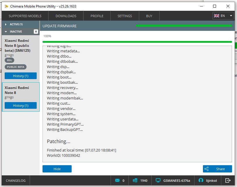

Patching...
Finished at local time: [07.07.20 18:08:41]
WorkID: 100039042
After flashing, Job done successfully
