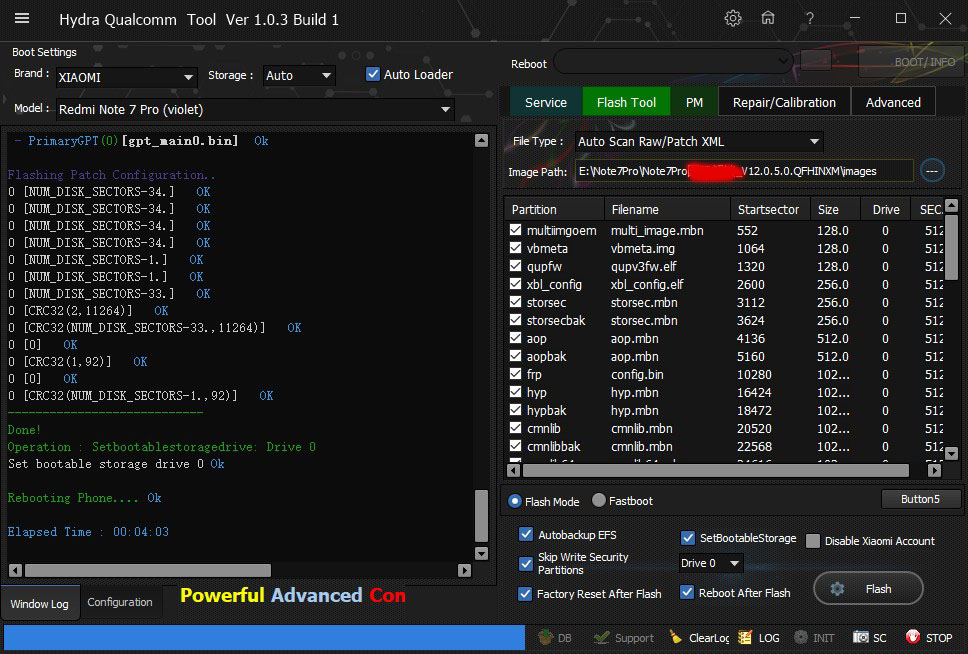

Xiaomi Redmi Note 7 Pro (Violet) successfully flashed by Hydra Tool
1. Run Hydra Qualcomm Module.
2. Choose Brand and Module.
3. Go to "Flash Tool" Tab.
4. Choose Flash file and its location.
5. Disassemble the cellphone (device) and find its test point.
6. Click on "Flash"
7. Short both testpoint using twiser or other tool.
8. connect device to the computer with USB Data cable
9. Wait until the process is completed.
