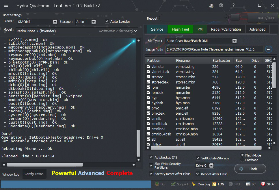

Xiaomi Redmi Note 7 Lavendra Successfully Flashed by Hydra Tool
1. Run Hydra Qualcomm Module and Sosc.
2. Choose Brand and Module.
3. Go to "Flash Tool" Tab.
4. Choose Flash file and its location.
5. Click on "Execute"
6. connect device to the computer with USB Data cable
7. Wait until the process is completed.
BRSearching for Qualcomm 9008 Device...Found
FriendlyName :Qualcomm HS-USB QDLoader 9008 (COM5)
SymbolicName :\??\USB#VID_05C6&PID_9008#5&1e94452c&0&4#{a5dcbf10-6530-11d2-901f-00c04fb951ed}
Driver Ver :02/05/2018,3.0.0.0
Getting device info..Ok
Device MODE : Firehose
Connecting to Firehose...
Ping...... Ok
Configuration......
Identifying Chip....
Ok
Chip Configuration :
MemoryName : eMMC
MaxXMLSizeInBytes : 4096
TargetName : MSM8996
Version : 1
DateTime : Aug 2 2018 - 22:27:53
*** STORAGE DEVICE INFO ***
Memory Type : eMMC
Block Size in Bytes : 512
Page Size : 512
Manufacturer ID : 19
Serial Number : 229244572
Firmware Version : 4
Product Name : S0J9K9
Physical Partitions : 4
Total Logical Blocks:
Drive [0] 244285440[116.484 GB]
Drive [1] 8192[4 MB]
Drive [2] 8192[4 MB]
Drive [3] 32768[16 MB]
Protocol : Universal
Running : Ok
Phone Information......
Vendor : Xiaomi
SDK : 29
Release : 10
ABI : arm64-v8a
Locale : en-GB
Miui Ver : V12
Mod_device : lavender_global
Display ID : QKQ1.190910.002 V12.0.1.0.QFGMIXM
Security Patch : 2020-10-01
Reading GPT[4]
Drive [0] 68 Items
Drive [1] 0 Items
Drive [2] 0 Items
Drive [3]
Backup Security partitions...
Reading Security Items....
> modemst1
> modemst2
> fsg
C:\Hydra Tool\Backup\Security_Backup\__10_Security_043021173416.sec
Backup Security Success....
- vbmeta(0)[vbmeta.img] Ok
- vbmetabak(0)[vbmeta.img] Ok
- storsec(0)[storsec.mbn] Ok
- storsecbak(0)[storsec.mbn] Ok
- rpm(0)[rpm.mbn] Ok
- rpmbak(0)[rpm.mbn] Ok
- hyp(0)[hyp.mbn] Ok
- hypbak(0)[hyp.mbn] Ok
- pmic(0)[pmic.elf] Ok
- pmicbak(0)[pmic.elf] Ok
- cmnlib(0)[cmnlib.mbn] Ok
- cmnlibbak(0)[cmnlib.mbn] Ok
- cmnlib64(0)[cmnlib64.mbn] Ok
- cmnlib64bak(0)[cmnlib64.mbn] Ok
- abl(0)[abl.elf] Ok
- ablbak(0)[abl.elf] Ok
- devcfgbak(0)[devcfg.mbn] Ok
- devcfg(0)[devcfg.mbn] Ok
- tz(0)[tz.mbn] Ok
- tzbak(0)[tz.mbn] Ok
- mdtpsecapp(0)[mdtpsecapp.mbn] Ok
- mdtpsecappbak(0)[mdtpsecapp.mbn] Ok
- keymaster(0)[km4.mbn] Ok
- keymasterbak(0)[km4.mbn] Ok
- bluetooth(0)[BTFM.bin] Ok
- xbl(0)[xbl.elf] Ok
- xblbak(0)[xbl.elf] Ok
- misc(0)[misc.img] Ok
- dsp(0)[dspso.bin] Ok
- mdtp(0)[mdtp.img] Ok
- dtbo(0)[dtbo.img] Ok
- dtbobak(0)[dtbo.img] Ok
- splash(0)[splash.img] Ok
- modem(0)[NON-HLOS.bin] Ok
- boot(0)[boot.img] Ok
- cache(0)[cache.img] Ok
- system(0)[system.img] Ok
- vendor(0)[vendor.img] Ok
- cust(0)[cust.img] Ok
Done!
Rebooting Phone.... Ok
Elapsed Time : 00:04:14
