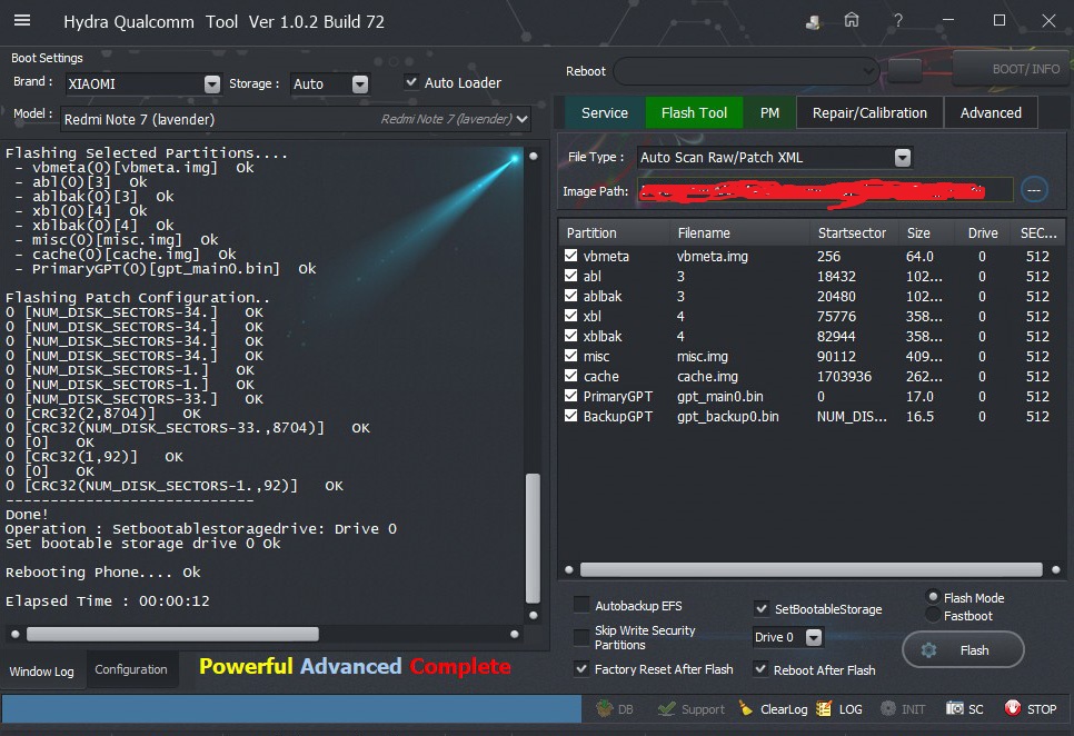

Xiaomi Redmi Note 7 (Lavender) Successfully Flashed by Hydra Tool
FriendlyName :Qualcomm HS-USB QDLoader 9008 (COM8)
SymbolicName :\??\USB#VID_05C6&PID_9008#6&375385d2&0&6#{a5dcbf10-6530-11d2-901f-00c04fb951ed}
Getting device info......
Serial No.: 0x07850A52
MSM ID : 0x0008C0E1, SDM660-Qualcomm Snapdragon 660
PBL Ver : 00000000
PK HASH : A7B8B82545A98ECA23D6E9105FB46456
8D1B5828264903441BDEF0CD57E3C370
Firehose Loader[mi_2_9.elf]
SaharaBoot... Ok
Sending ...............................Ok
Connecting to Firehose...
Ping......... Ok
Configuration......
Identifying Chip....
Ok
Chip Configuration :
MemoryName : eMMC
MaxXMLSizeInBytes : 4096
TargetName : MSM8996
Version : 1
DateTime : Aug 2 2018 - 22:27:53
*** STORAGE DEVICE INFO ***
Memory Type : eMMC
Block Size in Bytes : 512
Page Size : 512
Manufacturer ID : 21
Serial Number : 4050046057
Firmware Version : 2
Product Name : DH6DAB
Physical Partitions : 4
Total Logical Blocks:
Drive [1] 8192[4 MB]
Drive [2] 8192[4 MB]
Drive [3] 32768[16 MB]
Protocol : Universal
Running : Ok
Phone Information......
Vendor : Xiaomi
SDK : 29
Release : 10
ABI : arm64-v8a
Locale : zh-CN
Miui Ver : V12
Display ID : QKQ1.190910.002 V12.0.3.0.QFGCNXM
Security Patch : 2021-01-01
- vbmeta(0)[vbmeta.img] Ok
- abl(0)[3] Ok
- ablbak(0)[3] Ok
- xbl(0)[4] Ok
- xblbak(0)[4] Ok
- misc(0)[misc.img] Ok
- cache(0)[cache.img] Ok
0 [NUM_DISK_SECTORS-34.] OK
0 [NUM_DISK_SECTORS-1.] OK
0 [NUM_DISK_SECTORS-33.] OK
0 [CRC32(2,8704)] OK
0 [CRC32(NUM_DISK_SECTORS-33.,8704)] OK
0 [0] OK
0 [CRC32(1,92)] OK
0 [0] OK
Done!
Rebooting Phone.... Ok
Elapsed Time : 00:00:12
