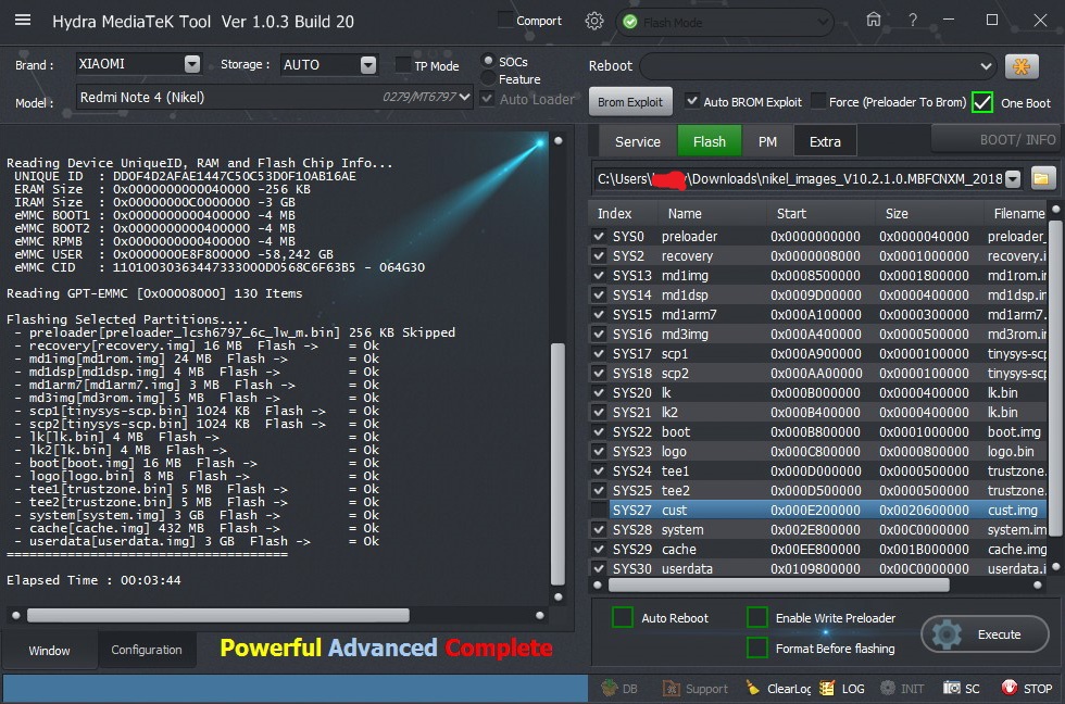

Xiaomi Redmi Note 4 (Nikel) successfully flashed by Hydra Tool
1. Run Hydra MTK Module and Sosc.
2. Choose Brand and Module.
3. Go to "Flash" Tab.
4. Choose Flash file and its location.
5. Click on "Execute"
6. connect device to the computer with USB Data cable
7. Wait until the process is completed.Screen Short:
BRBrand : XIAOMI Model : Redmi Note 4 (Nikel) Connection : Flash Mode
How To Boot : Power off phone
* BROM Mode : Press VOL + or Press VOL -+
Port Identification :Flashmode Preloader
FriendlyName :MediaTek PreLoader USB VCOM (Android) (COM12)
SymbolicName :\??\USB#VID_0E8D&PID_2000#5&d2368d0&0&4#{a5dcbf10-6530-11d2-901f-00c04fb951ed}
Driver Ver :01/22/2016,3.2
UNIQUE ID : DD0F4D2AFAE1447C50C53D0F10AB16AE
eMMC USER : 0x0000000E8F800000 -58,242 GB
eMMC CID : 11010030363447333000D0568C6F63B5 - 064G30
- preloader[preloader_lcsh6797_6c_lw_m.bin] 256 KB Skipped
- recovery[recovery.img] 16 MB Flash -> = Ok
- md1img[md1rom.img] 24 MB Flash -> = Ok
- md1dsp[md1dsp.img] 4 MB Flash -> = Ok
- md1arm7[md1arm7.img] 3 MB Flash -> = Ok
- md3img[md3rom.img] 5 MB Flash -> = Ok
- scp1[tinysys-scp.bin] 1024 KB Flash -> = Ok
- scp2[tinysys-scp.bin] 1024 KB Flash -> = Ok
- lk[lk.bin] 4 MB Flash -> = Ok
- lk2[lk.bin] 4 MB Flash -> = Ok
- boot[boot.img] 16 MB Flash -> = Ok
- logo[logo.bin] 8 MB Flash -> = Ok
- tee1[trustzone.bin] 5 MB Flash -> = Ok
- tee2[trustzone.bin] 5 MB Flash -> = Ok
- system[system.img] 3 GB Flash -> = Ok
- cache[cache.img] 432 MB Flash -> = Ok
- userdata[userdata.img] 3 GB Flash -> = Ok
Elapsed Time : 00:03:44
