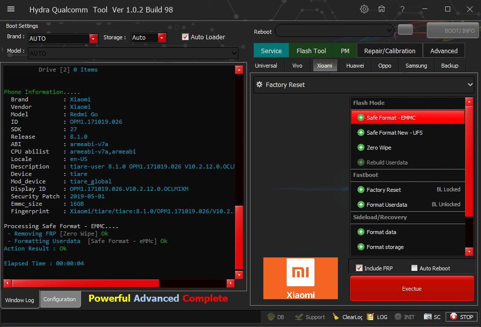

Xiaomi Redmi Go zero wipe FRP successfully done by Hydra Tool
1. Run Hydra Qualcomm module
2. Select Brand and Model
3. Go to Service-->Xiaomi
4. Choose "Factory Reset" from drop down menu.
5. Choose "Safe Format EMMC" from flash mode.
6. Choose "Include FRP" just above "Execute" button.
7. Click on "8. Execute "

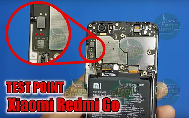

8. Connect Test Point (TP) from device board
(For test point, please google it.)
9.connect the device to the computer with data cable
10. wait until the process is completed.

Test Point:
