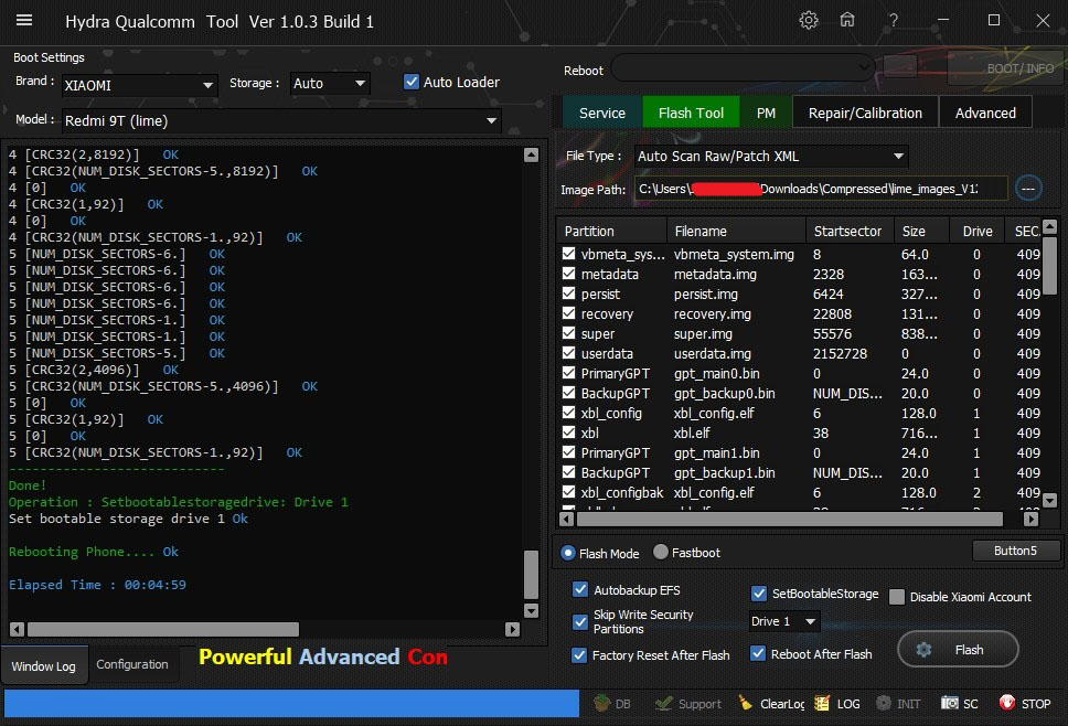

Xiaomi Redmi 9T (Lime) Flashed successfully done by Hydra Tool
1. Run Hydra Qualcomm.
2. Choose Brand and Module.
3. Go to "Flash" Tab.
4. Choose Flash file and its location.
5. Dissemble device and find its test point
6. Click on "Execute"
7. Connect test points with twiser or short them.
8. Connect the computer to the USB data cable
9. Wait until the process is complete.
