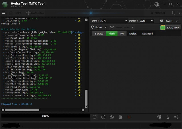

Xiaomi Redmi 9A Flashing done with Hydra Tool
[B]                  MTK Flash Function...

Write Selected Partitions..
- preloader(preloader_k62v1_64_bsp.bin), 251,465 KB[Erasing...Ok]  Status  :C0010001 Error= Failed
- recovery(recovery.img), 64 MB                       = Ok
- cust(cust.img), 25 Bytes                            = Ok
- vbmeta_system(vbmeta_system.img), 2 KB              = Ok
- vbmeta_vendor(vbmeta_vendor.img), 2 KB              = Ok
- efuse(efuse.img), 512 Bytes                         = Ok
- md1img(md1img-verified.img), 57,878 MB              = Ok
- spmfw(spmfw-verified.img), 62,578 KB                = Ok
- scp1(scp-verified.img), 602,438 KB                  = Ok
- scp2(scp-verified.img), 602,438 KB                  = Ok
- sspm_1(sspm-verified.img), 423,063 KB               = Ok
- sspm_2(sspm-verified.img), 423,063 KB               = Ok
- lk(lk-verified.img), 1,321 MB                       = Ok
- lk2(lk-verified.img), 1,321 MB                      = Ok
- boot(boot.img), 64 MB                               = Ok
- logo(logo-verified.bin), 2,87 MB                    = Ok
- dtbo(dtbo-verified.img), 145,188 KB                 = Ok
- tee1(tee-verified.img), 2,508 MB                    = Ok
- tee2(tee-verified.img), 2,508 MB                    = Ok
- super(super.img), 1,268 GB                          = Ok
- vbmeta(vbmeta.img), 4 KB                            = Ok
- cache(cache.img), 176,191 KB                        = Ok
- userdata(userdata.img), 248,309 KB                  = Ok
Elapsed Time : 00:02:19
