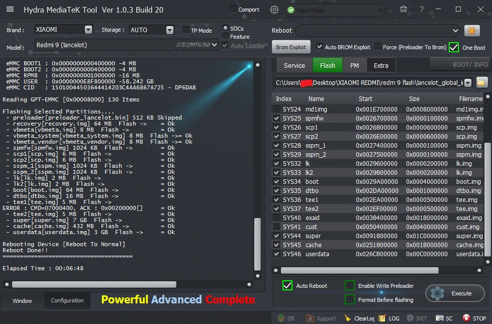

Xiaomi Redmi 9 (lancelot) successfully Flashed by Hydra Tool
1. Run Hydra MTK Module and Sosc.
2. Choose Brand and Module.
3. Go to "Flash" Tab.
4. Choose Flash file and its location.
5. Click on "Execute"
6. connect device to the computer with USB Data cable
7. Wait until the process is completed.
BRBrand : XIAOMI Model : Redmi 9 (lancelot) Connection : Flash Mode
How To Boot : Power off phone
* BROM Mode : Press VOL + or Press VOL -+
FriendlyName :MediaTek USB Port (COM10)
SymbolicName :\??\USB#VID_0E8D&PID_0003#6&1ab5e341&0&3#{a5dcbf10-6530-11d2-901f-00c04fb951ed}
Driver Ver :01/22/2016,3.2
Handshaking...Ok
Identifying Hardware ID.....
BROM CPUID : 0707MT6768[6768]
getMTKPayloadExploit : 0707
#Executing Exploit..
#SUCCESS..
Handshaking...Ok
FUSEID : 00000000
SECURE VERSION : 00
BL VERSION : FE
BR Secured : E0
Preparing Download Agent..
DA : MT6768_Xiaomi_New.bin
Ver : MTK_AllInOne_DA_v3.3001.2020/07/07.10:10_513994
Init : Loader [1]
Sending : Accepted
Identifying Protocol...
Protocol : New
Synchronization...SYNC
Mode : brom
Preloader Initialization...
Parsing preloader_lancelot.bin
Init : Accepted
Execute Secondary Loader
Init : Loader [2]
Executing : SYNC
UNIQUE ID : 1B15FFB812C2CC4DA358CD1656FDCDE2
eMMC CID : 15010044503644414203C4AA6867A725 - DP6DAB
DA Speed : high-speed
Autobackup Partitions
-> Renaming Preloader.... preloader_lancelot.bin
Creating Scatter file... C:\Hydra Tool\\Backup\Auto\0707__043021195125\MT6768_Android_scatter.txt
-frp[0x05508000]1024 KB ->frp.bin...Ok
-nvdata[0x0C4A2000]64 MB ->nvdata.bin...Ok
-persist[0x104A2000]48 MB ->persist.bin...Ok
-nvram[0x19F80000]64 MB ->nvram.bin...Ok
Done!!!
- preloader[preloader_lancelot.bin] 512 KB Skipped
- recovery[recovery.img] 64 MB Flash -> = Ok
- vbmeta[vbmeta.img] 8 MB Flash -> = Ok
- vbmeta_system[vbmeta_system.img] 8 MB Flash ->= Ok
- vbmeta_vendor[vbmeta_vendor.img] 8 MB Flash ->= Ok
- spmfw[spmfw.img] 1024 KB Flash -> = Ok
- scp1[scp.img] 6 MB Flash -> = Ok
- scp2[scp.img] 6 MB Flash -> = Ok
- sspm_1[sspm.img] 1024 KB Flash -> = Ok
- sspm_2[sspm.img] 1024 KB Flash -> = Ok
- lk[lk.img] 2 MB Flash -> = Ok
- lk2[lk.img] 2 MB Flash -> = Ok
- boot[boot.img] 64 MB Flash -> = Ok
- dtbo[dtbo.img] 16 MB Flash -> = Ok
- tee1[tee.img] 5 MB Flash ->
ERROR : CMD=07000400, ACK : 0x00200000[] = Ok
- tee2[tee.img] 5 MB Flash -> = Ok
- super[super.img] 7 GB Flash -> = Ok
- cache[cache.img] 432 MB Flash -> = Ok
- userdata[userdata.img] 3 GB Flash -> = Ok
Reboot Done!!
Elapsed Time : 00:06:48
