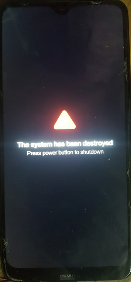

System Crashed Screen Short:
You have to follow two Steps to repair this device:
1. Flash the device using EDL Mode
2. Format factory reset EMMC using EDL Mode

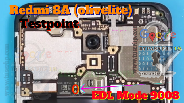

Test Point Screen Short:

8. Short TEST POINT using tuiser or join two point with any tool
Note: You need disassemble device (cellphone) for this. Use google
search to find the Test Point Picture.

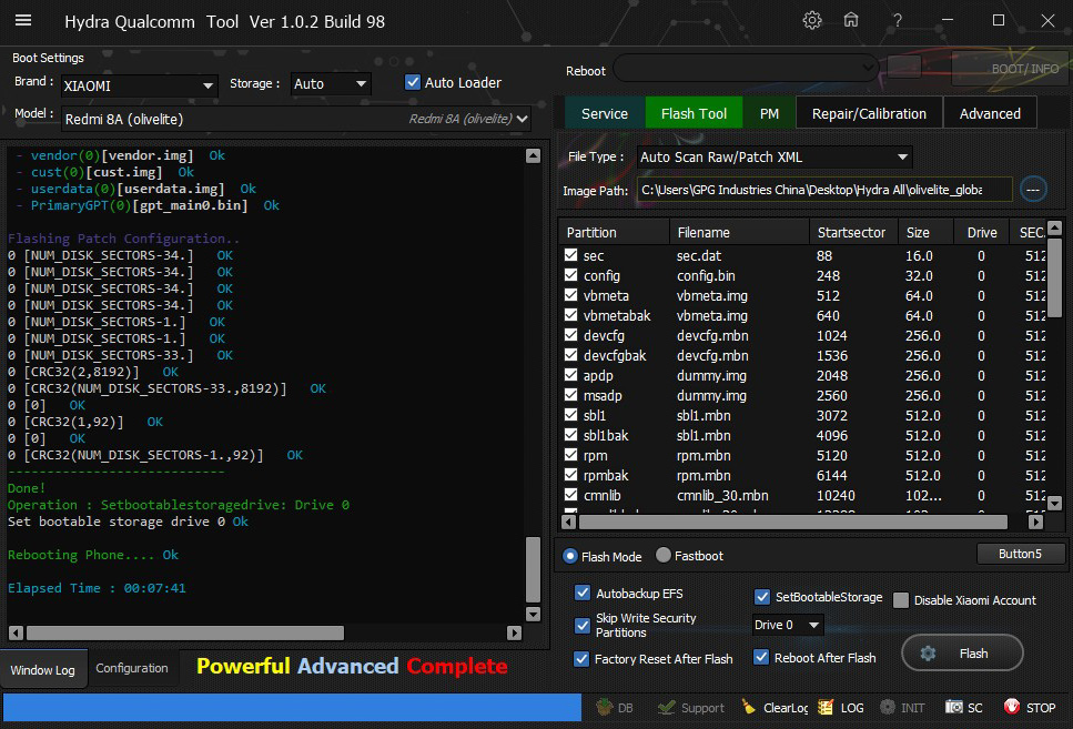

Flashing Screen Short:
Flashing Logs:
FriendlyName :
SymbolicName :\??\USB#VID_05C6&PID_9008#5&a713703&2&1#{a5dcbf10-6530-11d2-901f-00c04fb951ed}
Getting device info......
Serial No.: 0xD8FC0B44
HW_ID : 000BF0E100720000
MSM ID : 0x000BF0E1, SDM439-Qualcomm Snapdragon 439
MODEL_ID : 0x0000
OEM_ID : 0x0072 - XIAOMI
PBL Ver : 00000001
PK HASH : 57158eaf1814d78fd2b3105ece4db18a817a08ac664a5782a925f3ff8403d39a
Firehose Loader[Xiaomi_Redmi_8_Olive.mbn]
Header Type : OLD
TargetMSM : 8937
Tag : _auth_peek
Version : 3
Code_size : 320
Signature_size : 256
fhVendor : XIAOMI
Vendor : XIAOMI
OEM_ID : 0072
MODEL_ID : 0000
SW_ID : 0000000100000003
APP_ID :
pk_hash : 57158eaf1814d78fd2b3105ece4db18a817a08ac664a5782a925f3ff8403d39a
OEM_VERSION : c4-miui-ota-bd104.bj
IMAGE_VARIANT : FAADANAZA
QC_VERSION : BOOT.BF.3.3.2-00073
SaharaBoot... Ok
Sending .......................Ok
Connecting to Firehose...
Ping... Ok
Configuration.
Signature Request -> bob[0kY3bzcriDkLyEetYP-1Siodn3I]
Signature @256bytes Authentication.... Accepted......
Identifying Chip....
Ok
Chip Configuration :
MemoryName : eMMC
MaxXMLSizeInBytes : 4096
TargetName : 8937
Version : 1
*** STORAGE DEVICE INFO ***
Memory Type : eMMC
Block Size in Bytes : 512
Page Size : 512
Manufacturer ID : 21
Serial Number : 529567902
Firmware Version : 4
Product Name : QD63MB
Physical Partitions : 3
Total Logical Blocks:
Drive [0] 61071360[29.121 GB]
Drive [1] 8192[4 MB]
Drive [2] 8192[4 MB]
Protocol : Universal
Running : Ok
Phone Information......
Brand : Xiaomi
Vendor : Xiaomi
Model : Redmi 8A
SDK : 28
Release : 9
ABI : armeabi-v7a
Locale : en-GB
Description : olivelite-user 9 PKQ1.190319.001 V11.0.3.0.PCPINXM release-keys
Miui Ver : V11
Device : olivelite
Mod_device : olivelite_in_global
Display ID : ZQL2116-olivelite-build-20191119010027
Security Patch : 2019-11-01
Emmc_size : 16GB
Fingerprint : Xiaomi/olivelite/olivelite:9/PKQ1.190319.001/V11.0.3.0.PCPINXM:user/release-keys
Reading GPT[3]
Drive [0] 64 Items
Drive [1] 0 Items
Drive [2] 0 Items
Backup Security partitions...
Reading Security Items....
> modemst1
> modemst2
> fsg
> fsc
C:\Program Files\HydraTool\Backup\Security_Backup\Redmi 8A__9_Security_071321180229.sec
Backup Security Success....
- sec(0)[sec.dat] Skipped
- config(0)[config.bin] Ok
- vbmeta(0)[vbmeta.img] Ok
- vbmetabak(0)[vbmeta.img] Ok
- devcfg(0)[devcfg.mbn] Ok
- devcfgbak(0)[devcfg.mbn] Ok
- apdp(0)[dummy.img] Ok
- msadp(0)[dummy.img] Ok
- sbl1(0)[sbl1.mbn] Ok
- sbl1bak(0)[sbl1.mbn] Ok
- rpm(0)[rpm.mbn] Ok
- rpmbak(0)[rpm.mbn] Ok
- cmnlib(0)[cmnlib_30.mbn] Ok
- cmnlibbak(0)[cmnlib_30.mbn] Ok
- cmnlib64(0)[cmnlib64_30.mbn] Ok
- cmnlib64bak(0)[cmnlib64_30.mbn] Ok
- keymaster(0)[km4.mbn] Ok
- keymasterbak(0)[km4.mbn] Ok
- misc(0)[misc.img] Ok
- tz(0)[tz.mbn] Ok
- tzbak(0)[tz.mbn] Ok
- dtbo(0)[dtbo.img] Ok
- dtbobak(0)[dtbo.img] Ok
- splash(0)[splash.img] Ok
- dsp(0)[adspso.bin] Ok
- dspbak(0)[adspso.bin] Ok
- persist(0)[persist.img] Ok
- mdtp(0)[mdtp.img] Ok
- mdtpbak(0)[mdtp.img] Ok
- boot(0)[boot.img] Ok
- cache(0)[cache.img] Ok
- modem(0)[NON-HLOS.bin] Ok
- system(0)[system.img] Ok
- vendor(0)[vendor.img] Ok
- cust(0)[cust.img] Ok
0 [NUM_DISK_SECTORS-34.] OK
0 [NUM_DISK_SECTORS-1.] OK
0 [NUM_DISK_SECTORS-33.] OK
0 [CRC32(2,8192)] OK
0 [CRC32(NUM_DISK_SECTORS-33.,8192)] OK
0 [0] OK
0 [CRC32(1,92)] OK
0 [0] OK
Done!
Rebooting Phone.... Ok
Elapsed Time : 00:07:41

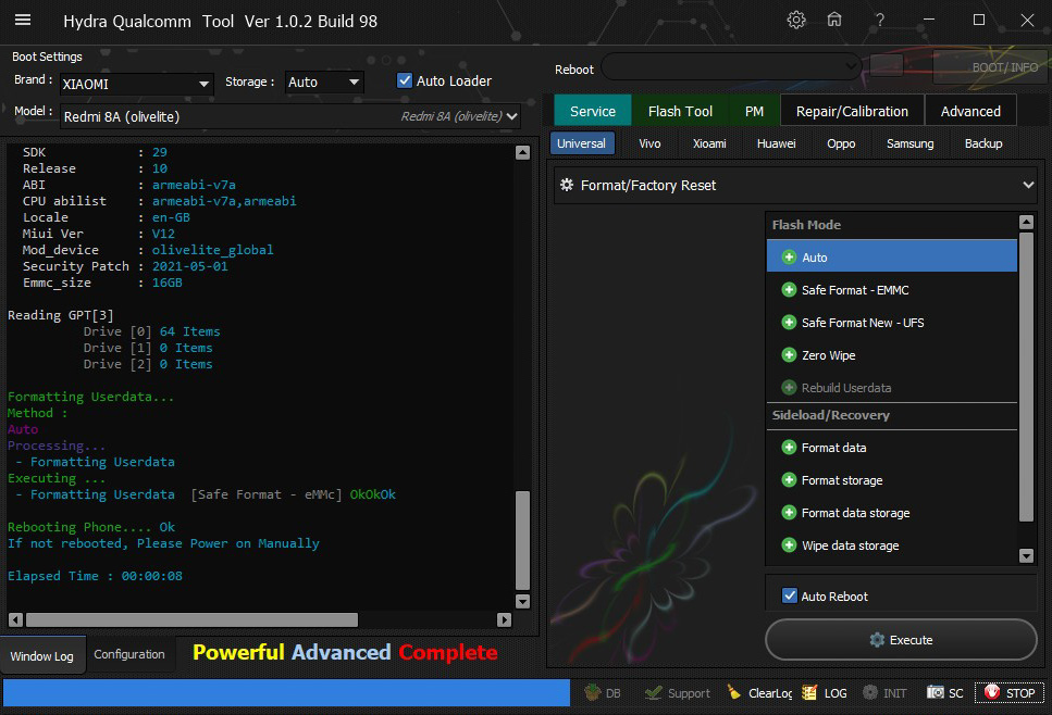

# Formatting Guide
1. Run Hydra Qualcomm Tool.
2.Choose "Module" and "Brand" or "Auto"
3. Go to "Service"--> "Universal" tab
4. Choose "Format / Factory Reset" from drop down menu.
5. Choose "Auto" from flash mode.
6. Tick “Autoback EFS, “Skip write security partitions”, “SetBootableStorage”,
“Skip with security partition”, “Faxtory Reset After Flash” or one or two
you like to do.
7 Click on "Execute"
9. Connect Device with Computer using USB Data Cable
10. Connect Battery.
11. Wait until the flashing process is complete.
12. Done
Formatted Screen Short:
Formatted Logs:
PreOperation Configuration
Brand : XIAOMI Model : Redmi 8A (olivelite) Storage : Auto
Loader: Xiaomi_Redmi_8_Olive.mbn
Port : Auto
FriendlyName :Qualcomm HS-USB QDLoader 9008 (COM4)
MODEL_ID : 0x0000
PBL Ver : 00000001
Header Type : OLD
TargetMSM : 8937
Tag : _auth_peek
Version : 3
Code_size : 320
fhVendor : XIAOMI
Vendor : XIAOMI
OEM_ID : 0072
MODEL_ID : 0000
APP_ID :
SaharaBoot... Ok
Ping... Ok
Configuration.
Signature Request -> bob[TRMtlbcphGwyIPq5zh03BijrkbA]
Ok
MemoryName : eMMC
TargetName : 8937
Version : 1
Memory Type : eMMC
Page Size : 512
Running : Ok
Vendor : Xiaomi
SDK : 29
Release : 10
ABI : armeabi-v7a
Locale : en-GB
Miui Ver : V12
Mod_device : olivelite_global
Security Patch : 2021-05-01
Emmc_size : 16GB
Reading GPT[3]
Drive [0] 64 Items
Drive [1] 0 Items
Drive [2] 0 Items
Formatting Userdata...
Method :
Auto
Processing...
- Formatting Userdata
Executing ...
- Formatting Userdata [Safe Format - eMMc] OkOkOk
If not rebooted, Please Power on Manually
Elapsed Time : 00:00:08
