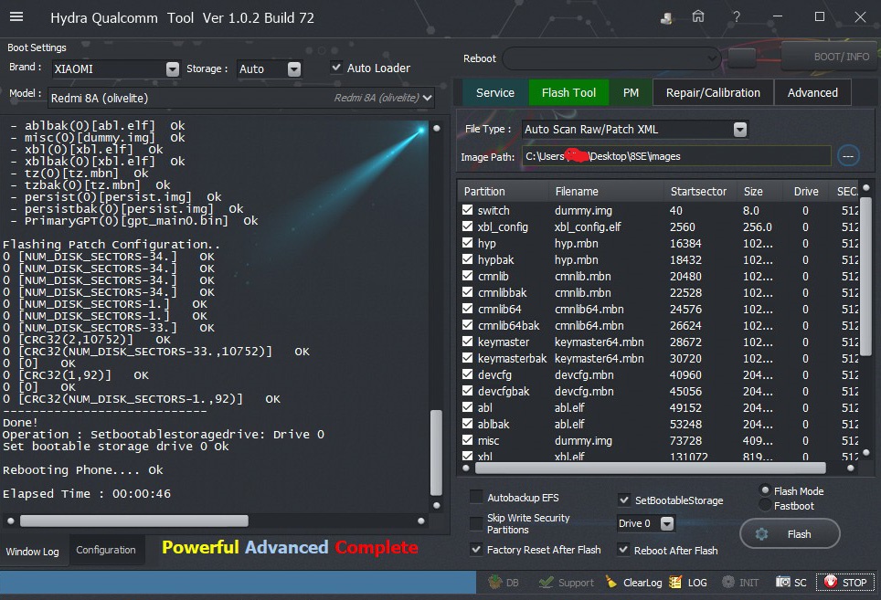

Hydra Xiaomi Redmi 8A Olivelite successfully flashed by Hydra Tool
546
FriendlyName :Qualcomm HS-USB QDLoader 9008 (COM20)
SymbolicName :\??\USB#VID_05C6&PID_9008#5&521a615&0&5#{a5dcbf10-6530-11d2-901f-00c04fb951ed}
Getting device info......
Serial No.: 0xFE6BA513
MSM ID : 0x000BF0E1, SDM439-Qualcomm Snapdragon 439
PBL Ver : 00000000
Firehose Loader[Xiaomi_Redmi_8_Olive.mbn]
SaharaBoot... Ok
Sending .......................Ok
Connecting to Firehose...
Ping... Ok
Configuration.
Signature Request -> bob[nlwer
- Hydra Is Online
Signature @256bytes Authentication.... Accepted......
Identifying Chip....
Ok
Chip Configuration :
MemoryName : eMMC
MaxXMLSizeInBytes : 4096
TargetName : 8937
Version : 1
*** STORAGE DEVICE INFO ***
Memory Type : eMMC
Block Size in Bytes : 512
Page Size : 512
Manufacturer ID : 19
Serial Number : 327510852
Firmware Version : 4
Product Name : S0J9N8
Physical Partitions : 3
Total Logical Blocks:
Drive [1] 8192[4 MB]
Drive [2] 8192[4 MB]
Protocol : Universal
Running : Ok
Phone Information......
Brand : Xiaomi
Vendor : Xiaomi
Model : Redmi 8A
SDK : 28
Release : 9
ABI : armeabi-v7a
Locale : zh-CN
Description : olivelite-user 9 PKQ1.190319.001 V11.0.7.0.PCPCNXM release-keys
Miui Ver : V11
Device : olivelite
Display ID : ZQL2116-olivelite-build-20200111233623
Security Patch : 2019-12-01
Emmc_size : 16GB
Fingerprint : Xiaomi/olivelite/olivelite:9/PKQ1.190319.001/V11.0.7.0.PCPCNXM:user/release-keys
- switch(0)[dummy.img] Ok
- xbl_config(0)[xbl_config.elf] Ok
- hyp(0)[hyp.mbn] Ok
- hypbak(0)[hyp.mbn] Ok
- cmnlib(0)[cmnlib.mbn] Ok
- cmnlibbak(0)[cmnlib.mbn] Ok
- cmnlib64(0)[cmnlib64.mbn] Ok
- cmnlib64bak(0)[cmnlib64.mbn] Ok
- keymaster(0)[keymaster64.mbn] Ok
- keymasterbak(0)[keymaster64.mbn] Ok
- devcfg(0)[devcfg.mbn] Ok
- devcfgbak(0)[devcfg.mbn] Ok
- abl(0)[abl.elf] Ok
- ablbak(0)[abl.elf] Ok
- misc(0)[dummy.img] Ok
- xbl(0)[xbl.elf] Ok
- xblbak(0)[xbl.elf] Ok
- tz(0)[tz.mbn] Ok
- tzbak(0)[tz.mbn] Ok
- persist(0)[persist.img] Ok
- persistbak(0)[persist.img] Ok
0 [NUM_DISK_SECTORS-34.] OK
0 [NUM_DISK_SECTORS-1.] OK
0 [NUM_DISK_SECTORS-33.] OK
0 [CRC32(2,10752)] OK
0 [CRC32(NUM_DISK_SECTORS-33.,10752)] OK
0 [0] OK
0 [CRC32(1,92)] OK
0 [0] OK
Done!
Rebooting Phone.... Ok
Elapsed Time : 00:00:46
