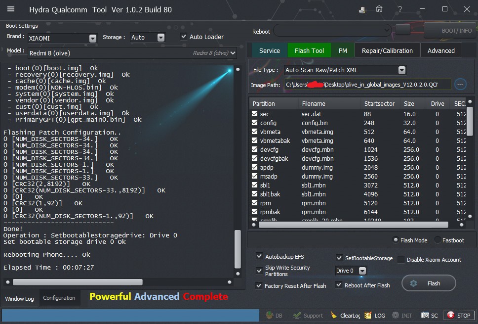

Xiaomi Redmi 8 (Olive) successfully flashed by Hydra Tool
1. Run Hydra Qualcomm Module and Sosc.
2. Choose Brand and Module.
3. Go to "Flash Tab " Tab.
4. Choose Flash file and its location.
5. Click on "Execute"
6. connect device to the computer with USB Data cable
7. Wait until the process is completed.
FriendlyName :Qualcomm HS-USB QDLoader 9008 (COM17)
SymbolicName :\??\USB#VID_05C6&PID_9008#6&2de80233&0&4#{a5dcbf10-6530-11d2-901f-00c04fb951ed}
Getting device info......
Serial No.: 0x4E96EC5D
MSM ID : 0x000BF0E1, SDM439-Qualcomm Snapdragon 439
PBL Ver : 00000000
Firehose Loader[Xiaomi_Redmi_8_Olive.mbn]
SaharaBoot... Ok
Sending .......................Ok
Connecting to Firehose...
Ping... Ok
Configuration.
Signature Request -> bob[Rkj0xUwI1U6mkessfBNPQFWqbA-]
- Hydra Is Online
Signature @256bytes Authentication.... Accepted......
Identifying Chip....
Ok
Chip Configuration :
MemoryName : eMMC
MaxXMLSizeInBytes : 4096
TargetName : 8937
Version : 1
*** STORAGE DEVICE INFO ***
Memory Type : eMMC
Block Size in Bytes : 512
Page Size : 512
Manufacturer ID : 19
Serial Number : 543355609
Firmware Version : 4
Product Name : S0J9N8
Physical Partitions : 3
Total Logical Blocks:
Drive [0] 122142720[58,242 GB]
Drive [1] 8192[4 MB]
Drive [2] 8192[4 MB]
Protocol : Universal
Running : Ok
Phone Information......
Vendor : Xiaomi
SDK : 29
Release : 10
ABI : arm64-v8a
Locale : en-GB
Miui Ver : V12
Mod_device : olive_global
Security Patch : 2021-03-01
Emmc_size : 16GB
Reading GPT[3]
Drive [0] 64 Items
Drive [1] 0 Items
Drive [2] 0 Items
Backup Security partitions...
Reading Security Items....
> modemst1
> modemst2
> fsg
C:\Hydra Tool\Backup\Security_Backup\__10_Security_050121025609.sec
Backup Security Success....
- sec(0)[sec.dat] Skipped
- config(0)[config.bin] Skipped
- vbmeta(0)[vbmeta.img] Ok
- vbmetabak(0)[vbmeta.img] Ok
- devcfg(0)[devcfg.mbn] Ok
- devcfgbak(0)[devcfg.mbn] Ok
- apdp(0)[dummy.img] Ok
- msadp(0)[dummy.img] Ok
- sbl1(0)[sbl1.mbn] Ok
- sbl1bak(0)[sbl1.mbn] Ok
- rpm(0)[rpm.mbn] Ok
- rpmbak(0)[rpm.mbn] Ok
- cmnlib(0)[cmnlib_30.mbn] Ok
- cmnlibbak(0)[cmnlib_30.mbn] Ok
- cmnlib64(0)[cmnlib64_30.mbn] Ok
- cmnlib64bak(0)[cmnlib64_30.mbn] Ok
- keymaster(0)[km4.mbn] Ok
- keymasterbak(0)[km4.mbn] Ok
- misc(0)[misc.img] Ok
- tz(0)[tz.mbn] Ok
- tzbak(0)[tz.mbn] Ok
- dtbo(0)[dtbo.img] Ok
- dtbobak(0)[dtbo.img] Ok
- splash(0)[splash.img] Ok
- dsp(0)[adspso.bin] Ok
- dspbak(0)[adspso.bin] Ok
- mdtp(0)[mdtp.img] Ok
- mdtpbak(0)[mdtp.img] Ok
- boot(0)[boot.img] Ok
- cache(0)[cache.img] Ok
- modem(0)[NON-HLOS.bin] Ok
- system(0)[system.img] Ok
- vendor(0)[vendor.img] Ok
- cust(0)[cust.img] Ok
0 [NUM_DISK_SECTORS-34.] OK
0 [NUM_DISK_SECTORS-1.] OK
0 [NUM_DISK_SECTORS-33.] OK
0 [CRC32(2,8192)] OK
0 [CRC32(NUM_DISK_SECTORS-33.,8192)] OK
0 [0] OK
0 [CRC32(1,92)] OK
0 [0] OK
Done!
Rebooting Phone.... Ok
Elapsed Time : 00:07:27​
