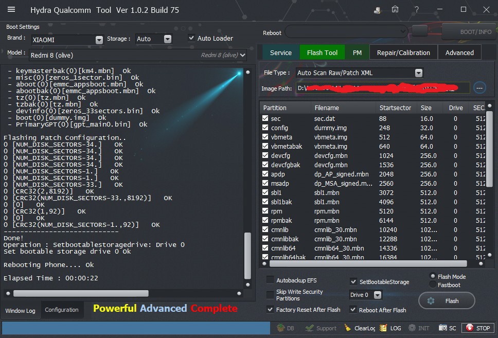

Xiaomi Redmi 8 Olive Successfully Flashed by Hydra Tool
FriendlyName :Qualcomm HS-USB QDLoader 9008 (COM3)
SymbolicName :\??\USB#VID_05C6&PID_9008#6&375385d2&0&6#{a5dcbf10-6530-11d2-901f-00c04fb951ed}
Driver Ver :02/05/2018,3.0.0.0
Getting device info......
Serial No.: 0x98113811
MSM ID : 0x000BF0E1, SDM439-Qualcomm Snapdragon 439
PBL Ver : 00000000
Firehose Loader[Xiaomi_Redmi_8_Olive.mbn]
SaharaBoot... Ok
Sending .......................Ok
Connecting to Firehose...
Ping... Ok
Configuration.
Signature Request -> bob[qp4
- Hydra Is Online
Signature @256bytes Authentication.... Accepted......
Identifying Chip....
Ok
Chip Configuration :
MemoryName : eMMC
MaxXMLSizeInBytes : 4096
TargetName : 8937
Version : 1
*** STORAGE DEVICE INFO ***
Memory Type : eMMC
Block Size in Bytes : 512
Page Size : 512
Manufacturer ID : 21
Serial Number : 344197024
Firmware Version : 1
Product Name : GD6BMB
Physical Partitions : 3
Total Logical Blocks:
Drive [0] 61071360[29.121 GB]
Drive [1] 8192[4 MB]
Drive [2] 8192[4 MB]
Protocol : Universal
Running : Ok
Phone Information......
Brand : Xiaomi
Vendor : Xiaomi
Model : Redmi 8
SDK : 28
Release : 9
ABI : arm64-v8a
Locale : zh-CN
Description : olive-user 9 PKQ1.190319.001 V10.3.6.0.PCNCNXM release-keys
Miui Ver : V10
Device : olive
Display ID : ZQL2115-olive-build-20191010005234
Security Patch : 2019-09-01
Emmc_size : 16GB
Fingerprint : Xiaomi/olive/olive:9/PKQ1.190319.001/V10.3.6.0.PCNCNXM:user/release-keys
- sec(0)[sec.dat] Ok
- config(0)[dummy.img] Ok
- vbmeta(0)[vbmeta.img] Ok
- vbmetabak(0)[vbmeta.img] Ok
- devcfg(0)[devcfg.mbn] Ok
- devcfgbak(0)[devcfg.mbn] Ok
- apdp(0)[dp_AP_signed.mbn] Ok
- msadp(0)[dp_MSA_signed.mbn] Ok
- sbl1(0)[sbl1.mbn] Ok
- sbl1bak(0)[sbl1.mbn] Ok
- rpm(0)[rpm.mbn] Ok
- rpmbak(0)[rpm.mbn] Ok
- cmnlib(0)[cmnlib_30.mbn] Ok
- cmnlibbak(0)[cmnlib_30.mbn] Ok
- cmnlib64(0)[cmnlib64_30.mbn] Ok
- cmnlib64bak(0)[cmnlib64_30.mbn] Ok
- keymaster(0)[km4.mbn] Ok
- keymasterbak(0)[km4.mbn] Ok
- misc(0)[zeros_1sector.bin] Ok
- tz(0)[tz.mbn] Ok
- tzbak(0)[tz.mbn] Ok
- devinfo(0)[zeros_33sectors.bin] Ok
- boot(0)[dummy.img] Ok
0 [NUM_DISK_SECTORS-34.] OK
0 [NUM_DISK_SECTORS-1.] OK
0 [NUM_DISK_SECTORS-33.] OK
0 [CRC32(2,8192)] OK
0 [CRC32(NUM_DISK_SECTORS-33.,8192)] OK
0 [0] OK
0 [CRC32(1,92)] OK
0 [0] OK
Done!
Rebooting Phone.... Ok
Elapsed Time : 00:00:22
