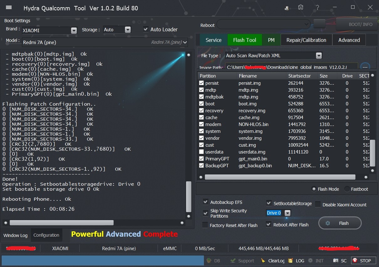

Xiaomi Redmi 7A Pine ELD Flashing successsfully done by Hydra Tool
1. Run Hydra Qualcomm Module and Sosc.
2. Choose Brand and Module.
3. Go to "Flash Tool" Tab.
4. Choose Flash file and its location.
5. Click on "Flash"
6. connect device to the computer with USB Data cable
(Device need to disassemble and shourt two test point)
7. Wait until the process is completed.
5. Click on "Flash"
Screen Shorts
Logs

Done!
Rebooting Phone.... Ok
Elapsed Time : 00:08:26
