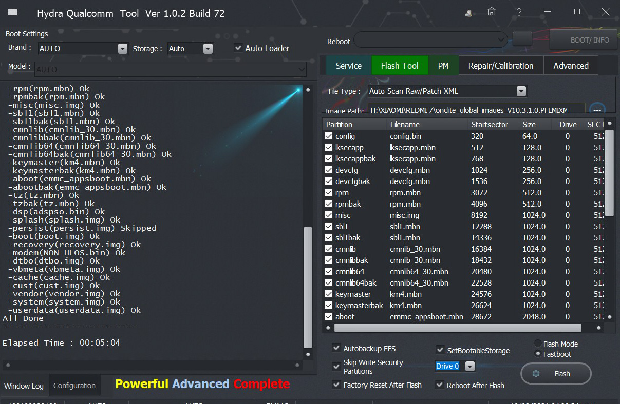

Hydra Xiaomi Redmi 7(Onclite) Successfully Flashed by Hydra Tool
546
Searching Device By Fastboot
Device Found...
Reading Information...version: 0.5
Product : onc
version : 0.5
Secure : yes
Device Info:
Device tampered: false
Device unlocked: true
Device critical unlocked: true
Charger screen enabled: true
Display panel:
Device Verity Mode: enforcing
Debug policy enable: false
Fastboot Flashing...
-config(config.bin) Skipped
-lksecapp(lksecapp.mbn) Ok
-lksecappbak(lksecapp.mbn) Ok
-devcfg(devcfg.mbn) Ok
-devcfgbak(devcfg.mbn) Ok
-rpm(rpm.mbn) Ok
-rpmbak(rpm.mbn) Ok
-misc(misc.img) Ok
-sbl1(sbl1.mbn) Ok
-sbl1bak(sbl1.mbn) Ok
-cmnlib(cmnlib_30.mbn) Ok
-cmnlibbak(cmnlib_30.mbn) Ok
-cmnlib64(cmnlib64_30.mbn) Ok
-cmnlib64bak(cmnlib64_30.mbn) Ok
-keymaster(km4.mbn) Ok
-keymasterbak(km4.mbn) Ok
-aboot(emmc_appsboot.mbn) Ok
-abootbak(emmc_appsboot.mbn) Ok
-tz(tz.mbn) Ok
-tzbak(tz.mbn) Ok
-dsp(adspso.bin) Ok
-splash(splash.img) Ok
-persist(persist.img) Skipped
-boot(boot.img) Ok
-recovery(recovery.img) Ok
-modem(NON-HLOS.bin) Ok
-dtbo(dtbo.img) Ok
-vbmeta(vbmeta.img) Ok
-cache(cache.img) Ok
-cust(cust.img) Ok
-vendor(vendor.img) Ok
-system(system.img) Ok
-userdata(userdata.img) Ok
All Done
Elapsed Time : 00:05:04
