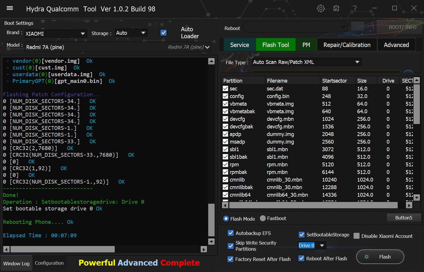

Xiaomi Redmi 7 A (Pine) Successfully flashed by Hydra Tool
1. Run Hydra Qualcomm Tool.
2.Choose "Module" and "Brand"
3. Go to "Flash" tab
4. Choose "File Type" and its location.
5. Choose "Flash Mode"
6. Tick “Autoback EFS, “Skip write security partitions”, “SetBootableStorage”, “Skip with security partition”, “Faxtory Reset After Flash” or one or two you like to do.
7 Click on "Execute"
8. Short TEST POINT using tuiser or join two point with any tool
Note: You need disassemble device (cellphone) for this. Use google search,
to find the Test Point Picture.
9. Connect Device with Computer using USB Data Cable
10. Wait until the flashing process is complete.
11. Done
