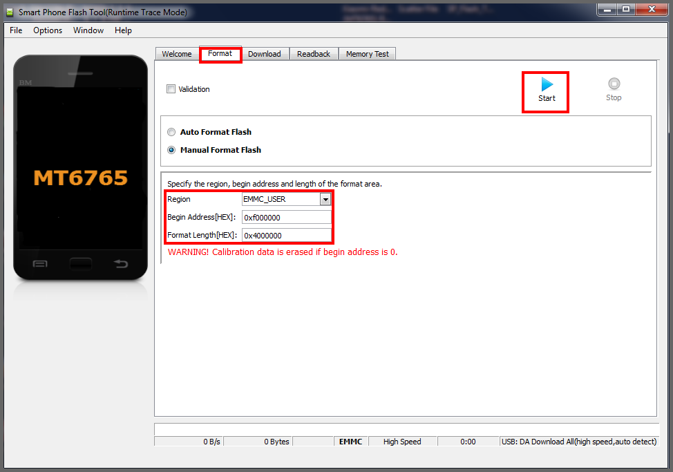

Procedure :
Download & Extract "Xiaomi-Redmi-6A (MT6765).rar"
Open Sp Flash Tool
Select the SCATTER file go to format TAB, select Manual Format Flash option & edit both address.
Region: eMMC_User
Begin Address[HEX]: 0xf000000
Format Length[HEX]: 0x4000000
Now click on START Button
Press Volume Down key and connect usb cable
Wait for finish
Done........

Procedure :
Open Sp Flash Tool
Region: eMMC_User
Wait for finish
Done........

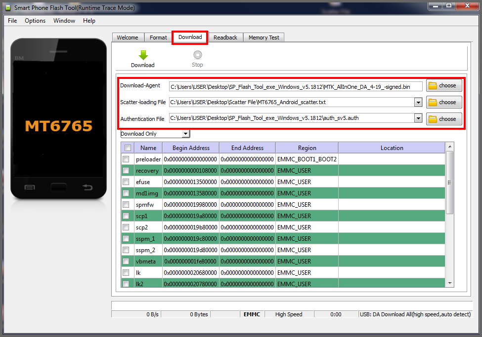

Need auth id pass?
