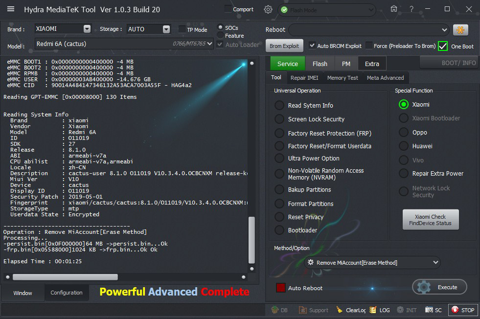

Xiaomi Redmi 6A (cactus) Mi Account removed with erased method
1. Run Hydra MTK Module, Select Brand and Model
2. Go to Service-->Tools-->Xioami
3. Choose "Remove Mi Account (Erase)Method" from Method / Option
4. Execute and connect the device to the computer
5. wait until the process is completed.

Operation : Remove MiAccount[Erase Method]
Processing...
-persist.bin[0x0F000000]64 MB ->persist.bin...Ok
-frp.bin[0x05588000]1024 KB ->frp.bin...Ok Ok
Elapsed Time : 00:01:25​
