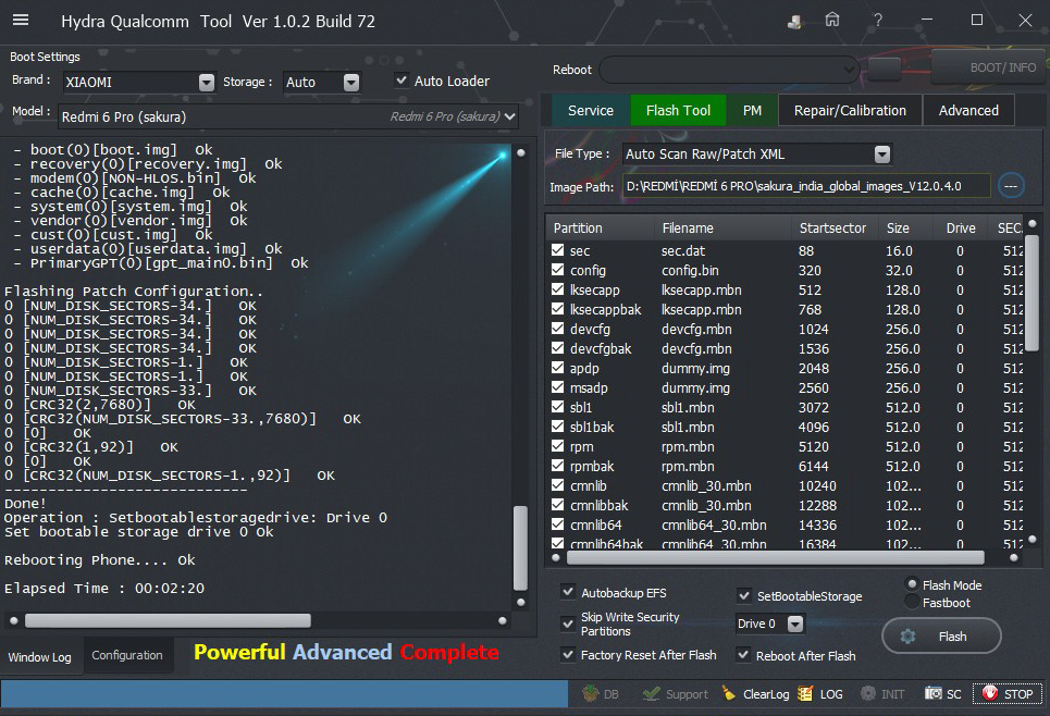

Hydra Xiaomi Redmi 6 Pro Flashing successfully done by Hydra Tool
546
FriendlyName :Qualcomm HS-USB QDLoader 9008 (COM13)
SymbolicName :\??\USB#VID_05C6&PID_9008#5&1f03ab54&0&5#{a5dcbf10-6530-11d2-901f-00c04fb951ed}
Getting device info......
Serial No.: 0x92F0A145
MSM ID : 0x000460E1, MSM8953-Qualcomm Snapdragon 625
PBL Ver : 00000000
Firehose Loader[Xiaomi_Remi 6 pro_Sakura_8953_ddr.mbn]
SaharaBoot... Ok
Sending ....................Ok
Connecting to Firehose...
Ping... Ok
Configuration.
Signature Request -> bob[oLBVZMWfEPYsymzgHfmNOjUNsmD]
- Hydra Is Online
Signature @256bytes Authentication.... Accepted......
Identifying Chip....
Ok
Chip Configuration :
MemoryName : eMMC
MaxXMLSizeInBytes : 4096
TargetName : 8953
Version : 1
*** STORAGE DEVICE INFO ***
Memory Type : eMMC
Block Size in Bytes : 512
Page Size : 512
Manufacturer ID : 144
Serial Number : 298171637
Firmware Version : 842018864
Product Name : hB8aP>
Physical Partitions : 3
Total Logical Blocks:
Drive [0] 61071360[29,121 GB]
Drive [1] 8192[4 MB]
Drive [2] 8192[4 MB]
Protocol : Universal
Running : Ok
Phone Information.....
Brand : xiaomi
Vendor : Xiaomi
Model : Redmi 6 Pro
SDK : 28
Release : 9
ABI : arm64-v8a
Locale : zh-CN
Description : sakura-user 9 PKQ1.180917.001 V12.0.1.0.PDICNXM release-keys
Miui Ver : V12
Device : sakura
Display ID : ZQL1715-sakura-build-20200728120204
Security Patch : 2020-07-01
Emmc_size : 16GB
Fingerprint : xiaomi/sakura/sakura:9/PKQ1.180917.001/V12.0.1.0.PDICNXM:user/release-keys
Reading GPT[3]
Drive [0] 60 Items
Drive [1] 0 Items
Drive [2] 0 Items
Backup Security partitions...
Reading Security Items....
> modemst1
> modemst2
> fsg
C:\Hydra Tool\Backup\Security_Backup\Redmi 6 Pro__9_Security_012521145003.sec
Backup Security Success....
- sec(0)[sec.dat] Skipped
- config(0)[config.bin] Skipped
- lksecapp(0)[lksecapp.mbn] Ok
- lksecappbak(0)[lksecapp.mbn] Ok
- devcfg(0)[devcfg.mbn] Ok
- devcfgbak(0)[devcfg.mbn] Ok
- apdp(0)[dummy.img] Ok
- msadp(0)[dummy.img] Ok
- sbl1(0)[sbl1.mbn] Ok
- sbl1bak(0)[sbl1.mbn] Ok
- rpm(0)[rpm.mbn] Ok
- rpmbak(0)[rpm.mbn] Ok
- cmnlib(0)[cmnlib_30.mbn] Ok
- cmnlibbak(0)[cmnlib_30.mbn] Ok
- cmnlib64(0)[cmnlib64_30.mbn] Ok
- cmnlib64bak(0)[cmnlib64_30.mbn] Ok
- keymaster(0)[keymaster64.mbn] Ok
- keymasterbak(0)[keymaster64.mbn] Ok
- misc(0)[misc.img] Ok
- tz(0)[tz.mbn] Ok
- tzbak(0)[tz.mbn] Ok
- splash(0)[splash.img] Ok
- dsp(0)[adspso.bin] Ok
- mdtp(0)[mdtp.img] Ok
- boot(0)[boot.img] Ok
- modem(0)[NON-HLOS.bin] Ok
- cache(0)[cache.img] Ok
- system(0)[system.img] Ok
- vendor(0)[vendor.img] Ok
- cust(0)[cust.img] Ok
0 [NUM_DISK_SECTORS-34.] OK
0 [NUM_DISK_SECTORS-1.] OK
0 [NUM_DISK_SECTORS-33.] OK
0 [CRC32(2,7680)] OK
0 [CRC32(NUM_DISK_SECTORS-33.,7680)] OK
0 [0] OK
0 [CRC32(1,92)] OK
0 [0] OK
Done!
Rebooting Phone.... Ok
Elapsed Time : 00:02:20
