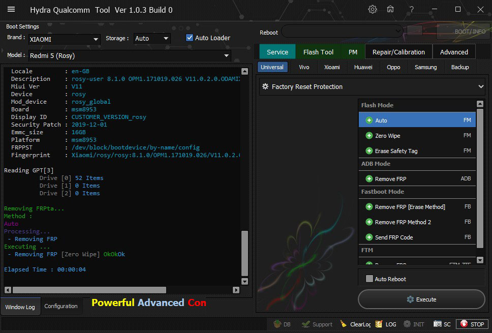

Xiaomi Redmi 5 (Rosy) FRP done using EDL mode and Test Point by Hydra Tool
1. Run Hydra Qualcomm Module and choose "Sosc"
2. Select Brand and Module
3. Go to Service-->Universal
4. Choose "Factory Reset Protection" drop down menu
5. Choose "Auto" using Flash Mode.
6. Dissemble device and find test points
7. Execute and connect the device to the computer with data cable
8. Short two test points using twiser or short them.
9. wait until the process is completed.
