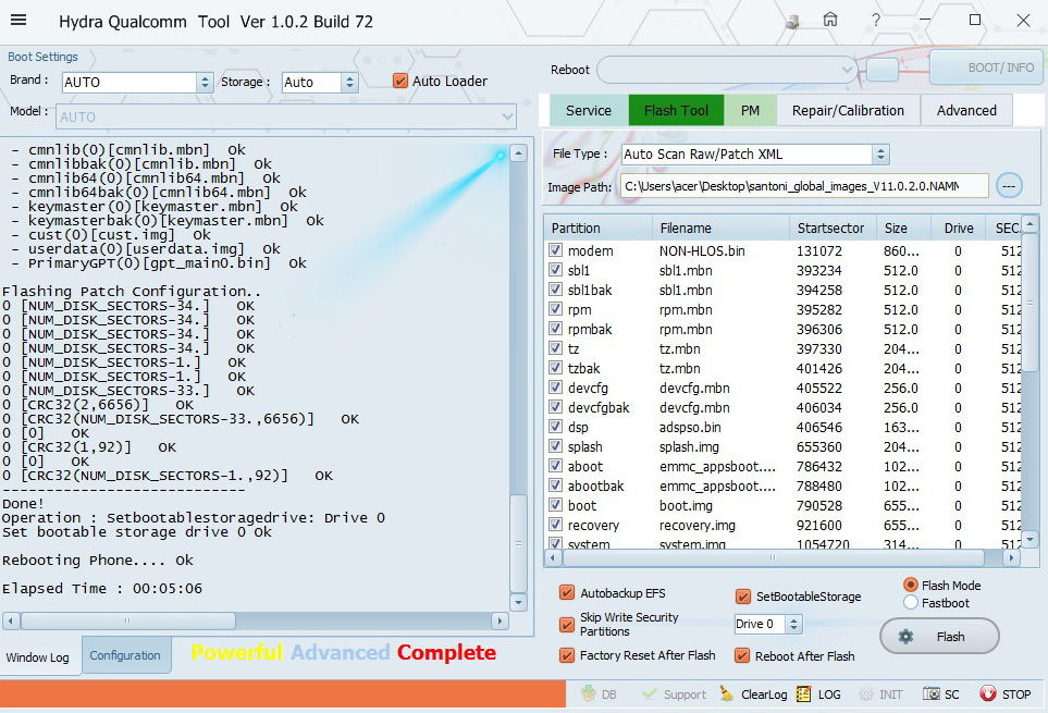

Hydra Xiaomi Redmi 4X successfully Flashed by Hydra Tool
546
FriendlyName :Qualcomm HS-USB QDLoader 9008 (COM3)
SymbolicName :\??\USB#VID_05C6&PID_9008#6&37369825&0&3#{a5dcbf10-6530-11d2-901f-00c04fb951ed}
Driver Ver :
Getting device info..Ok
Device MODE : Firehose
Connecting to Firehose...
Ping.. Ok
Configuration......
Identifying Chip....
Ok
Chip Configuration :
MemoryName : eMMC
MaxXMLSizeInBytes : 4096
TargetName : 8937
Version : 1
*** STORAGE DEVICE INFO ***
Memory Type : eMMC
Block Size in Bytes : 512
Page Size : 512
Manufacturer ID : 21
Serial Number : 1943066838
Firmware Version : 5
Product Name : RH64AB
Physical Partitions : 3
Total Logical Blocks:
Drive [1] 8192[4 MB]
Drive [2] 8192[4 MB]
Protocol : Universal
Running : Ok
Phone Information.....
Brand : Xiaomi
Vendor : Xiaomi
Model : Redmi 4X
SDK : 25
Release : 7.1.2
ABI : arm64-v8a
Locale : en-GB
Description : santoni-user 7.1.2 N2G47H V9.5.4.0.NAMMIFA release-keys
Miui Ver : V9
Device : santoni
Mod_device : santoni_global
Board : QC_Reference_Phone
Display ID : N2G47H
Security Patch : 2018-03-01
Emmc_size : 16GB
Platform : msm8937
Fingerprint : Xiaomi/santoni/santoni:7.1.2/N2G47H/V9.5.4.0.NAMMIFA:user/release-keys
Reading GPT[3]
Drive [0] 52 Items
Drive [1] 0 Items
Drive [2] 0 Items
Backup Security partitions...
Reading Security Items....
> modemst1
> modemst2
> fsg
D:\All Box Setup And Driver\Hydra\Hydra Tool\Backup\Security_Backup\Redmi 4X_QC_Reference_Phone_7.1.2_Security_012021124525.sec
Backup Security Success....
- modem(0)[NON-HLOS.bin] Ok
- sbl1(0)[sbl1.mbn] Ok
- sbl1bak(0)[sbl1.mbn] Ok
- rpm(0)[rpm.mbn] Ok
- rpmbak(0)[rpm.mbn] Ok
- tz(0)[tz.mbn] Ok
- tzbak(0)[tz.mbn] Ok
- devcfg(0)[devcfg.mbn] Ok
- devcfgbak(0)[devcfg.mbn] Ok
- dsp(0)[adspso.bin] Ok
- splash(0)[splash.img] Ok
- boot(0)[boot.img] Ok
- system(0)[system.img] Ok
- cache(0)[cache.img] Ok
- misc(0)[misc.img] Ok
- mdtp(0)[mdtp.img] Ok
- lksecapp(0)[lksecapp.mbn] Ok
- lksecappbak(0)[lksecapp.mbn] Ok
- cmnlib(0)[cmnlib.mbn] Ok
- cmnlibbak(0)[cmnlib.mbn] Ok
- cmnlib64(0)[cmnlib64.mbn] Ok
- cmnlib64bak(0)[cmnlib64.mbn] Ok
- keymaster(0)[keymaster.mbn] Ok
- keymasterbak(0)[keymaster.mbn] Ok
- cust(0)[cust.img] Ok
0 [NUM_DISK_SECTORS-34.] OK
0 [NUM_DISK_SECTORS-1.] OK
0 [NUM_DISK_SECTORS-33.] OK
0 [CRC32(2,6656)] OK
0 [CRC32(NUM_DISK_SECTORS-33.,6656)] OK
0 [0] OK
0 [CRC32(1,92)] OK
0 [0] OK
Done!
Rebooting Phone.... Ok
Elapsed Time : 00:05:06
