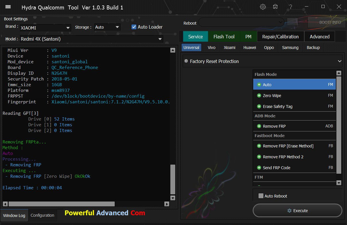

Xiaomi Redmi 4X (Santoni) FRP successfully removed by Hydra Tool
1. Run Hydra Qualcomm Module and choose "Sosc"
2. Select Brand and Module
3. Go to Service-->Universal
4. Choose "Factory Reset Protection" drop down menu
5. Choose "Auto" using Flash Mode.
6. Disassemble device and find the test point.
7. Execute and connect the device to the computer with data cable
8. Join two test points using twiser ro short them.
9. wait until the process is completed.
