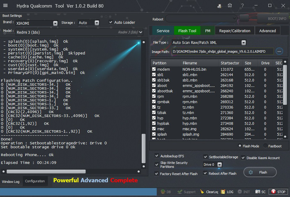

Xiaomi REdmi 3 (IDO) successfully Flashed by Hydra Tool
1. Run Hydra Qualcomm Tool
2. Go to "Flash Tool"
3. Click "Image Path" and choose correct "File Type"
4. Click on "Flash" button.
5. Connect Device with Computer using USB Data Cable
6. Just softly click on "Execute"
7. Wait until the flashing process is completed.
BRSearching for Qualcomm 9008 Device...Found
FriendlyName :Qualcomm HS-USB QDLoader 9008 (COM7)
SymbolicName :\??\USB#VID_05C6&PID_9008#6&276826cd&0&2#{a5dcbf10-6530-11d2-901f-00c04fb951ed}
Getting device info.....
Serial No.: 0x09030B10
MSM ID : 0x0090B0E1, MSM8939-Qualcomm Snapdragon 615
PBL Ver : 00000000
Firehose Loader[mi_0_1.mbn]
SaharaBoot... Ok
Sending .....Ok
Connecting to Firehose...
Ping... Ok
Configuration.......
Identifying Chip....
Ok
Chip Configuration :
MemoryName : eMMC
MaxXMLSizeInBytes : 4096
TargetName : 8936
Version : 1
Protocol : Universal
Running : Ok
Phone Information.....
Brand : Xiaomi
Vendor : Xiaomi
Model : Redmi 3
SDK : 22
Release : 5.1.1
ABI : arm64-v8a
Description : ido-user 5.1.1 LMY47V V7.2.1.0.LHPMIDB release-keys
Miui Ver : V7
Device : ido
Mod_device : ido_xhdpi_global
Board : msm8916
Display ID : LMY47V
Security Patch : 2016-02-01
Platform : msm8916
Fingerprint : Xiaomi/ido/ido:5.1.1/LMY47V/V7.2.1.0.LHPMIDB:user/release-keys
Reading GPT[3]
Drive [0] 32 Items
Drive [1] 0 Items
Drive [2] 0 Items
Backup Security partitions...
Reading Security Items....
> modemst1
> modemst2
> fsg
D:\Hydra Tool\Backup\Security_Backup\Redmi 3_msm8916_5.1.1_Security_042721091123.sec
Backup Security Success....
- modem(0)[NON-HLOS.bin] Ok
- sbl1(0)[sbl1.mbn] Ok
- sbl1bak(0)[sbl1.mbn] Ok
- rpm(0)[rpm.mbn] Ok
- rpmbak(0)[rpm.mbn] Ok
- tz(0)[tz.mbn] Ok
- tzbak(0)[tz.mbn] Ok
- hyp(0)[hyp.mbn] Ok
- hypbak(0)[hyp.mbn] Ok
- misc(0)[misc.img] Ok
- splash(0)[splash.img] Ok
- boot(0)[boot.img] Ok
- system(0)[system.img] Ok
- cache(0)[cache.img] Ok
- cust(0)[cust.img] Ok
0 [NUM_DISK_SECTORS-34.] OK
0 [NUM_DISK_SECTORS-1.] OK
0 [NUM_DISK_SECTORS-33.] OK
0 [CRC32(2,4096)] OK
0 [CRC32(NUM_DISK_SECTORS-33.,4096)] OK
0 [0] OK
0 [CRC32(1,92)] OK
0 [0] OK
Done!
Rebooting Phone.... Ok
Elapsed Time : 00:24:09
