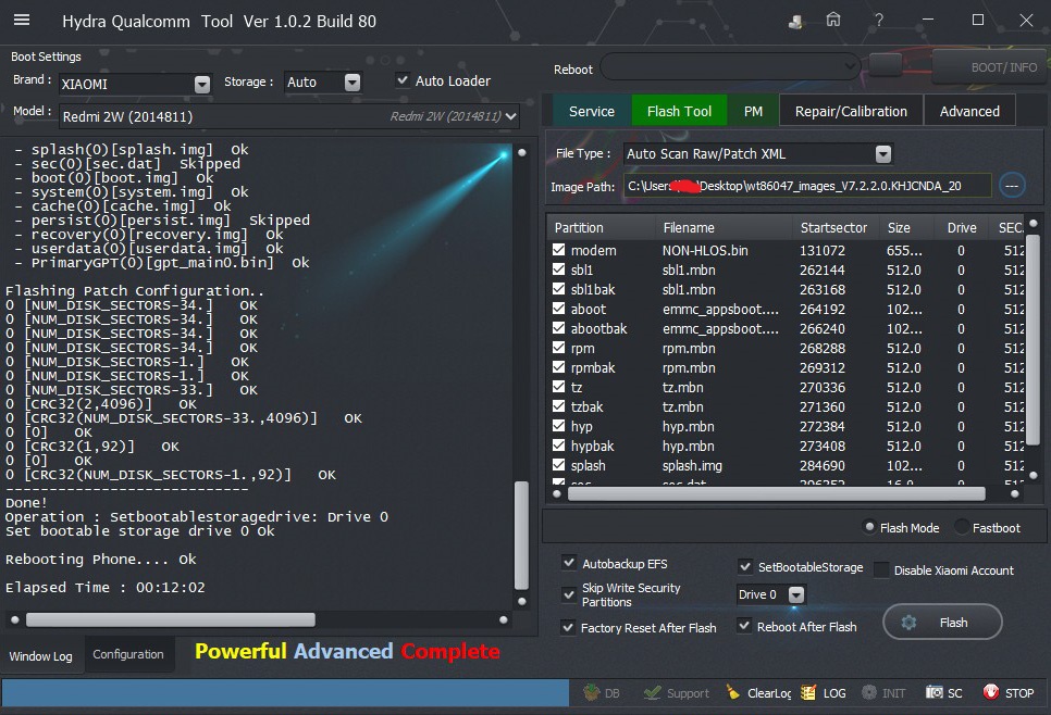

Hydra Xiaomi Redmi 2W (2014811) successfully flashed by Hydra Tool
546
1. Run Hydra Qualcomm Module and Sosc.
2. Choose Brand and Module.
3. Go to "Flash Tool" Tab.
4. Choose Flash file and its location.
5. Click on "Flash"
6. connect device to the computer with USB Data cable
7. Wait until the process is completed.
FriendlyName :Qualcomm HS-USB QDLoader 9008 (COM36)
SymbolicName :\??\USB#VID_05C6&PID_9008#5&7f9be32&0&1#{a5dcbf10-6530-11d2-901f-00c04fb951ed}
Getting device info.....
Serial No.: 0x093E0551
MSM ID : 0x007050E1, MSM8916-Qualcomm Snapdragon 410
PBL Ver : 00000000
PK HASH : CC3153A80293939B90D02D3BF8B23E02
92E452FEF662C74998421ADAD42A380F
Firehose Loader[8916.mbn]
SaharaBoot... Ok
Sending .....Ok
Connecting to Firehose...
Ping. Ok
Configuration........
Identifying Chip....
Ok
Chip Configuration :
MemoryName : eMMC
MaxXMLSizeInBytes : 4096
TargetName : 8916
Version : 1
Protocol : Universal
Running : Ok
Phone Information.....
Brand : Xiaomi
Vendor : Xiaomi
Model : wt88047
SDK : 22
Release : 5.1.1
ABI : armeabi-v7a
Description : wt88047-user 5.1.1 LMY47V V9.2.4.0.LHJMIEK release-keys
Miui Ver : V9
Device : wt88047
Mod_device : wt88047_pro_global
Board : msm8916
Display ID : LMY47V
Security Patch : 2017-01-01
Platform : msm8916
Fingerprint : Xiaomi/wt88047/wt88047:5.1.1/LMY47V/V9.2.4.0.LHJMIEK:user/release-keys
Reading GPT[3]
Drive [0] 32 Items
Drive [1] 0 Items
Drive [2] 0 Items
Backup Security partitions...
Reading Security Items....
> modemst1
> modemst2
> fsg
C:\Hydra Tool\Backup\Security_Backup\wt88047_msm8916_5.1.1_Security_050421105424.sec
Backup Security Success....
- modem(0)[NON-HLOS.bin] Ok
- sbl1(0)[sbl1.mbn] Ok
- sbl1bak(0)[sbl1.mbn] Ok
- rpm(0)[rpm.mbn] Ok
- rpmbak(0)[rpm.mbn] Ok
- tz(0)[tz.mbn] Ok
- tzbak(0)[tz.mbn] Ok
- hyp(0)[hyp.mbn] Ok
- hypbak(0)[hyp.mbn] Ok
- splash(0)[splash.img] Ok
- sec(0)[sec.dat] Skipped
- boot(0)[boot.img] Ok
- system(0)[system.img] Ok
- cache(0)[cache.img] Ok
0 [NUM_DISK_SECTORS-34.] OK
0 [NUM_DISK_SECTORS-1.] OK
0 [NUM_DISK_SECTORS-33.] OK
0 [CRC32(2,4096)] OK
0 [CRC32(NUM_DISK_SECTORS-33.,4096)] OK
0 [0] OK
0 [CRC32(1,92)] OK
0 [0] OK
Done!
Rebooting Phone.... Ok
Elapsed Time : 00:12:02
