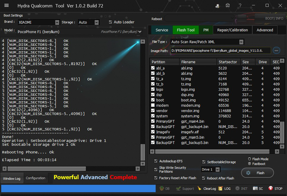

Hydra Xiaomi PocoPhone F1 successfully flashed by Hydra Tool
546
FriendlyName :Qualcomm HS-USB QDLoader 9008 (COM12)
SymbolicName :\??\USB#VID_05C6&PID_9008#5&376aba2d&0&4#{a5dcbf10-6530-11d2-901f-00c04fb951ed}
Getting device info..Ok
Device MODE : Firehose
Connecting to Firehose...
Ping..................... Ok
Configuration........
Identifying Chip........UFS
Ok
Chip Configuration :
MemoryName : UFS
MaxXMLSizeInBytes : 4096
TargetName :
Version : 1
DateTime : Oct 10 2018 - 22:42:48
*** STORAGE DEVICE INFO ***
Memory Type : UFS
Block Size in Bytes : 4096
Page Size : 4096
Manufacturer ID : 462
Serial Number : 1297306958
Firmware Version : 500
Product Name : KLUDG4U1EA-B0C1
Physical Partitions : 6
Total Logical Blocks:
Drive [0] 30038016[114.586 GB]
Drive [1] 2048[8 MB]
Drive [2] 2048[8 MB]
Drive [3] 8192[32 MB]
Drive [4] 1179648[4.5 GB]
Drive [5] 8192[32 MB]
Protocol : Universal
Running : Ok
Phone Information......
Vendor : Xiaomi
SDK : 29
Release : 10
ABI : arm64-v8a
Locale : en-GB
Miui Ver : V11
Mod_device : beryllium_global
Security Patch : 2020-06-01
Reading GPT[6]
Drive [0] 32 Items
Drive [1] 32 Items
Drive [2] 32 Items
Drive [3] 32 Items
Drive [4] 64 Items
Drive [5] 32 Items
Backup Security partitions...
Reading Security Items....
> modemst1
> modemst2
> fsg
C:\Hydra Tool\Backup\Security_Backup\__10_Security_032921183754.sec
Backup Security Success....
- switch(0)[dummy.img] Ok
- misc(0)[misc.img] Ok
- logfs(0)[logfs_ufs_8mb.bin] Ok
- cust(0)[cust.img] Ok
- cache(0)[cache.img] Ok
- xbl_config_a(1)[xbl_config.img] Ok
- xbl_a(1)[xbl.img] Ok
- PrimaryGPT(1)[gpt_main1.bin] Ok
- xbl_config_b(2)[xbl_config.img] Ok
- xbl_b(2)[xbl.img] Ok
- PrimaryGPT(2)[gpt_main2.bin] Ok
- PrimaryGPT(3)[gpt_main3.bin] Ok
- limits(4)[dummy.img] Ok
- qupfw_a(4)[qupfw.img] Ok
- qupfw_b(4)[qupfw.img] Ok
- storsec_a(4)[storsec.img] Ok
- storsec_b(4)[storsec.img] Ok
- devcfg_a(4)[devcfg.img] Ok
- devcfg_b(4)[devcfg.img] Ok
- aop_a(4)[aop.img] Ok
- aop_b(4)[aop.img] Ok
- cmnlib_a(4)[cmnlib.img] Ok
- cmnlib_b(4)[cmnlib.img] Ok
- cmnlib64_a(4)[cmnlib64.img] Ok
- cmnlib64_b(4)[cmnlib64.img] Ok
- keymaster_a(4)[keymaster.img] Ok
- keymaster_b(4)[keymaster.img] Ok
- bluetooth(4)[bluetooth.img] Ok
- hyp_a(4)[hyp.img] Ok
- hyp_b(4)[hyp.img] Ok
- abl_a(4)[abl.img] Ok
- abl_b(4)[abl.img] Ok
- tz_a(4)[tz.img] Ok
- tz_b(4)[tz.img] Ok
- logo(4)[logo.img] Ok
- dsp(4)[dsp.img] Ok
- boot(4)[boot.img] Ok
- vendor(4)[vendor.img] Ok
- system(4)[system.img] Ok
- PrimaryGPT(4)[gpt_main4.bin] Ok
- ImageFv(5)[imagefv.elf] Ok
- PrimaryGPT(5)[gpt_main5.bin] Ok
0 [NUM_DISK_SECTORS-6.] OK
0 [NUM_DISK_SECTORS-1.] OK
0 [NUM_DISK_SECTORS-5.] OK
0 [CRC32(2,4096)] OK
0 [CRC32(NUM_DISK_SECTORS-5.,4096)] OK
0 [0] OK
0 [CRC32(1,92)] OK
0 [0] OK
1 [NUM_DISK_SECTORS-6.] OK
1 [NUM_DISK_SECTORS-1.] OK
1 [NUM_DISK_SECTORS-5.] OK
1 [CRC32(2,4096)] OK
1 [CRC32(NUM_DISK_SECTORS-5.,4096)] OK
1 [0] OK
1 [CRC32(1,92)] OK
1 [0] OK
1 [CRC32(NUM_DISK_SECTORS-1.,92)] OK
2 [NUM_DISK_SECTORS-6.] OK
2 [NUM_DISK_SECTORS-1.] OK
2 [NUM_DISK_SECTORS-5.] OK
2 [CRC32(2,4096)] OK
2 [CRC32(NUM_DISK_SECTORS-5.,4096)] OK
2 [0] OK
2 [CRC32(1,92)] OK
2 [0] OK
2 [CRC32(NUM_DISK_SECTORS-1.,92)] OK
3 [NUM_DISK_SECTORS-6.] OK
3 [NUM_DISK_SECTORS-1.] OK
3 [NUM_DISK_SECTORS-5.] OK
3 [CRC32(2,4096)] OK
3 [CRC32(NUM_DISK_SECTORS-5.,4096)] OK
3 [0] OK
3 [CRC32(1,92)] OK
3 [0] OK
3 [CRC32(NUM_DISK_SECTORS-1.,92)] OK
4 [NUM_DISK_SECTORS-6.] OK
4 [NUM_DISK_SECTORS-1.] OK
4 [NUM_DISK_SECTORS-5.] OK
4 [CRC32(2,8192)] OK
4 [CRC32(NUM_DISK_SECTORS-5.,8192)] OK
4 [0] OK
4 [CRC32(1,92)] OK
4 [0] OK
4 [CRC32(NUM_DISK_SECTORS-1.,92)] OK
5 [NUM_DISK_SECTORS-6.] OK
5 [NUM_DISK_SECTORS-1.] OK
5 [NUM_DISK_SECTORS-5.] OK
5 [CRC32(2,4096)] OK
5 [CRC32(NUM_DISK_SECTORS-5.,4096)] OK
5 [0] OK
5 [CRC32(1,92)] OK
5 [0] OK
5 [CRC32(NUM_DISK_SECTORS-1.,92)] OK
Done!
Operation : Setbootablestoragedrive: Drive 1
Set bootable storage drive 1 Ok
Rebooting Phone.... Ok
Elapsed Time : 00:03:14
