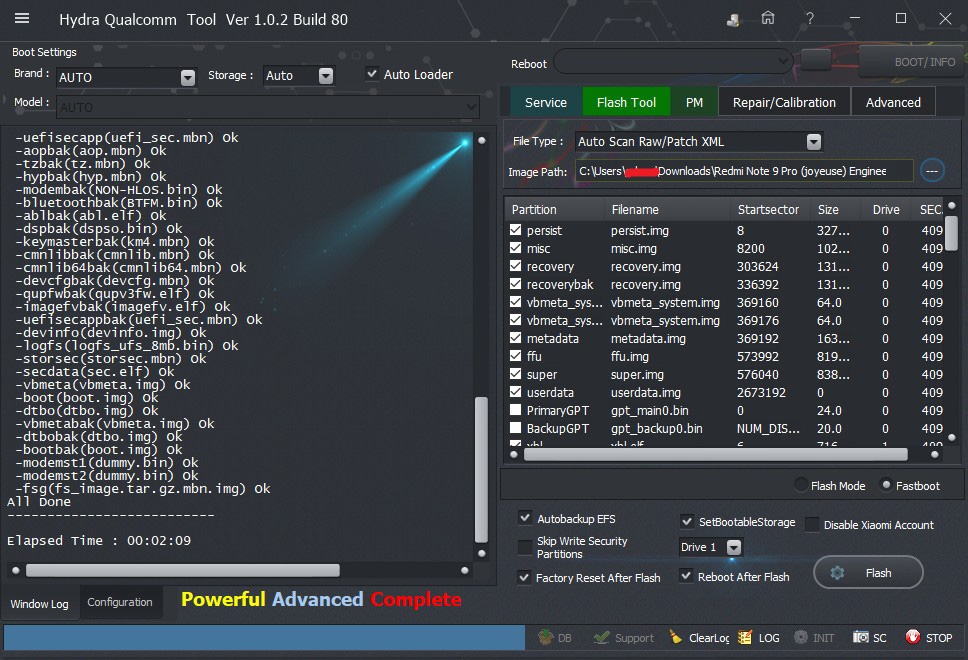

Xiaomi Note 9 Pro (Joyeuse) successfully flashed by Hydra Tool
1. Run Hydra Qualcomm Module and Sosc.
2. Choose Brand and Module or leave it as "Auto"
3. Go to "Flash Tool" Tab.
4. Choose Flash file and its location.
5. Click on "Flash"
6. connect device to the computer with USB Data cable
7. Wait until the process is completed.
5. Click on "Flash"
BRSearching Device By Fastboot
Device Found...
Reading Information...getvar:version FAILED (remote: GetVar Variable Not found)
Product : joyeuse
version : getvar:version FAILED (remote: GetVar Variable Not found)
Secure : yes
Device Info:
Verity mode: true
Device unlocked: false
Device critical unlocked: false
Charger screen enabled: false
Fastboot Flashing...
-persist(persist.img) Ok
-misc(misc.img) Ok
-recovery(recovery.img) Ok
-recoverybak(recovery.img) Ok
-vbmeta_system(vbmeta_system.img) Ok
-vbmeta_systembak(vbmeta_system.img) Ok
-metadata(metadata.img) Ok
-ffu(ffu.img) Ok
-super(super.img) Ok
-userdata(userdata.img) Ok
-xbl(xbl.elf) Ok
-xbl_config(xbl_config.elf) Ok
-xblbak(xbl.elf) Ok
-xbl_configbak(xbl_config.elf) Ok
-aop(aop.mbn) Ok
-tz(tz.mbn) Ok
-hyp(hyp.mbn) Ok
-modem(NON-HLOS.bin) Ok
-bluetooth(BTFM.bin) Ok
-abl(abl.elf) Ok
-dsp(dspso.bin) Ok
-keymaster(km4.mbn) Ok
-cmnlib(cmnlib.mbn) Ok
-cmnlib64(cmnlib64.mbn) Ok
-devcfg(devcfg.mbn) Ok
-qupfw(qupv3fw.elf) Ok
-imagefv(imagefv.elf) Ok
-uefisecapp(uefi_sec.mbn) Ok
-aopbak(aop.mbn) Ok
-tzbak(tz.mbn) Ok
-hypbak(hyp.mbn) Ok
-modembak(NON-HLOS.bin) Ok
-bluetoothbak(BTFM.bin) Ok
-ablbak(abl.elf) Ok
-dspbak(dspso.bin) Ok
-keymasterbak(km4.mbn) Ok
-cmnlibbak(cmnlib.mbn) Ok
-cmnlib64bak(cmnlib64.mbn) Ok
-devcfgbak(devcfg.mbn) Ok
-qupfwbak(qupv3fw.elf) Ok
-imagefvbak(imagefv.elf) Ok
-uefisecappbak(uefi_sec.mbn) Ok
-devinfo(devinfo.img) Ok
-logfs(logfs_ufs_8mb.bin) Ok
-storsec(storsec.mbn) Ok
-secdata(sec.elf) Ok
-vbmeta(vbmeta.img) Ok
-boot(boot.img) Ok
-dtbo(dtbo.img) Ok
-vbmetabak(vbmeta.img) Ok
-dtbobak(dtbo.img) Ok
-bootbak(boot.img) Ok
-modemst1(dummy.bin) Ok
-modemst2(dummy.bin) Ok
-fsg(fs_image.tar.gz.mbn.img) Ok
All Done
Elapsed Time : 00:02:09
