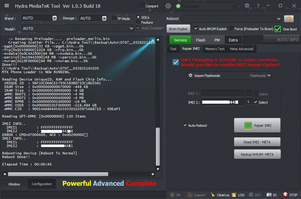

Xiaomi MTK Device's IMEI Repair Successfully Done by Hydra Tool
***IMEI REPAIR FUNCTION****
Xiaomi Flashmode
FriendlyName :MediaTek USB Port (COM115)
SymbolicName :\??\USB#VID_0E8D&PID_0003#00000070#{a5dcbf10-6530-11d2-901f-00c04fb951ed}
Driver Ver :01/22/2016,3.2
Handshaking...Ok
Identifying Hardware ID.....
BROM CPUID : 0707MT6768[6768]
getMTKPayloadExploit : 0707
#Executing Exploit..
#SUCCESS..
Handshaking...Ok
FUSEID : 00000000
SECURE VERSION : 00
BL VERSION : FE
BR Secured : E0
Preparing Download Agent..
DA : 6768.bin
Ver : MTK_AllInOne_DA_v3.3001.2020/07/07.10:10_513994
Init : Loader [1]
Sending : Accepted
Identifying Protocol...
Protocol : New
Synchronization...SYNC
Mode : brom
Preloader Initialization...
Parsing preloader_merlin.bin
Init : Accepted
Execute Secondary Loader
Init : Loader [2]
Executing : SYNC
UNIQUE ID : 96F32CD0ACE5793C5B9BD732C1BE0341
eMMC USER : 0x0000001D1F000000 -116,484 GB
eMMC CID : 90014A6844456150330310397566871D - hDEaP3
DA Speed : high-speed
Autobackup Partitions
-> Renaming Preloader.... preloader_merlin.bin
Creating Scatter file... C:\Hydra Tool\\Backup\Auto\0707____1141020\MT6768_Android_scatter.txt
-frp[0x05508000]1024 KB ->frp.bin...Ok
-nvdata[0x0C4A2000]64 MB ->nvdata.bin...Ok
-persist[0x104A2000]48 MB ->persist.bin...Ok
-nvram[0x19F00000]64 MB ->nvram.bin...Ok
Done!!!
IMEI INFO..
IMEI1 : FFFFFFFFFFFFFFF
IMEI2 : *************41*6
ERROR : CMD=07000400, ACK : 0x00200000[]
IMEI INFO..
IMEI2 : *************44*1
Reboot Done!!
Elapsed Time : 00:00:46

SIM1 not work!!! not dial, not incoming call. This not repair xiaomi phone, this solution which can be done without hydra!
Hi, the imei repair when it is dual sim repairs and the sim2 or imei2 works and of course you have to put the original imei, if for any reason the original imei or imeis are blacklisted for any reason, you must communicate it to the client and if it repairs perfectly, you have to have clear concepts and how the software should be used according to what operations to do, you are supposed to be a technician and you should know it, greetings.

Hi!
I think it was fair to point this out in the description of the dongle and its updates. After all, when buying a product, I am sure from the description that I can restore the phone. But this procedure has nothing to do with real recovery. This is just a solution to allow the phone to work on a single SIM. And this can be done without buying this dongle.
