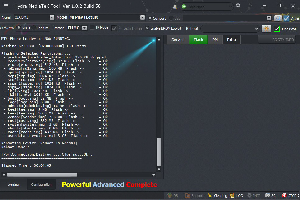

Brand : XIAOMI Model : Mi Play (Lotus) Connection : Flash Mode
How To Boot : Power off phone
* BROM Mode : Press VOL +
Connection
-Please wait...
-Found...[COM14]
TPortConnection.Create...(COM14)..Opening...Ok
Handshaking...Ok
Identifying Hardware ID.....
BROM CPUID : 0766 (0000)MT6765[6765]
#Executing Exploit..
#SUCCESS..
Handshaking...Ok
FUSEID : 00000000
SECURE VERSION : 05
BL VERSION : FE
BR Secured : E0
Preparing Download Agent..
DA : 6765_SWSEC_56EC405E9E.bin
Ver : MTK_AllInOne_DA_v3.3001.2018/04/19.10:40_426269
Init : Loader [1]
Sending : Accepted
Identifying Protocol...
Protocol : New
Synchronization...[ERROR]- NOT SYNC
Reasons why it fails due to the following"
1. Harware problem/issues
2. If you did Testpoint Kindly check the parts you Touch/TP
3. Powershortage, try to connect Battery
4. Check or replace usb cable and plug directly to your pc usb port.
Mode : brom
Preloader Initialization...
Parsing preloader_lotus.bin
Init : Accepted
Execute Secondary Loader
Init : Loader [2]
Executing : SYNC
UNIQUE ID : 95F23BABE09564DF192742573448F6C9
IRAM Size : 0x0000000030000000 -768 MB
eMMC CID : 90014A68433861503E0349CB4D352663 - hC8aP>
DA Speed : high-speed
Reading System Info
Brand : xiaomi
Vendor : alps
Model : lotus
SDK : 27
Release : 8.1.0
ABI : arm64-v8a
Locale : en-US
Description : lotus-userdebug 8.1.0 O11019 1548249244 test-keys
Device : lotus
Display ID : ZAL1722-Lotus-V33-O-0123
Security Patch : 2018-10-05
Fingerprint : xiaomi/lotus/lotus:8.1.0/O11019/1548249244:userdebug/test-keys
StorageType : mtp
Userdata State : Encrypted
Autobackup Partitions
-> Renaming Preloader.... preloader_lotus.bin
Creating Scatter file... C:\Hydra Tool\\Backup\Auto\xiaomi_lotus_0766--8.1.0_ZAL1722-Lotus-V33-O-0123_270121005508\MT6765_Android_scatter.txt
-frp[0x03588000]1024 KB ->frp.bin...Ok
-nvdata[0x05688000]64 MB ->nvdata.bin...Ok
-persist[0x0D000000]48 MB ->persist.bin...Ok
-nvram[0x18E80000]64 MB ->nvram.bin...Ok
Done!!!
- preloader[preloader_lotus.bin] 256 KB Skipped
- recovery[recovery.img] 32 MB Flash -> = Ok
- efuse[efuse.img] 512 KB Flash -> = Ok
- md1img[md1img.img] 100 MB Flash -> = Ok
- spmfw[spmfw.img] 1024 KB Flash -> = Ok
- scp1[scp.img] 1024 KB Flash -> = Ok
- scp2[scp.img] 1024 KB Flash -> = Ok
- sspm_1[sspm.img] 1024 KB Flash -> = Ok
- sspm_2[sspm.img] 1024 KB Flash -> = Ok
- lk[lk.img] 1024 KB Flash -> = Ok
- lk2[lk.img] 1024 KB Flash -> = Ok
- boot[boot.img] 32 MB Flash -> = Ok
- logo[logo.bin] 8 MB Flash -> = Ok
- odmdtbo[odmdtbo.img] 16 MB Flash -> = Ok
- tee1[tee.img] 5 MB Flash -> = Ok
- tee2[tee.img] 10.5 MB Flash -> = Ok
- vendor[vendor.img] 768 MB Flash -> = Ok
- cust[cust.img] 832 MB Flash -> = Ok
- system[system.img] 3 GB Flash -> = Ok
- vbmeta[vbmeta.img] 8 MB Flash -> = Ok
- cache[cache.img] 432 MB Flash -> = Ok
- userdata[userdata.img] 3 GB Flash -> = Ok
Reboot Done!!
Elapsed Time : 00:04:05
