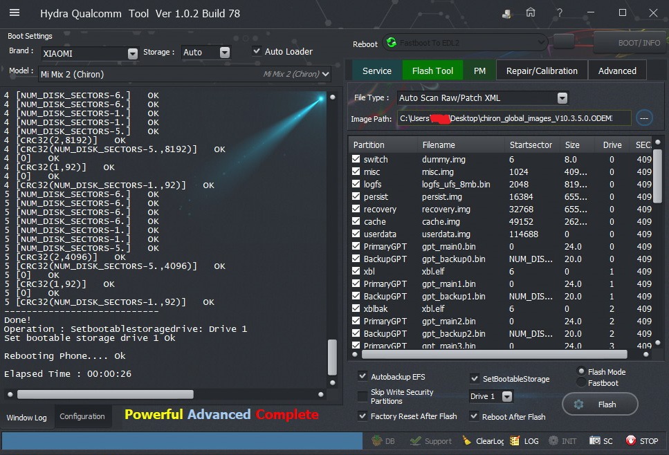

Hydra Xiaomi Mi Mix 2 Chiron successfully flashed by Hydra too
546
Xiaomi Mi Mix 2 Chiron successfully flashed by Hydra tool
FriendlyName :Qualcomm HS-USB QDLoader 9008 (COM6)
SymbolicName :\??\USB#VID_05C6&PID_9008#6&391a810&0&3#{a5dcbf10-6530-11d2-901f-00c04fb951ed}
Driver Ver :03/21/2018,2.1.3.1
Getting device info......
Serial No.: 0x5F7CDDAA
MSM ID : 0x0005E0E1, MSM8998-Qualcomm Snapdragon 835
PBL Ver : 00000000
PK HASH : A7B8B82545A98ECA23D6E9105FB46456
8D1B5828264903441BDEF0CD57E3C370
Firehose Loader[mi_1_3.elf]
SaharaBoot... Ok
Sending ..............................Ok
Connecting to Firehose...
Ping.......... Ok
Configuration......
Identifying Chip.......UFS
Ok
Chip Configuration :
MemoryName : UFS
MaxXMLSizeInBytes : 4096
TargetName : MSM8996
Version : 1
DateTime : Aug 1 2017 - 21:30:16
*** STORAGE DEVICE INFO ***
Memory Type : UFS
Block Size in Bytes : 4096
Page Size : 4096
Manufacturer ID : 462
Serial Number : 1297306958
Firmware Version : 100
Product Name : KLUDG4U1EA-B0C1
Physical Partitions : 6
Total Logical Blocks:
Drive [0] 29513728[112.586 GB]
Drive [1] 2048[8 MB]
Drive [2] 2048[8 MB]
Drive [3] 32768[128 MB]
Drive [4] 1654784[6.313 GB]
Drive [5] 32768[128 MB]
Protocol : Universal
Running : Ok
Phone Information.....
Brand : Xiaomi
Vendor : Xiaomi
Model : Mi MIX 2
SDK : 26
Release : 8.0.0
ABI : arm64-v8a
Locale : en-GB
Description : chiron-user 8.0.0 OPR1.170623.027 V10.3.5.0.ODEMIXM release-keys
Miui Ver : V10
Device : chiron
Mod_device : chiron_global
Board : msm8998
Display ID : OPR1.170623.027
Security Patch : 2019-03-01
Platform : msm8998
FRPPST : /dev/block/bootdevice/by-name/frp
Fingerprint : Xiaomi/chiron/chiron:8.0.0/OPR1.170623.027/V10.3.5.0.ODEMIXM:user/release-keys
Reading GPT[6]
Drive [0] 32 Items
Drive [1] 32 Items
Drive [2] 32 Items
Drive [3] 32 Items
Drive [4] 64 Items
Drive [5] 32 Items
Backup Security partitions...
Reading Security Items....
> modemst1
> modemst2
> fsg
C:\HydraTool\Backup\Security_Backup\Mi MIX 2_msm8998_8.0.0_Security_040921125226.sec
Backup Security Success....
- switch(0)[dummy.img] Ok
- misc(0)[misc.img] Ok
- logfs(0)[logfs_ufs_8mb.bin] Ok
- persist(0)[persist.img] Ok
- cache(0)[cache.img] Ok
- xbl(1)[xbl.elf] Ok
- PrimaryGPT(1)[gpt_main1.bin] Ok
- xblbak(2)[xbl.elf] Ok
- PrimaryGPT(2)[gpt_main2.bin] Ok
- PrimaryGPT(3)[gpt_main3.bin] Ok
- limits(4)[dummy.img] Ok
- devcfg(4)[devcfg.mbn] Ok
- devcfgbak(4)[devcfg.mbn] Ok
- pmic(4)[pmic.elf] Ok
- pmicbak(4)[pmic.elf] Ok
- rpm(4)[rpm.mbn] Ok
- rpmbak(4)[rpm.mbn] Ok
- hyp(4)[hyp.mbn] Ok
- hypbak(4)[hyp.mbn] Ok
- tz(4)[tz.mbn] Ok
- tzbak(4)[tz.mbn] Ok
- keymaster(4)[keymaster.mbn] Ok
- keymasterbak(4)[keymaster.mbn] Ok
- cmnlib(4)[cmnlib.mbn] Ok
- cmnlibbak(4)[cmnlib.mbn] Ok
- cmnlib64(4)[cmnlib64.mbn] Ok
- cmnlib64bak(4)[cmnlib64.mbn] Ok
- abl(4)[abl.elf] Ok
- ablbak(4)[abl.elf] Ok
- storsec(4)[storsec.mbn] Ok
- storsecbak(4)[storsec.mbn] Ok
- bluetooth(4)[BTFM.bin] Ok
- logo(4)[logo.img] Ok
- dsp(4)[adspso.bin] Ok
- splash(4)[splash.img] Ok
- modem(4)[NON-HLOS.bin] Ok
- PrimaryGPT(4)[gpt_main4.bin] Ok
- PrimaryGPT(5)[gpt_main5.bin] Ok
0 [NUM_DISK_SECTORS-6.] OK
0 [NUM_DISK_SECTORS-1.] OK
0 [NUM_DISK_SECTORS-5.] OK
0 [CRC32(2,4096)] OK
0 [CRC32(NUM_DISK_SECTORS-5.,4096)] OK
0 [0] OK
0 [CRC32(1,92)] OK
0 [0] OK
1 [NUM_DISK_SECTORS-6.] OK
1 [NUM_DISK_SECTORS-1.] OK
1 [NUM_DISK_SECTORS-5.] OK
1 [CRC32(2,4096)] OK
1 [CRC32(NUM_DISK_SECTORS-5.,4096)] OK
1 [0] OK
1 [CRC32(1,92)] OK
1 [0] OK
1 [CRC32(NUM_DISK_SECTORS-1.,92)] OK
2 [NUM_DISK_SECTORS-6.] OK
2 [NUM_DISK_SECTORS-1.] OK
2 [NUM_DISK_SECTORS-5.] OK
2 [CRC32(2,4096)] OK
2 [CRC32(NUM_DISK_SECTORS-5.,4096)] OK
2 [0] OK
2 [CRC32(1,92)] OK
2 [0] OK
2 [CRC32(NUM_DISK_SECTORS-1.,92)] OK
3 [NUM_DISK_SECTORS-6.] OK
3 [NUM_DISK_SECTORS-1.] OK
3 [NUM_DISK_SECTORS-5.] OK
3 [CRC32(2,4096)] OK
3 [CRC32(NUM_DISK_SECTORS-5.,4096)] OK
3 [0] OK
3 [CRC32(1,92)] OK
3 [0] OK
3 [CRC32(NUM_DISK_SECTORS-1.,92)] OK
4 [NUM_DISK_SECTORS-6.] OK
4 [NUM_DISK_SECTORS-1.] OK
4 [NUM_DISK_SECTORS-5.] OK
4 [CRC32(2,8192)] OK
4 [CRC32(NUM_DISK_SECTORS-5.,8192)] OK
4 [0] OK
4 [CRC32(1,92)] OK
4 [0] OK
4 [CRC32(NUM_DISK_SECTORS-1.,92)] OK
5 [NUM_DISK_SECTORS-6.] OK
5 [NUM_DISK_SECTORS-1.] OK
5 [NUM_DISK_SECTORS-5.] OK
5 [CRC32(2,4096)] OK
5 [CRC32(NUM_DISK_SECTORS-5.,4096)] OK
5 [0] OK
5 [CRC32(1,92)] OK
5 [0] OK
5 [CRC32(NUM_DISK_SECTORS-1.,92)] OK
Done!
Operation : Setbootablestoragedrive: Drive 1
Set bootable storage drive 1 Ok
Rebooting Phone.... Ok
Elapsed Time : 00:00:26
